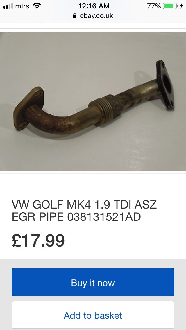

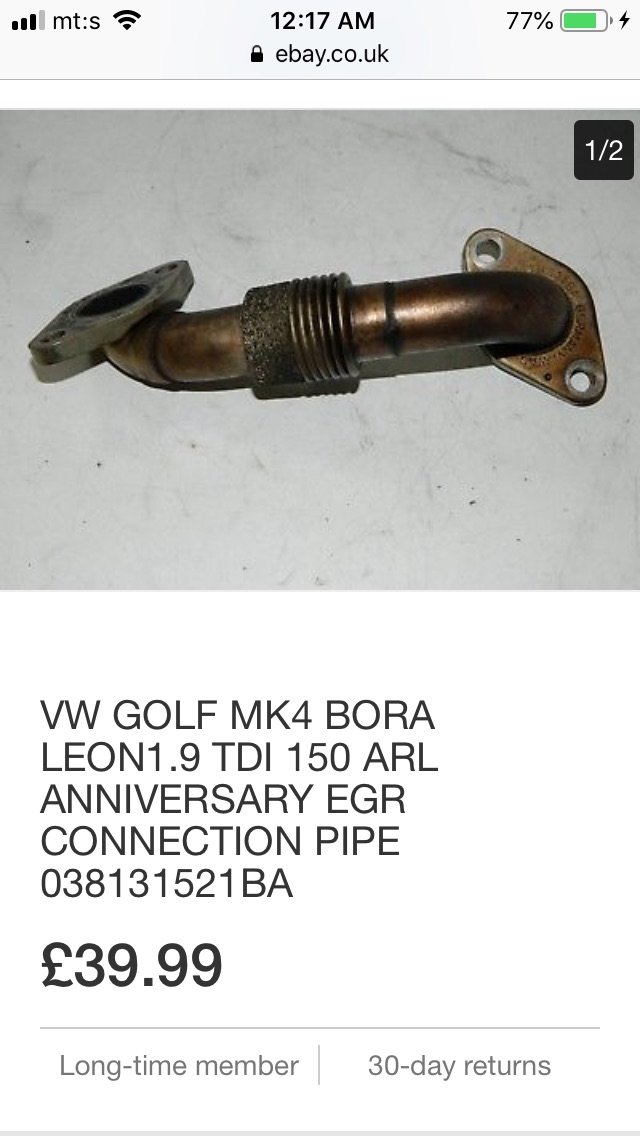

So the EGR pipe is an issue...  Maybe an ARL pipe would fix the problem.... Strange no one mentioned that....

Easiest thing would be to put a pd150 turbo on blank the egr valve off and when you get it mapped get them to map out the egr so the EML won't be on.
