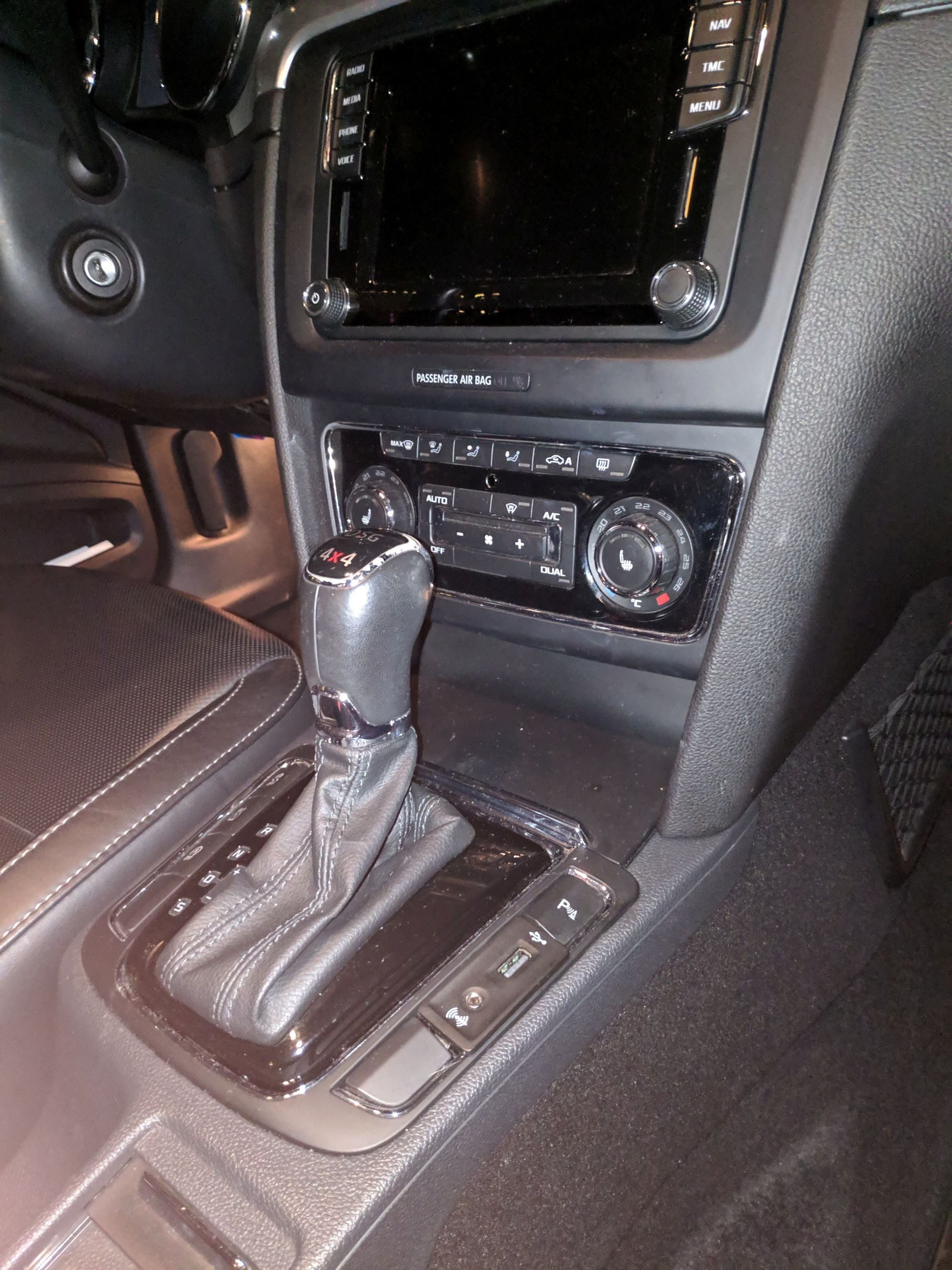

  • I need to plug my phone in to use Android Auto - so I need to mount a USB socket in the cabin somewhere to avoid a trailing cable. I am looking at mounting it in one of the blanking plates next to the gear stick... has anyone done this before?

Hi,
It works like you wish, I've got it setup.
oooo - where did you get that from?
From pab567 I have Amundsen MIB STD2 PQ ( 5L0035680E ) with that usb / 3.5 jack socket ( 5Q0035726 / 5Q0035724 )
Yeah - okay. Not sure those are going to work. I need it to terminate as USB A, and the audio would need to terminate as RCA...
