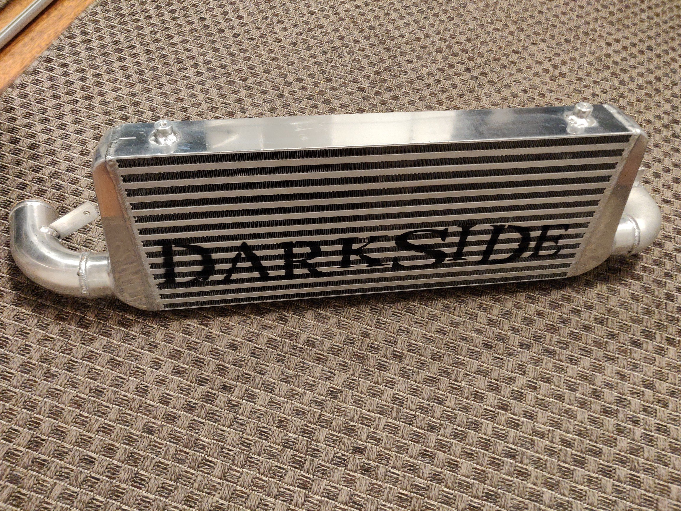

New IC, its going to get Techline tltd coating (Black)

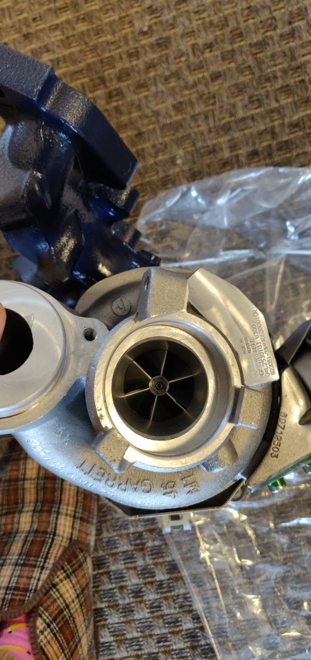

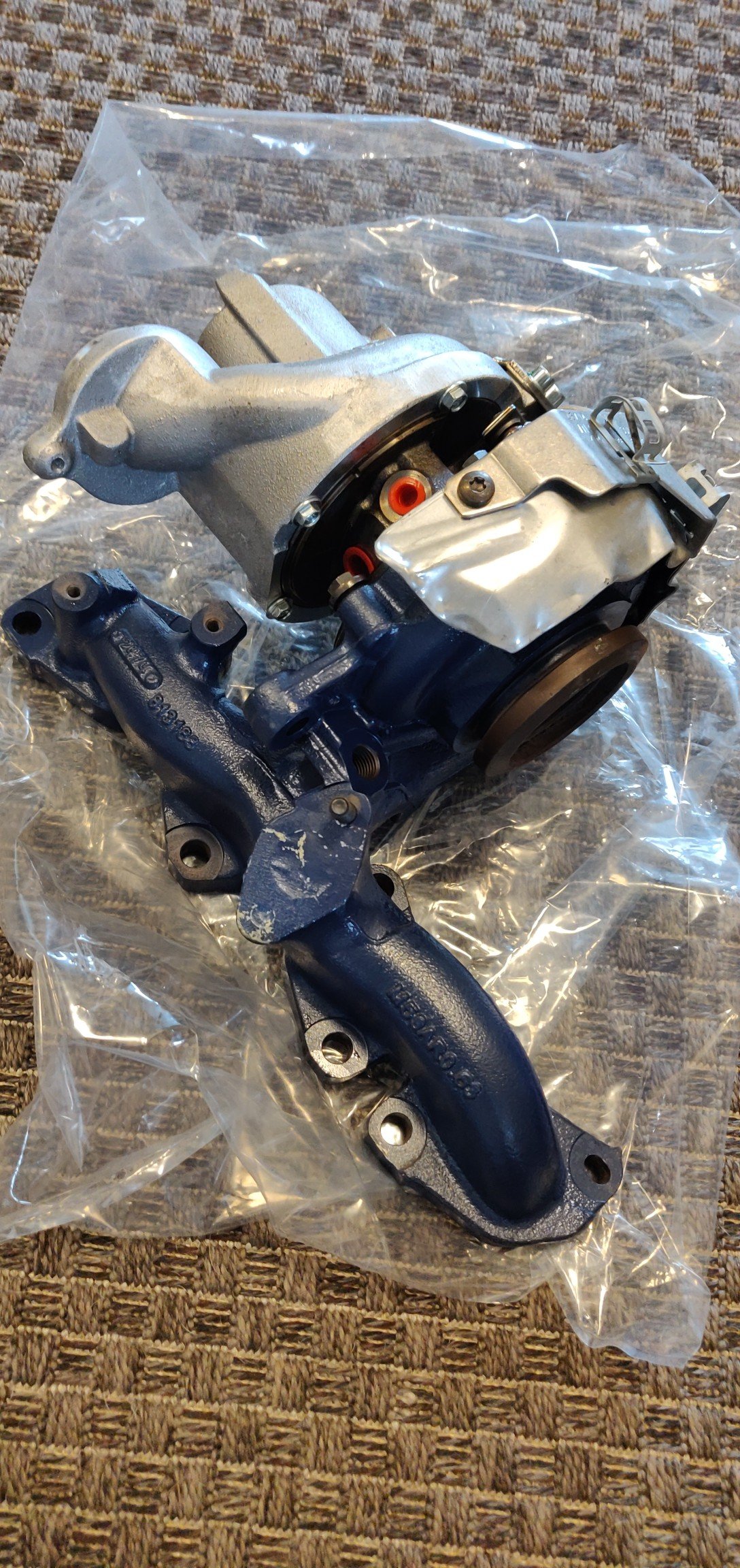

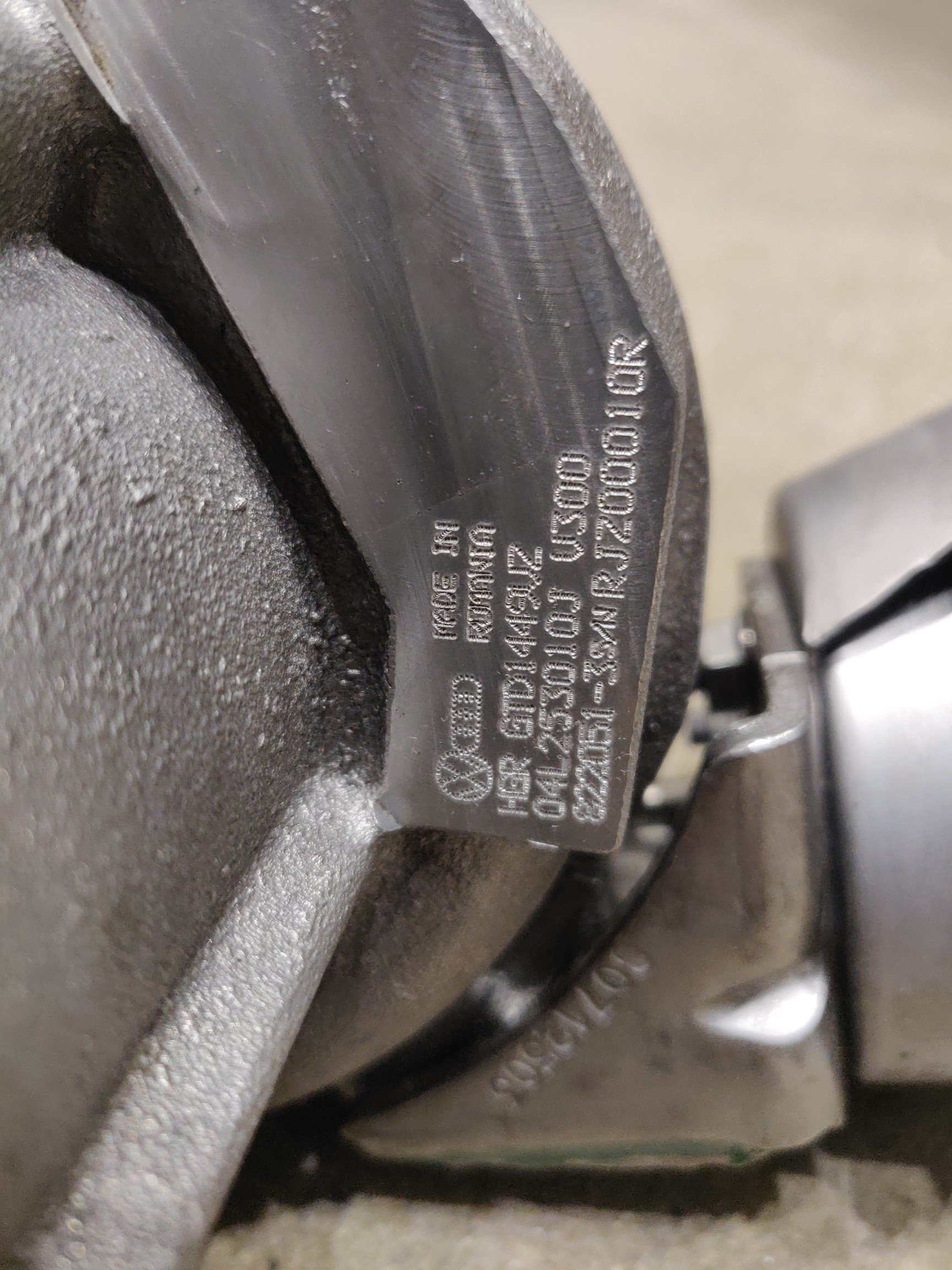

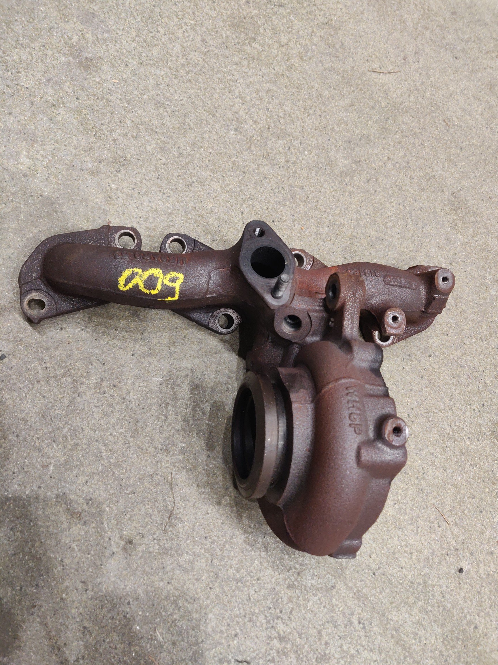

New (used) Garret gtd1449vz turbo. Manifold/housing also gets Techline turbo Blue coating.
Have fun fitting that intercooler :D
the brackets don’t match up to anything and did you not get the hardpipe kit?
Thanks :D
Not yet. Ill have to decide betweed custom or hardpipe kit.

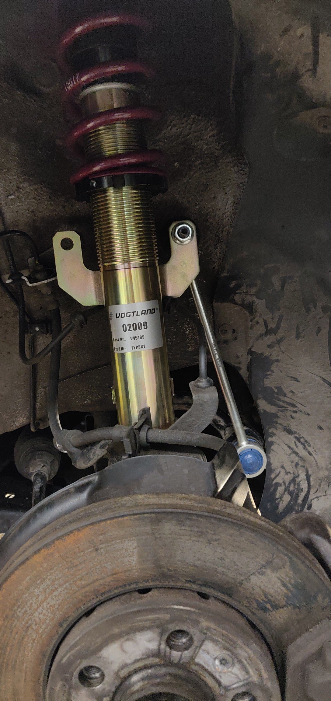

Next Im going to install Xenon lights, Vogtland coilovers+mk1 Mondeo HD swaybar links.

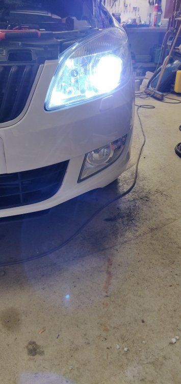

And more mods..

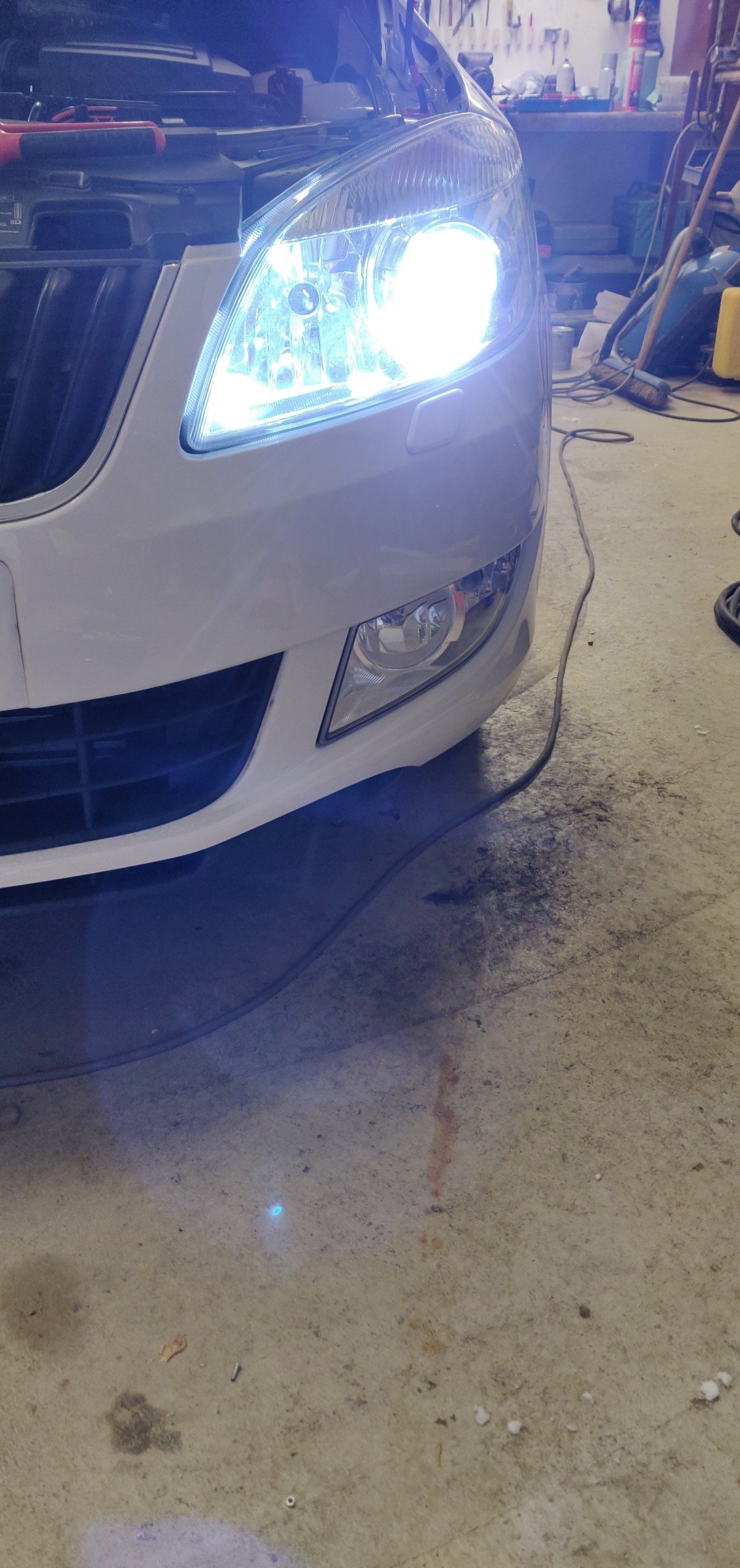

Xenon 6000k kit

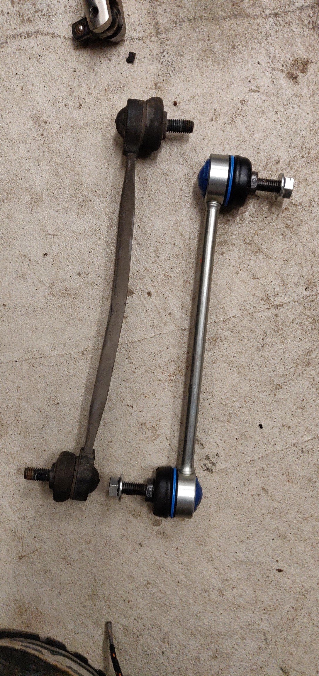

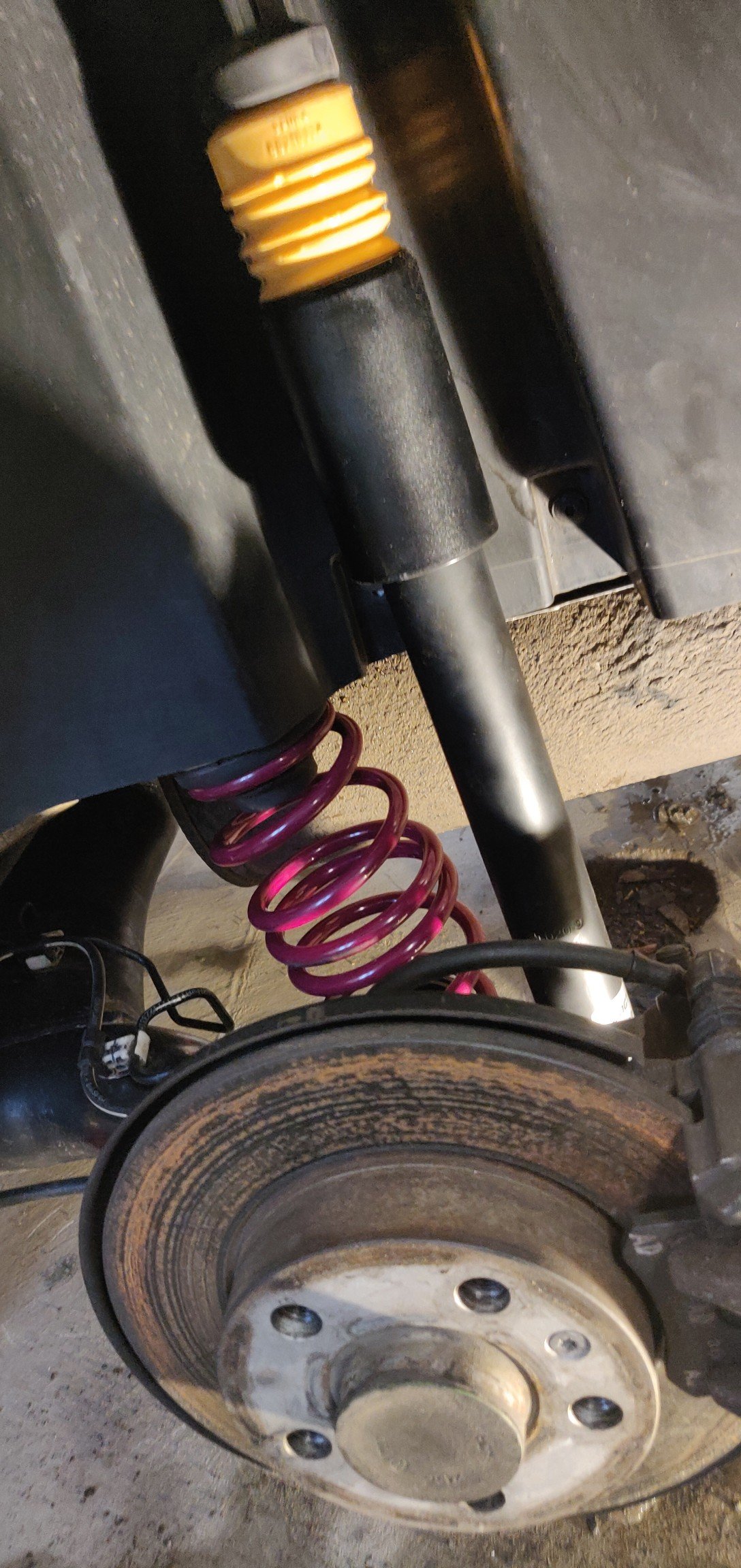

Vogtland coilovers + Meyle HD Mondeo mk1 swaybarlinks.

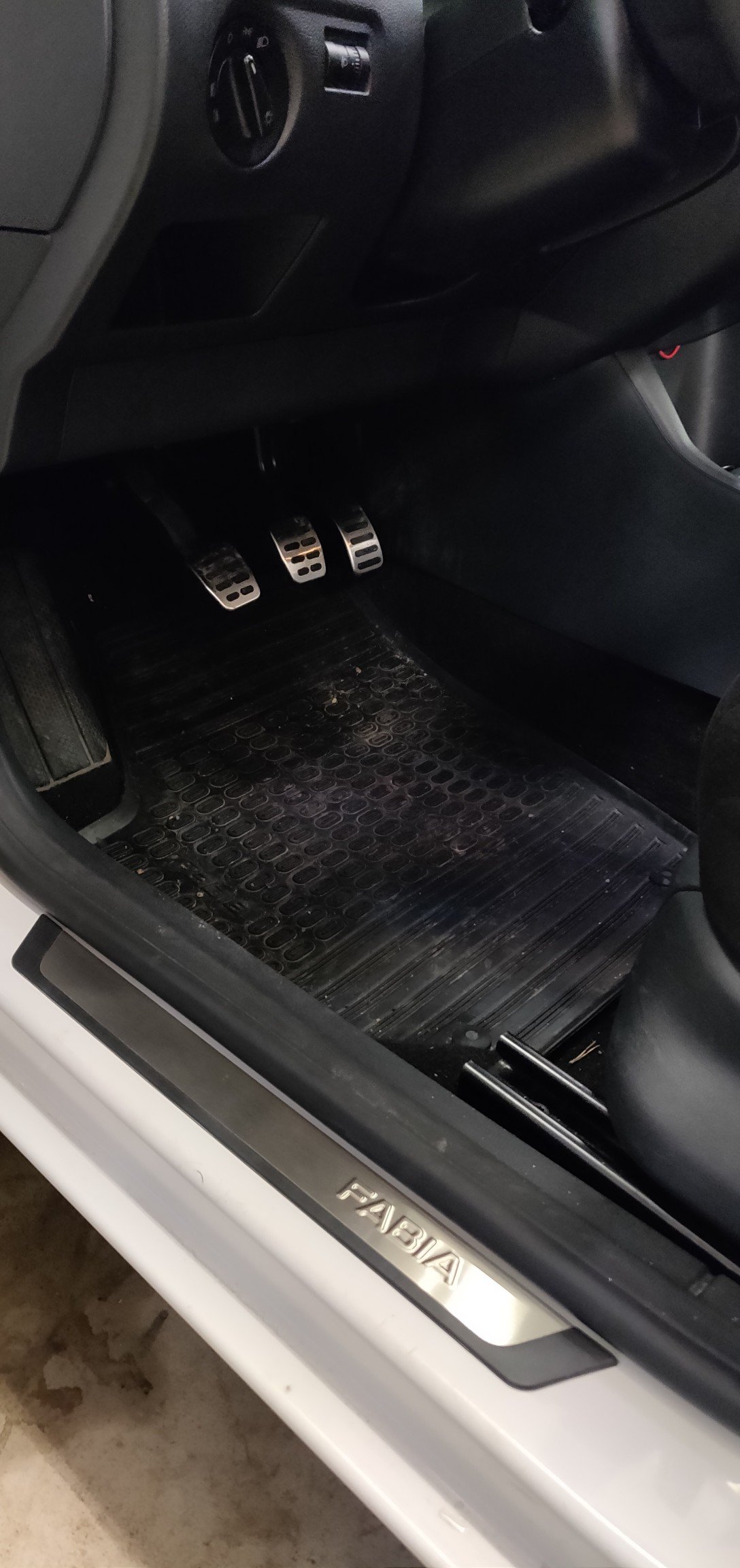

New pedals+door sills.
I got a set of Octavia vRS ones thinking they would fit but they wouldn't :sadsmile:

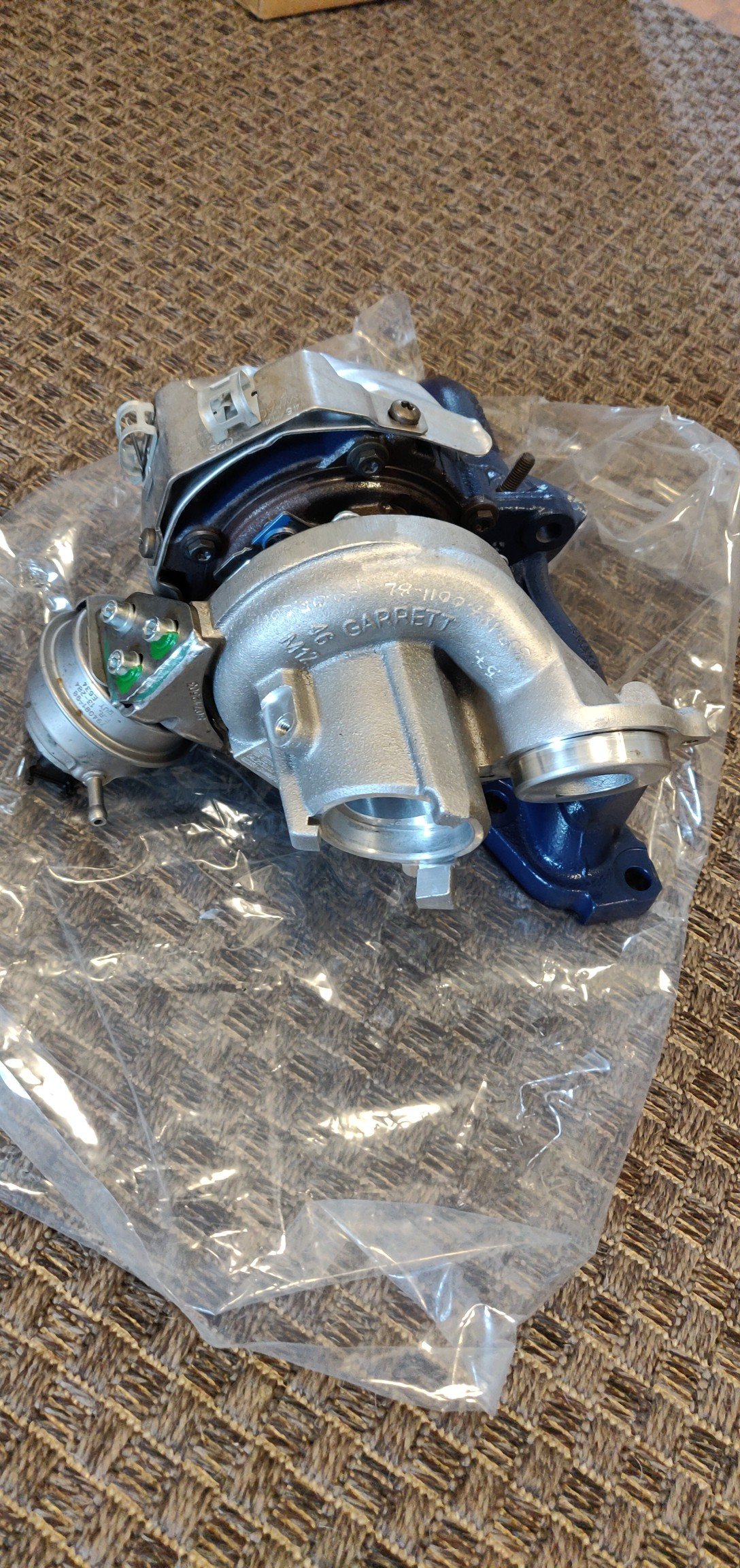

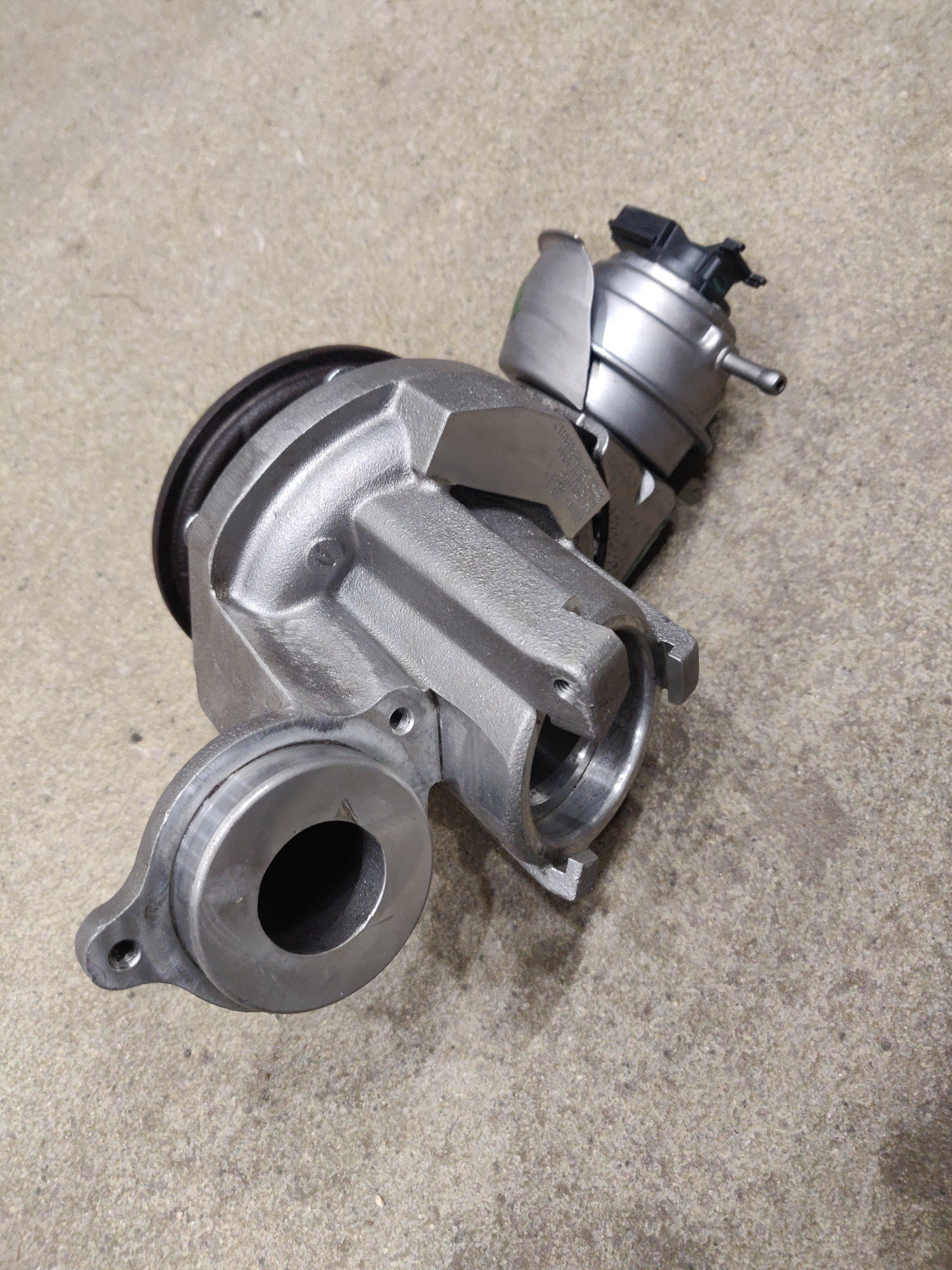

Finally turbo rebuild is ready (incl. performance compressorwheel and TechLine Turbo Blue coating) :inlove:

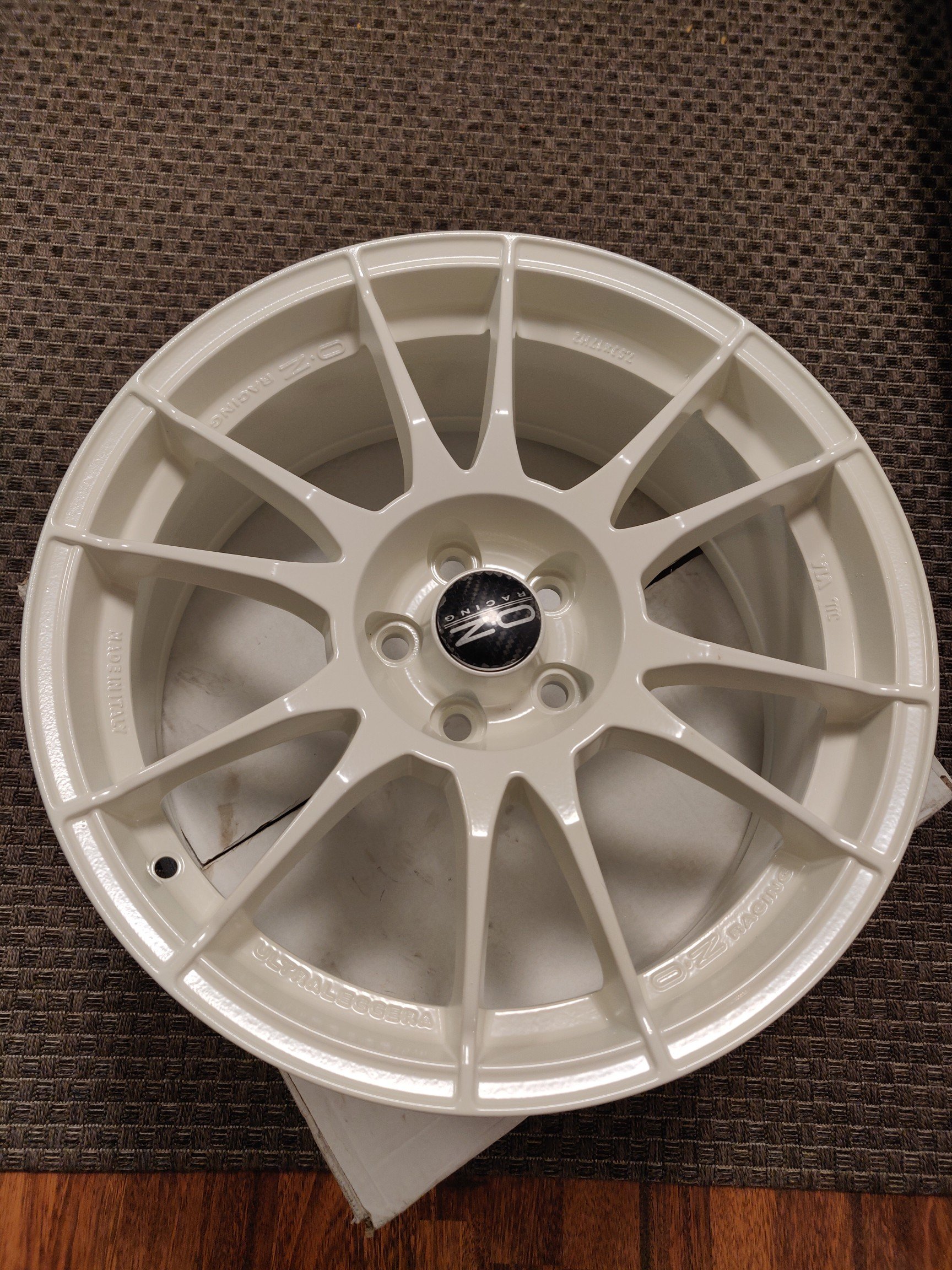

New(used) summerwheels. 17x7.5 et35 OZ Ultraleggera.

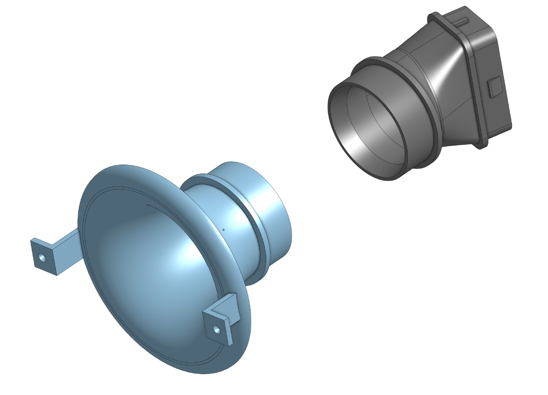

New air intake design.
Details
18 minutes ago, AMD87 said:
Details
- 3d printing@3dkTOP filament (temperature resistant up to 230deg)
- 3.5" hose between airbox adapter (grey) and intake trumpet (Blue)
- Intake trumpet: Elliptical profile, uses stock intake mounting points/bolts
Is there enough room between the battery and engine?
Not yet, but I'm gonna replace my battery to Sznajder-SilverPremium (55Ah, 540A), so battery length is reduced from 242mm to 205mm. And if necessary I'm going to fabricate custom battery tray.
