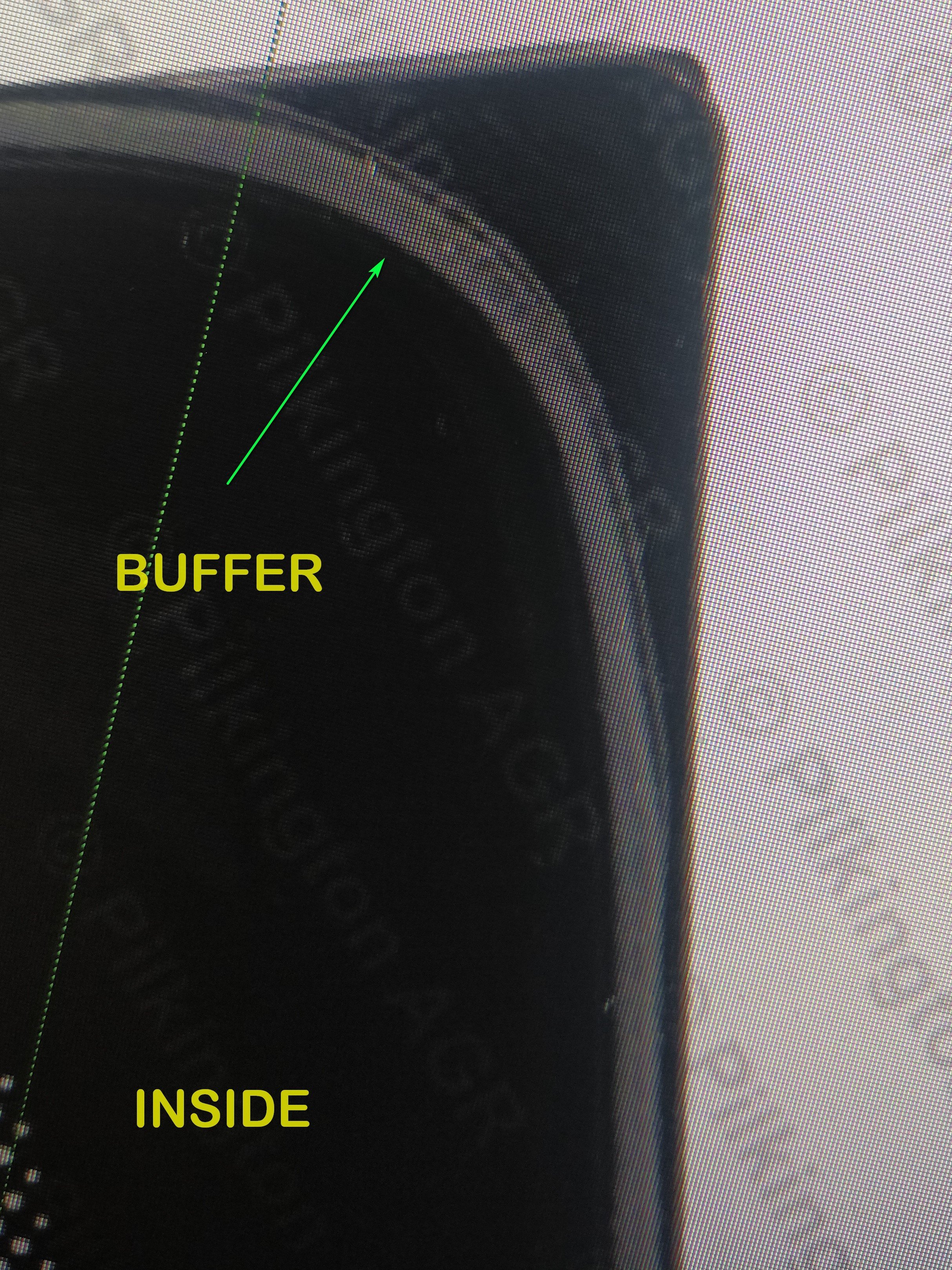

Re your questions: the earlier windscreens for this car come with an underglass trim fitted to the glass edge. There is no 'seal' as such; the glass is glazed directly to the car (oka bonded) with a polyurethane adhesive. The trim is pre-applied at the factory so the glass comes, effectively, pre-encapsulated. It is not a separate part, but does provide a 'buffer' to ensure the glass doesn't end up flat against the pinchweld. The later screens were produced without a trim (the trim would have been replaced with a thin line of adhesive to act as the buffer).  In any case, it doesn't matter as the overwhelming majority of VAG cars are glazed without these trims. If anything, the trim can sometimes hide sin (if the windscreen fitter scratches the paintwork for example). The absence of one means he will have to be conscious and alert about what he's doing because the slightest lapse in concentration will show.
The notes I have show that the 'trim-less' version has now superseded the trimmed version. Any screens with trim on will be old stock or cheap reproductions for aftermarket distribution. The attached image shows the earlier screen with a trim. Image courtesy of Pilkington AGR part of the NSG Group.

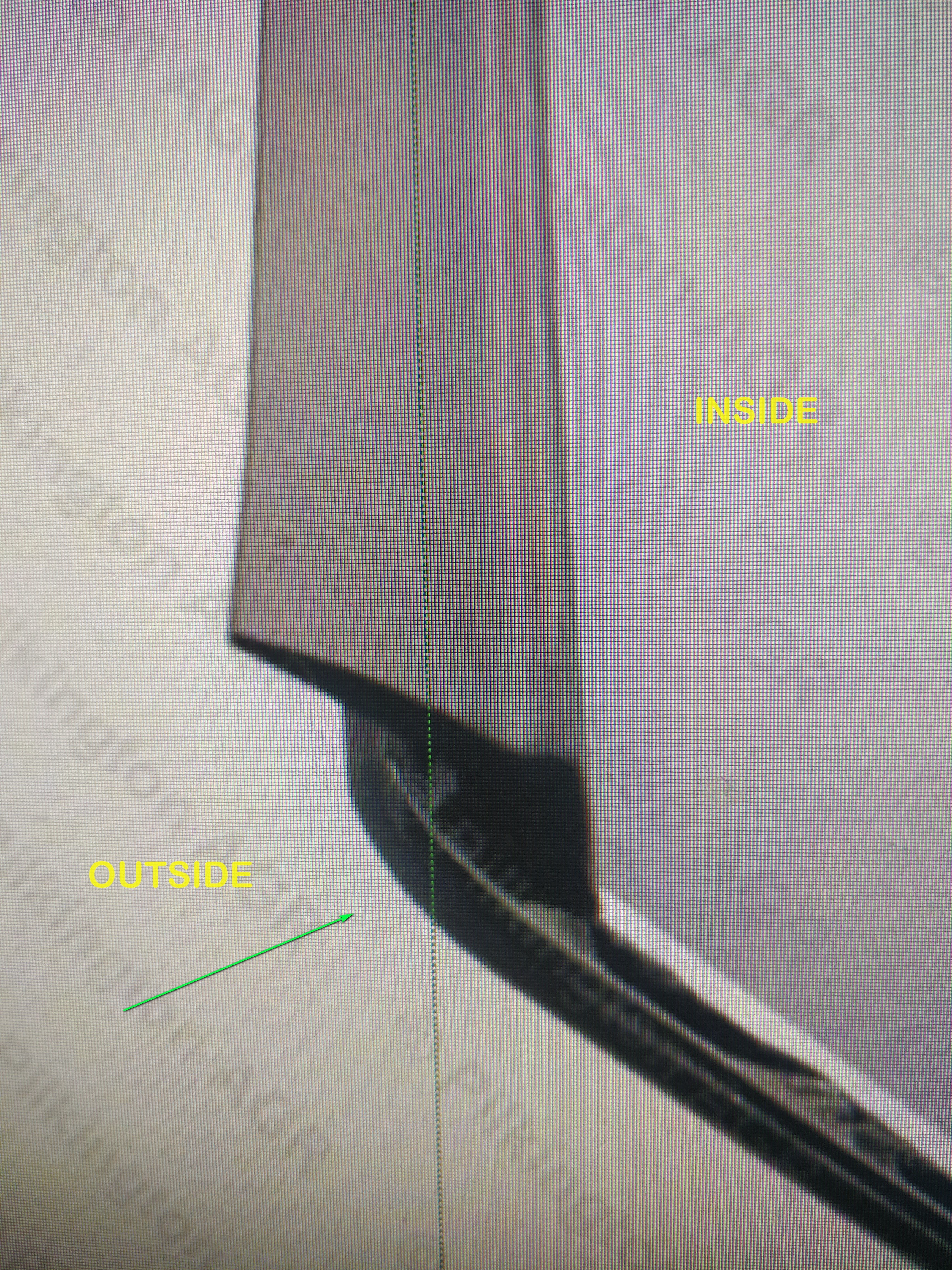

Second image to follow...
This image (again, courtesy of Pilkington AGR part of the NSG Group) shows the modified version whereby the trim has been replaced by a buffer (it ensures the glass doesn't end up recessed too far in the aperture and flat against the frame).
My guess is that the glass might be sitting too high if anything. But there's nothing wrong or missing. If anything I'd say it's more about the finish/lack of attention to detail + the brand of glass (which you still haven't told us).
