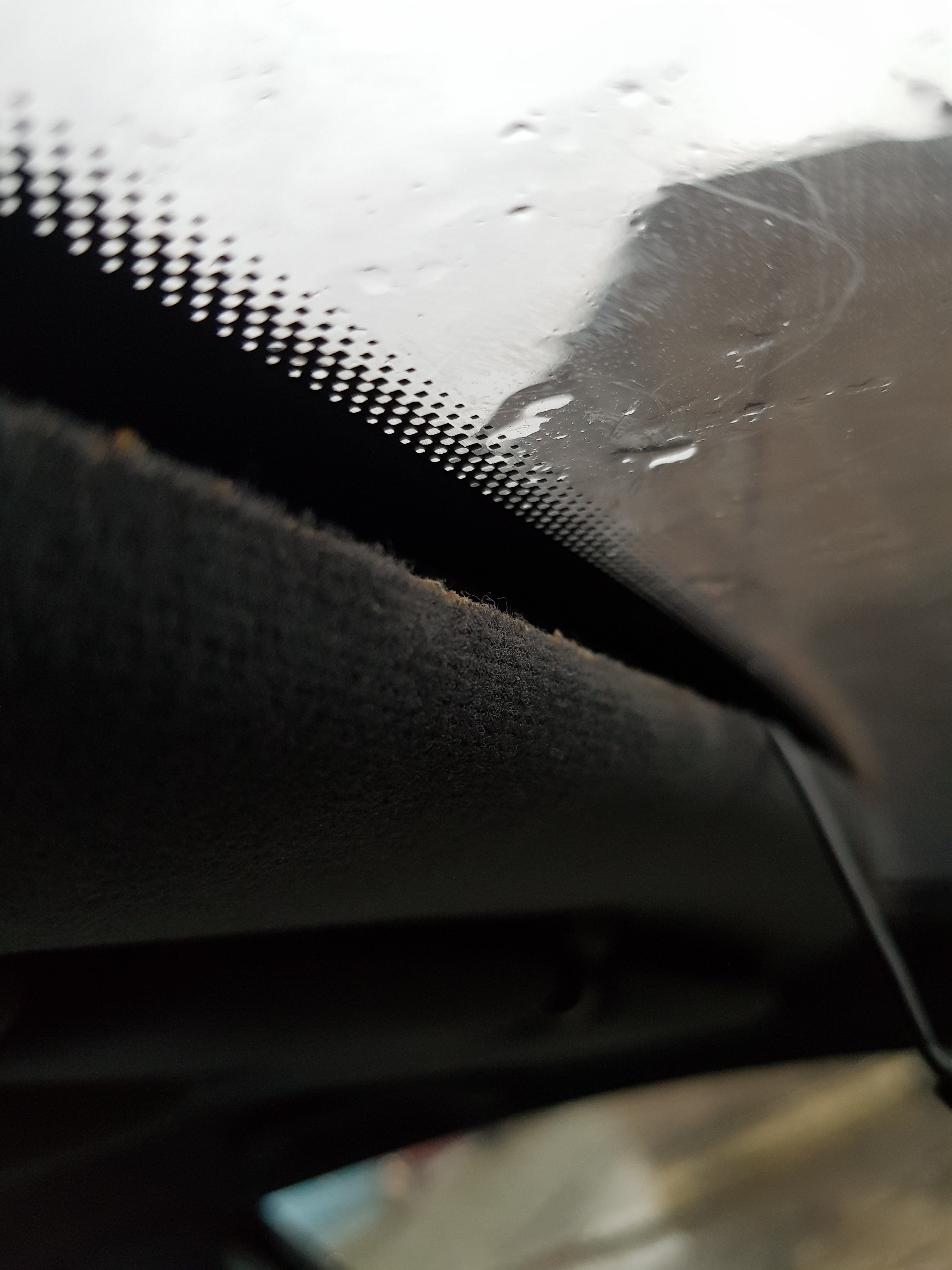

As per title, just had a replacement windscreen fitted via insurance company and now have a 5 -15 mm gap between the front edge of the headlining and inside of the screen ? Edge feels quite rough also. Cant say ive ever looked in that area ever but had to as my parrot microhone wire wont retain itself any more because of the gap...
Wondering if theres a seal of some sort missing or if theres any reason the fitters would have to cut the headlining back.

There is no seal or trim to go there, and I doubt the fitter(s) would have cut the headlining back (unless they hacked into it whilst removing the windscreen or cutting back the adhesive, and have evened up the damage).
Does the windscreen look like it's sat a bit high in the rebate?
Image will help.
Difficult angle to picture properly . The headlining edge def appears to have been cut , rough, sharp edge all way along .

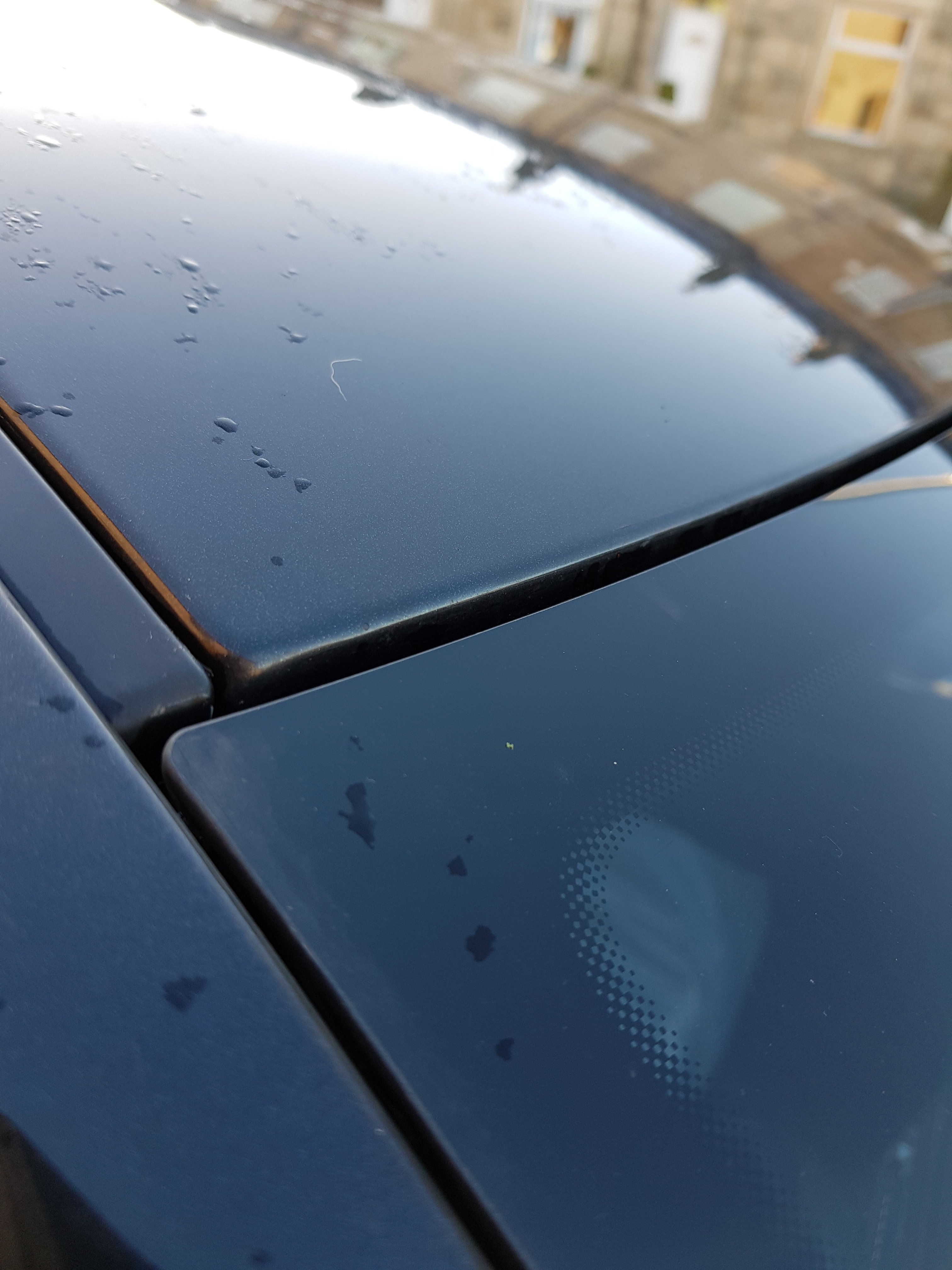

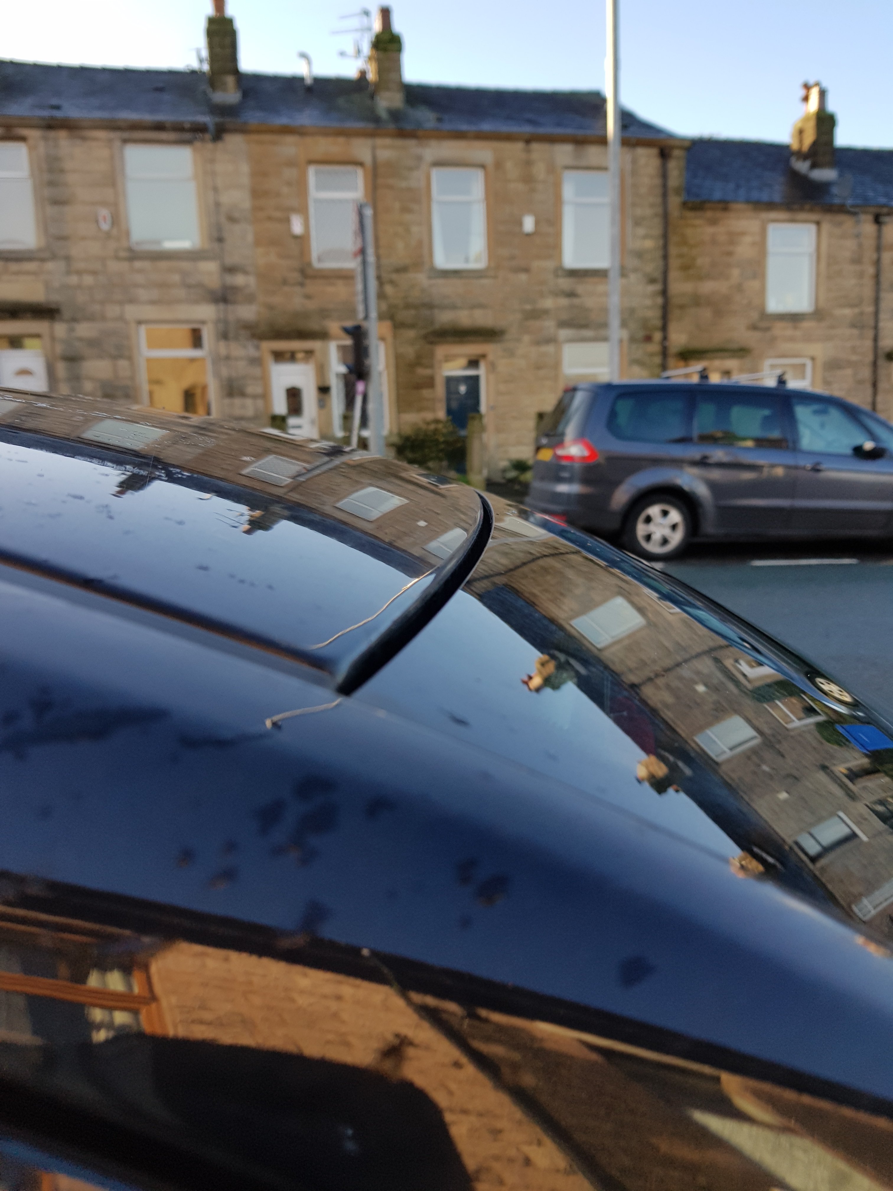

On the outside top edge of windscreen is flush, slightly low of front roof edge . All looks good from outside

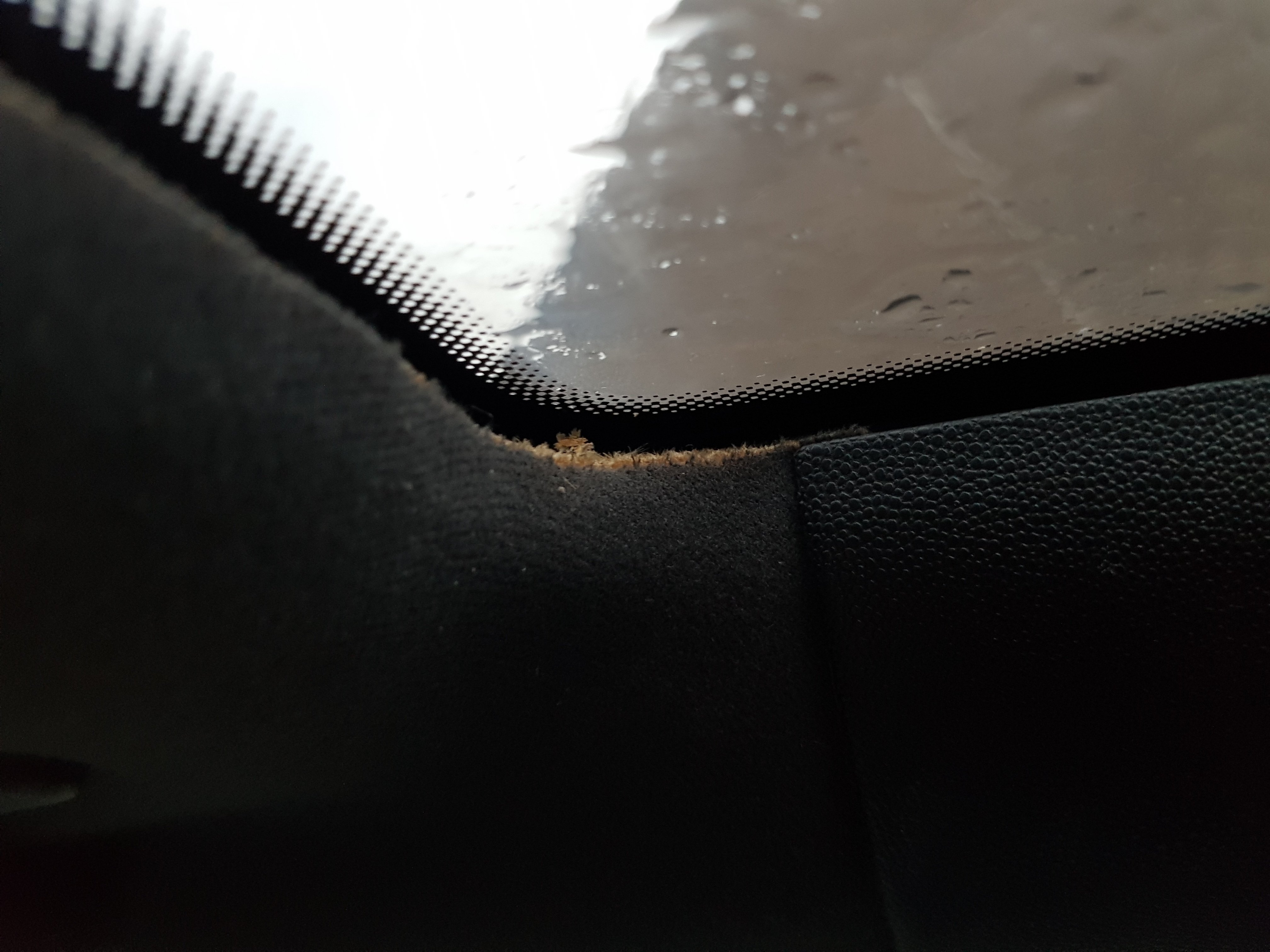

I'd say they've damaged it with the cheese cutter wire thing or whatever cutter they used when they were cutting the old screen out. Just had a look at mine which has never had a replacement windscreen and the headlining edge is totally smooth and snug against the windscreen. No ragged edges like yours now has.

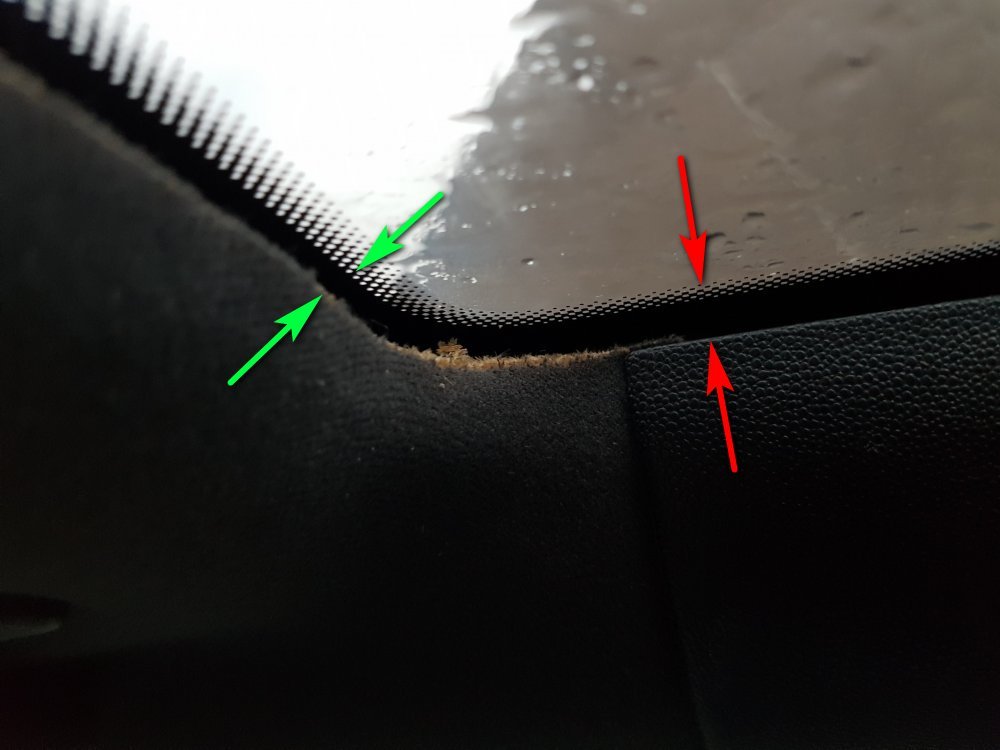

I'm not convinced just yet but the gaps do appear to be excessive, Look at the A-pillar trim against the glass (marked in red) it looks wider than the gap between the glass and the headliner.
Yes, the A-pillar trim gap does look too big for sure.
So potentially it's sat too high on the adhesive and maybe they've been a little heavy handed with the cutter ? !!

Is the screen flush with the roof on the outside?
Yes it is !
Looks perfect to me. Must just be the headlining they've messed up.

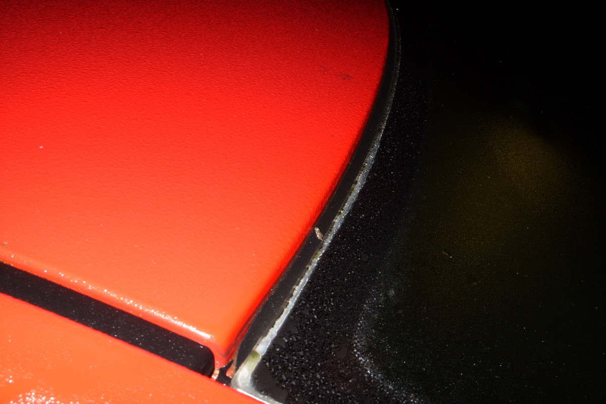

Just had another look at mine and there's a rubber trim in the roof gap at the top that looks like it's missing off yours.
