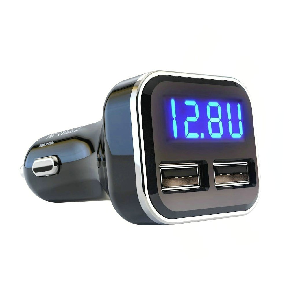

Something like this is handy to have; a plug in voltmeter with two usb charger points:-
https://www.amazon.co.uk/dp/B01N5I0J92/ref=sspa_dk_detail_0?psc=1&pd_rd_i=B01N5I0J92&pd_rd_w=jjMDX&pf_rd_p=8e5be0e3-b258-4b06-8b6e-695b24f935a4&pd_rd_wg=rYEMS&pf_rd_r=TMXSTXNZJG6NS716AZEY&pd_rd_r=7b5a2030-02b9-11e9-aa85-d35187ec82ab
Plugs into the power/cigi sockets so you can monitor battery volts before/during starting and while charging.
Not at all the type of response that I was seeking but very fortuituous nonetheless as I need a car USB charger anyway, not sure if the display would react quick enough as I know that my digital multimeter would not, the car really does start in a fraction of a second, I read all about the quick start feature of the PD engine in the VAG study guides.
I have a seperate problem that I have lived with for years of the satnav switching itself on including the display after 168 hours which if left connected to the charger will discharge the battery in a few days, I avoid it but having that device would warn me and also show me when the battery cell voltage finally does start to drop as it nears the end of its life.
so thanks, I will buy one but am not convinced it could give me the transient reading that I believe VCDS is capable of if I knew how.
