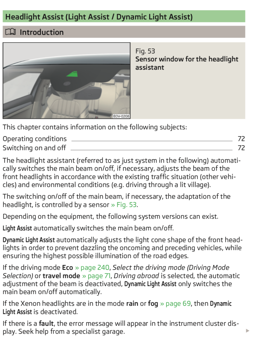

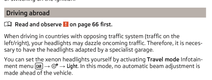

I tried changing the driving side over but it advises me not available.  I will confirm he message but it also seems the SLA is working and the lights are reacting and dipping to conflicting traffic.  I thought this should not work see manual:

according to the manual - your lights r behaving as expected.
dynamic light assist still does HBA (high beam assist) when in travel mode.
are u sure u have SLA?  i.e. it does the "masking" thing when high beams r on?
with SLAs, the high beams do NOT react by dipping - instead they auto mask the high beam.
with HBA, the high beams do react by auto dipping.  it doesn't mask the high beam.

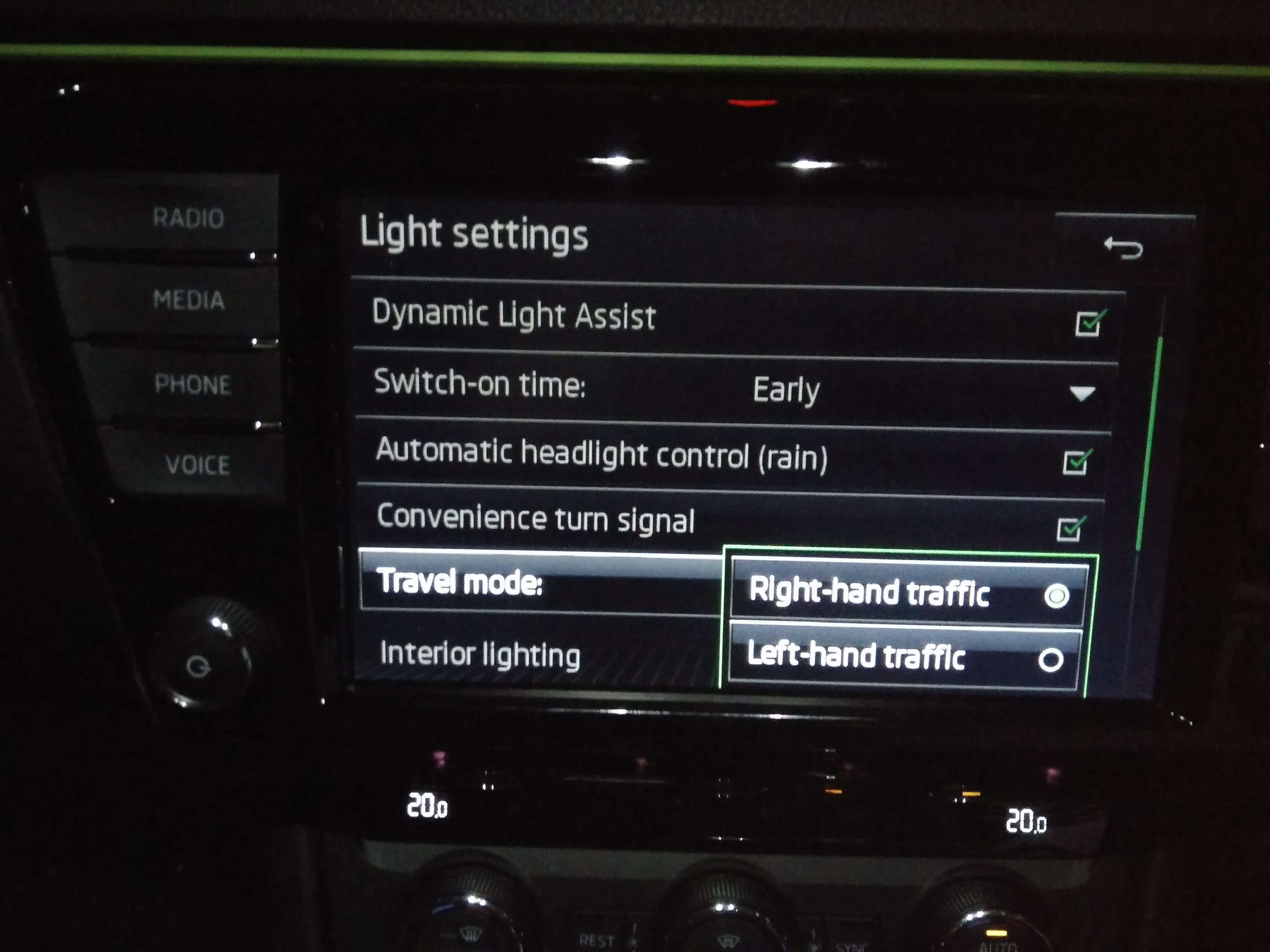

I am happy with UK operation and the differences between HBA and DLA but what I was not sure about was the discussion i had seen about auto changeover from left to right hand side.
Well just had a play with it again today:
If you leave light selection in auto nothing changes, it stayed in left or right as selected.
If you are driving you cannot change Travel Mode between left and right.
If you are stationary you can change Travel Mode between left and right and the shape of the dipped beam visibly changes.
if you are Travel Mode left (incorrect for driving in Europe) then full DLA works when auto lights selected and headlight stalked flicked forward.
If you are in Travel Mode right (correct for Europe), see pic below, then only HBA works when DLA and auto lights selected and headlight stalked flicked forward.
