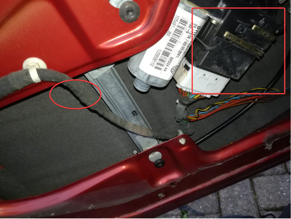

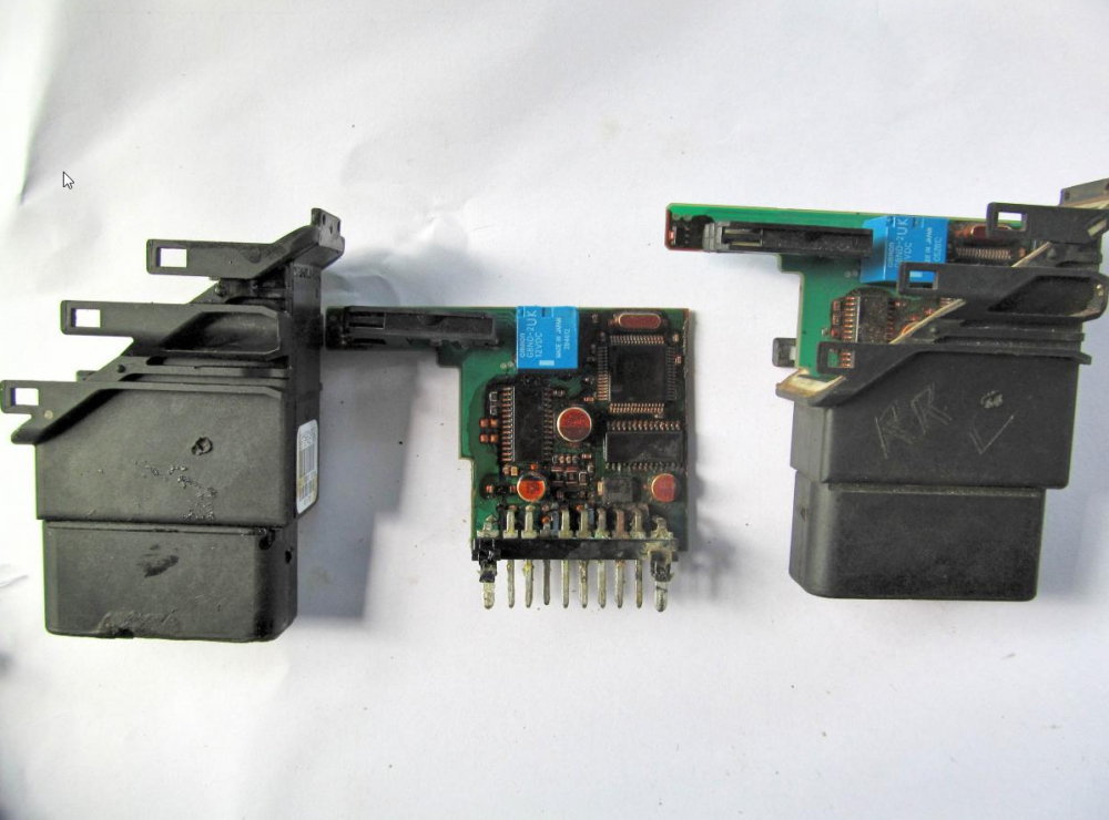

if you installed a new regulator and motor they usually have a door lock module there too ( door lock and door loom all come from the same connector) and this would need pairing with the ECU to work properly.
This is the part of the  window motor I'm on about:

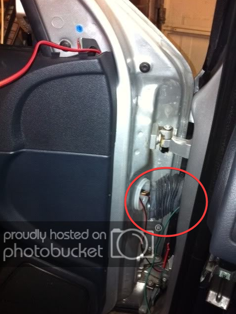

Another issue I've had with mine whenever somethings works intermittently is either cables that are corroded inside or chafed cables especially where the cables pass from the door into the cars body through the rubber boots if you like:

A rotten through cable will look fine on the outside but will look like this on the inside instead of shiny copper you will see a 'green colour'
All the cables now will also be very old and stiff & crusty on a 20 year old car:
You should remove the whole loom from the door and undo that black 'tape' covering the cable and check everything for continuity and breaks in the outer cable.
