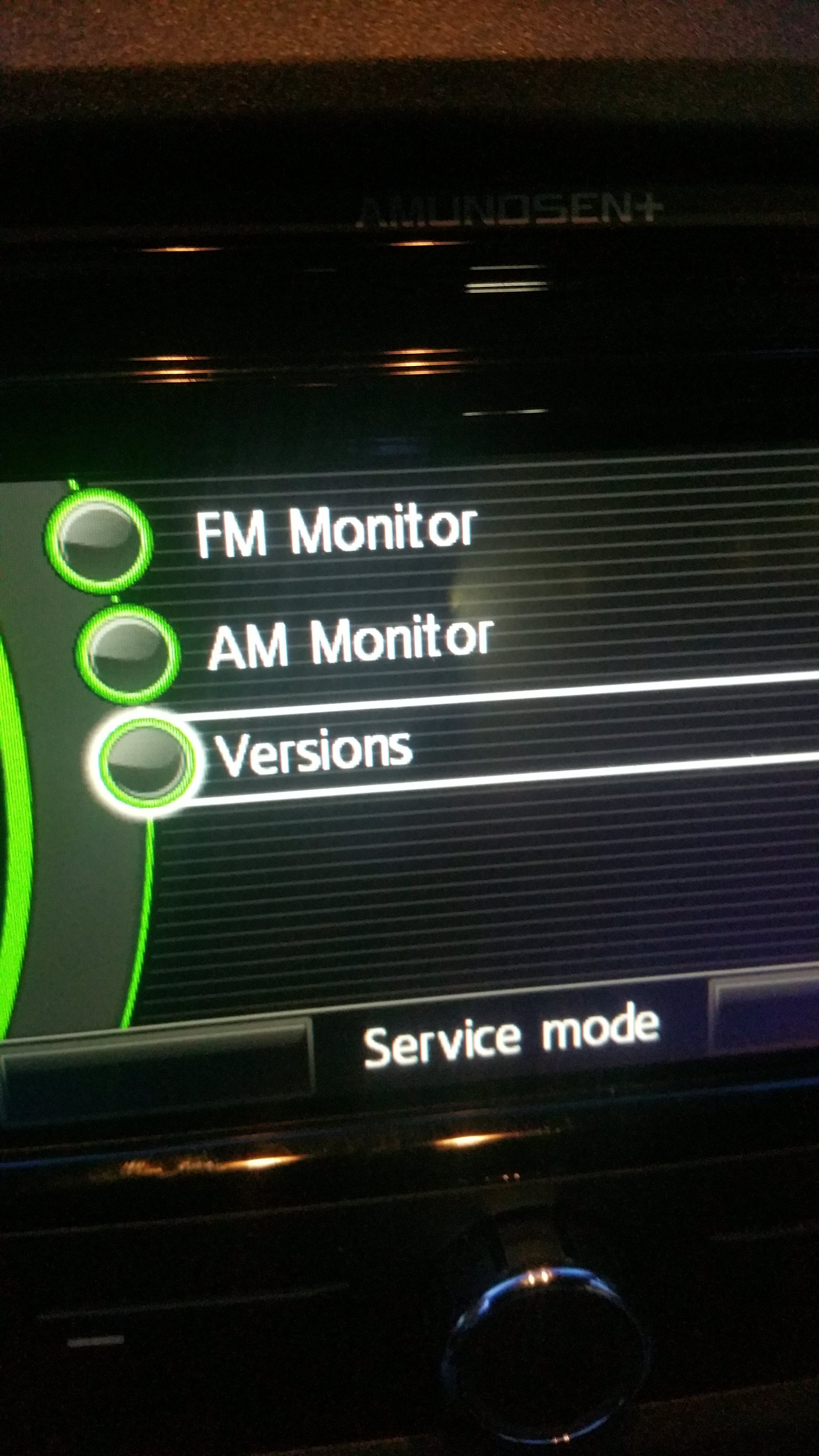

you can download the maps you need to buy it and once the sd card is used it locks to your car. first we need to know what version you have
Press SETUP and hold about 10 sec. On screen choice "Versions"

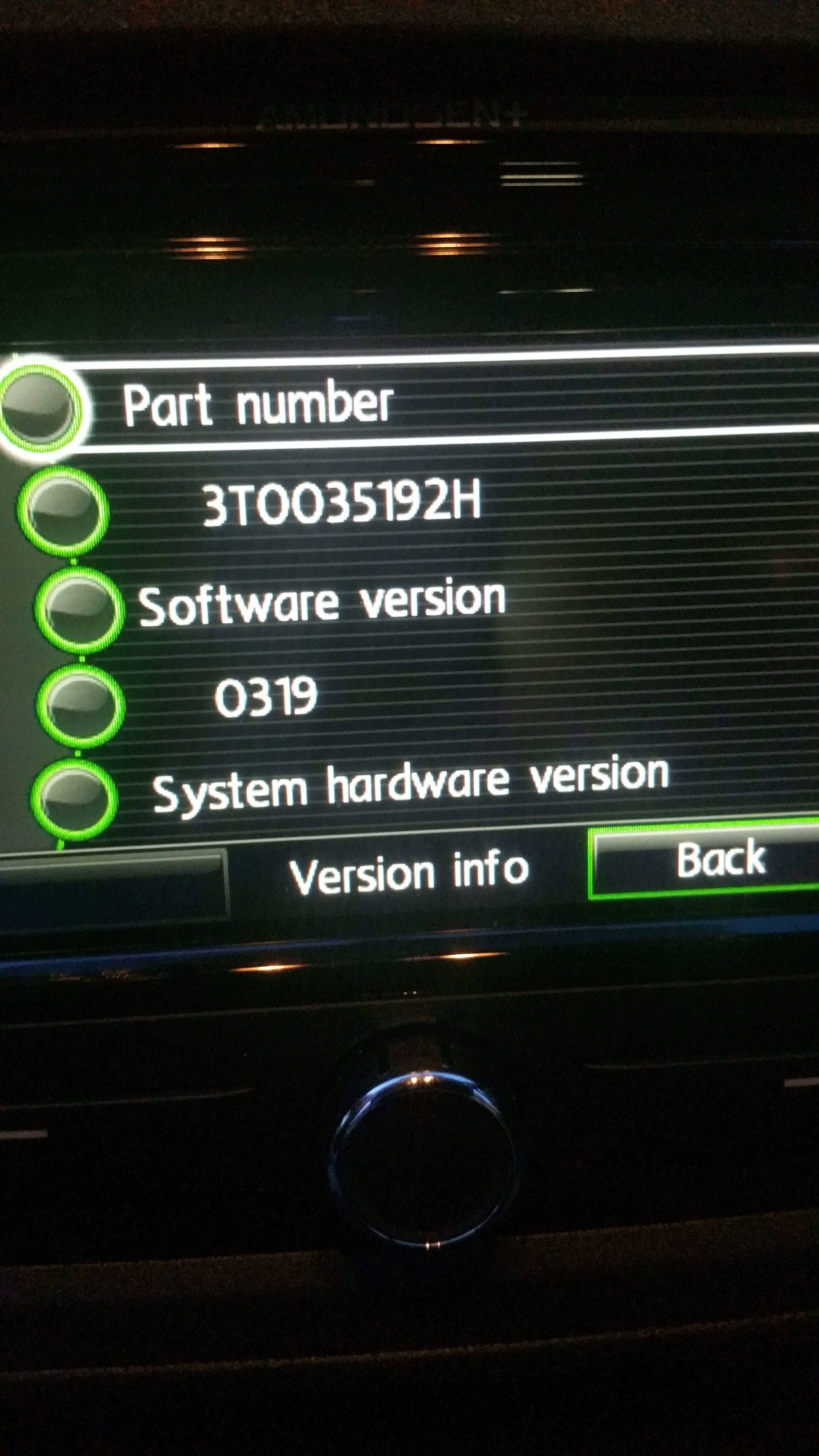

1 hour ago, Lloydy11 said:
So it only has 3 options not 5?
3T0035192H relates to an Amundsen Plus unit. There should be maps already loaded onto the unit and saved in the internal memory, and a new version of maps can be installed/saved with a new card.

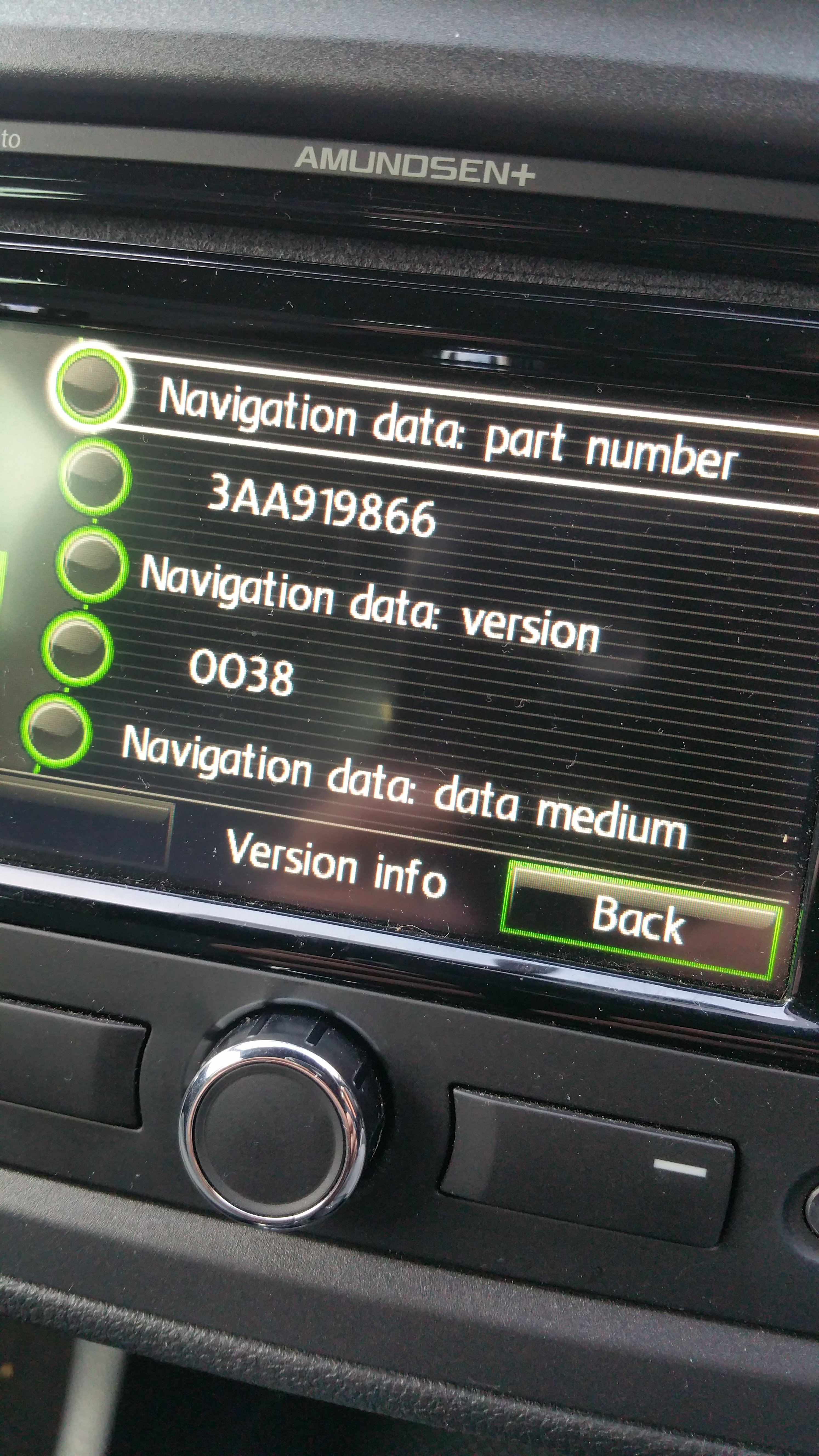

Turn the centre knob to scroll down and see further options.
0038 is fairly old, as they now number them in V number format. Latest is V11, previous V10, and the last stable one is V9 (V10 and V11 can cause the unit to become unstable and shut down/reboot constantly).
