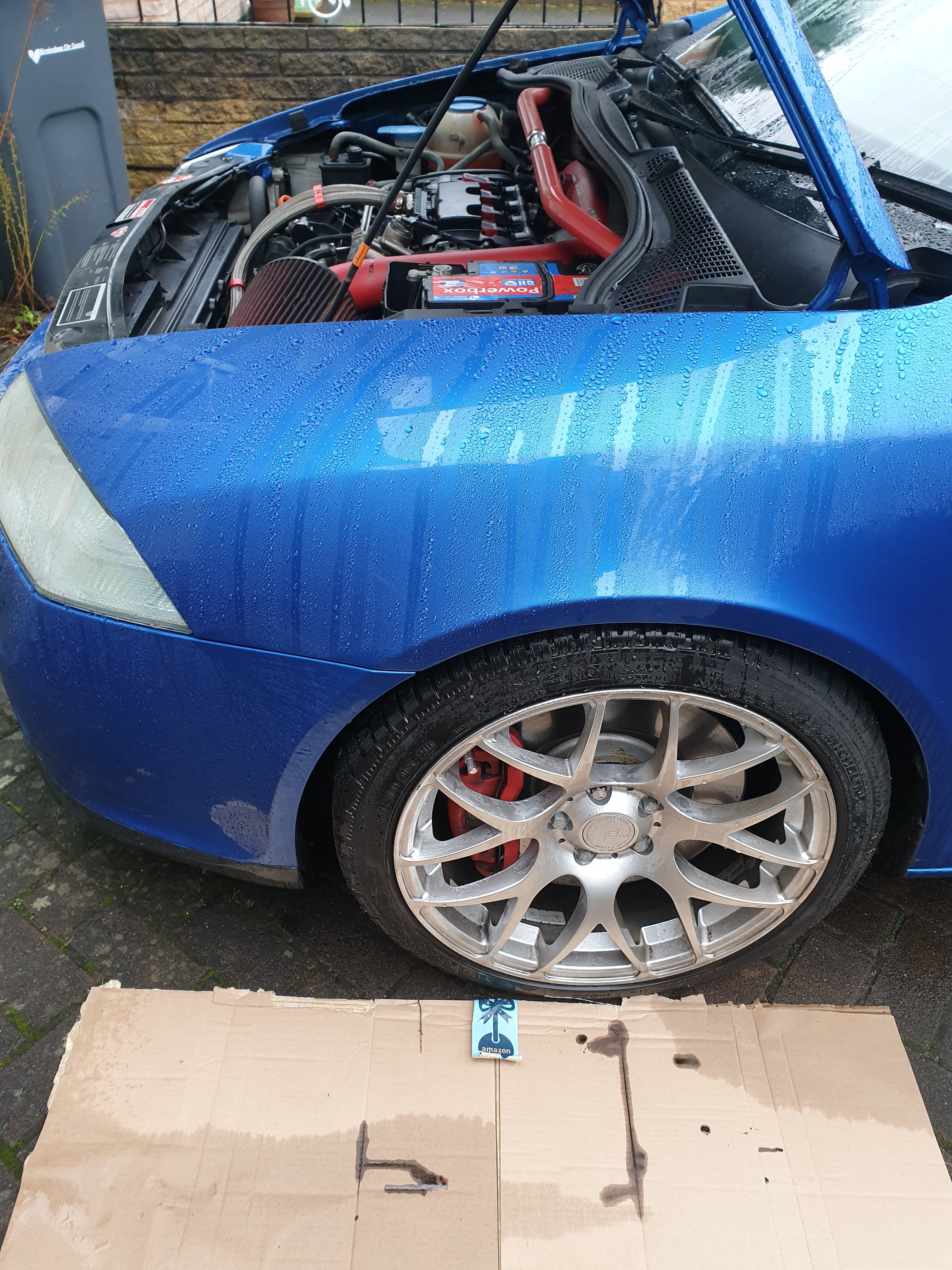

Been left 15hours and this is what I found to have leaked.. obviously I've pulled it from under the car and placed it next to where it was poisoned.. will need to get it on a ramp to inspect.. doesn't strike me as much but defo smells in cabin when blower is on "/

That could well still be the issue. If the rocker box cover is tightened down unevenly or the gasket/seal is imperfect you will get leakage when the motor is running and - with fresh oil in the motor - it won't smell sour like engine oil does after a while.
Try wiping off around the rocker box joint to see 1) if there's oil there and 2) so you can go back after a drive and check for fresh oil.  If nothing else it should help reduce the number of candidates for the source of the leak/s.

Had it up in the air.. looks like the leak is coming from high up towards the back of the engine or turbo.. gearbox looks fine.. looks just as it did last time I had it in the air befor the service and bits i had done.. only this time the smell comes in to cabin with the blower on..eurgh
