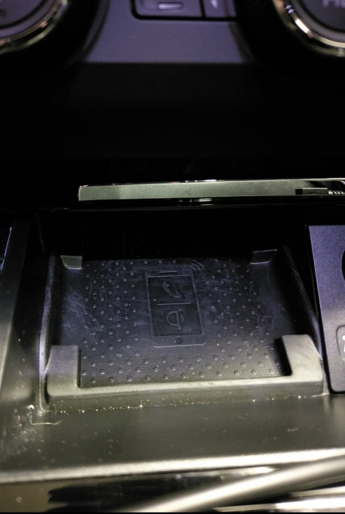

Wireless charger is that xtra? how can i check if i got this?
U will c a "qi" symbol on the mat, if it has it.
Edited by JR RS
Thx
