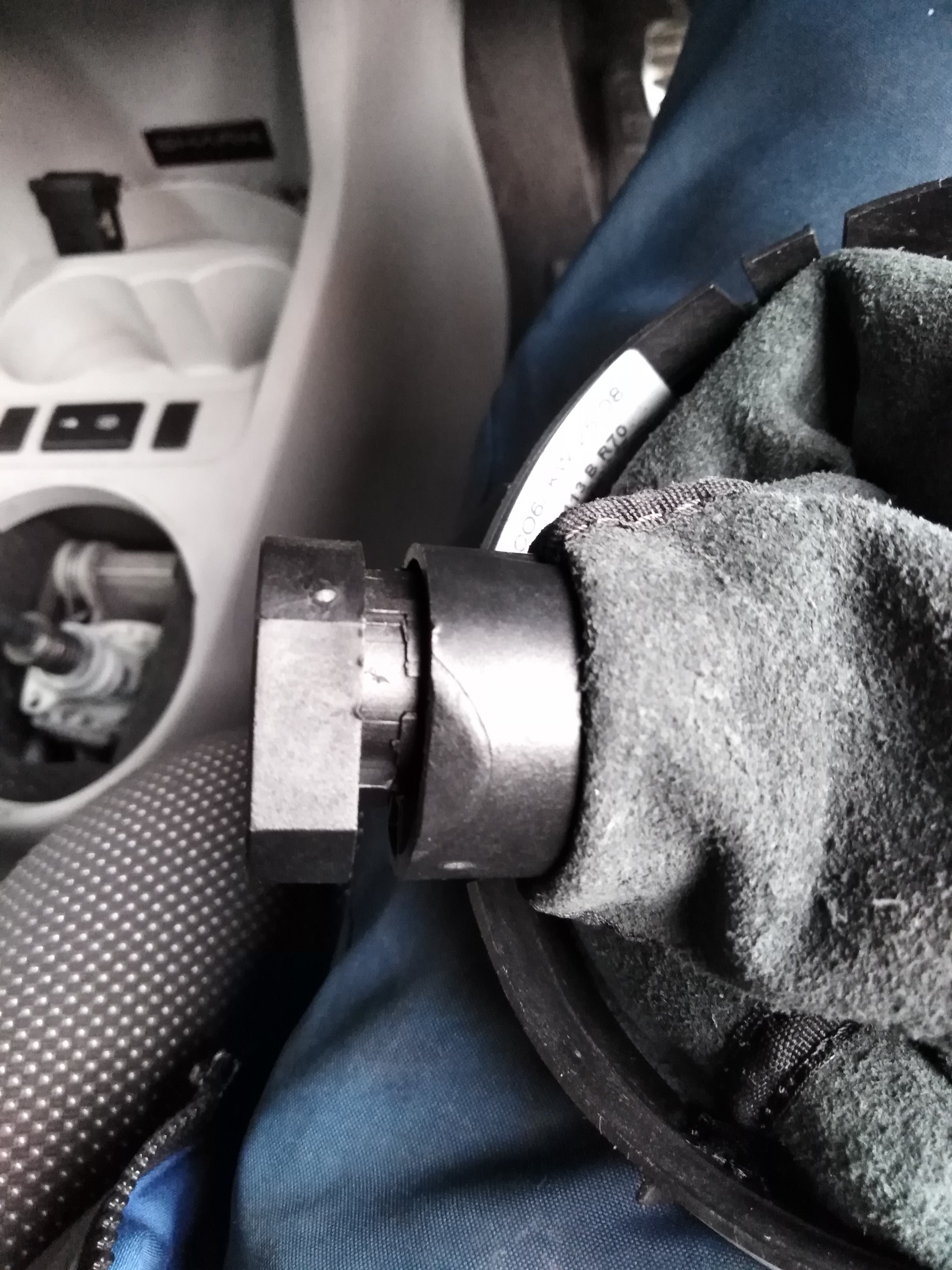

Hi , has anyone removed gear knob on a Roomster ? All the vid's i've looked at have a clip around at the bottom, mine doesn't have one.
So you want to know how to remove gear knob.
It's easy, you get a flat ended screwdriver and you prize the bottom part of the gear knob down and you just pull the gear knob off.
