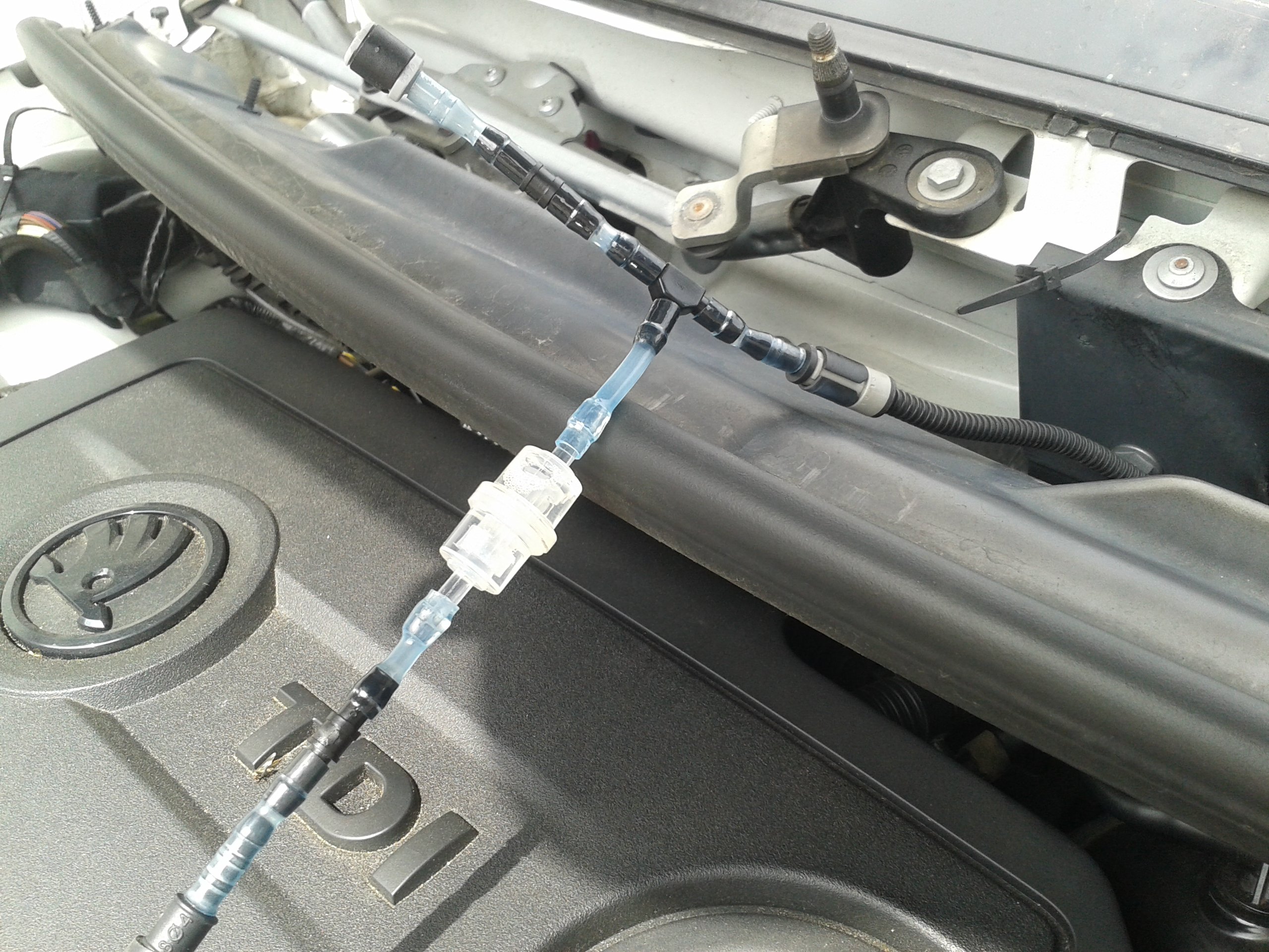

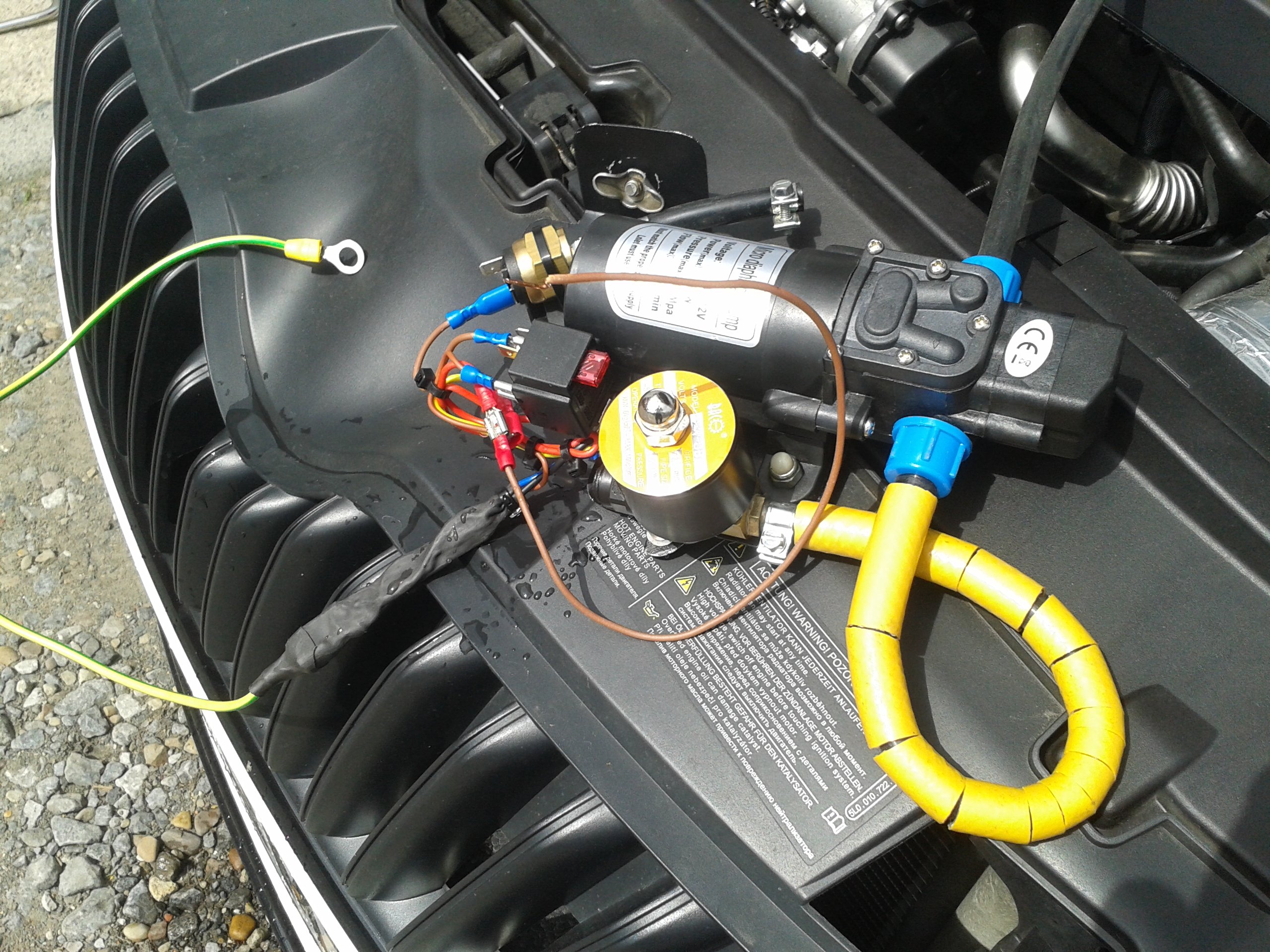

DPF been running fine, I regularly travel 60 miles total per week on't M62 so I guess it gets a good dose of burning up the soot :) I did run a DIY water/meth system for a few weeks [see images] after months of development starting at beginning of 2018. Not sure I was getting any performance increase but I felt good inside knowing that I was knocking the miles off the EGR, valves, piston crowns & turbo vanes :) I might reinstall it now the zorst has been done. I believe Darkside's 1.6TDi Golf 'only' achieved an extra 20hp with a 'proper' water/meth system so anything my ad-hoc system could achieve would be limited I guess. I've been looking at Nitrous but after talking to Darkside and Bluespark for advice, it seems only a remap for extra fuelling would be the most suitable option to extract the most out off NOS. A part of me hopes that a meth system could provide the extra fuelling required though. Then I could naively have my DIY water/meth system linked to a Nitrous system (both activated with the same boost switch). ONLY issue with my water/meth system is that it's a 'stealth' install that utilises the current windscreen washer bottle and so I can't run more than 50/50 water/meth ratio otherwise a fire risk is possible. For NOS, I'd probably need 100% methanol.
