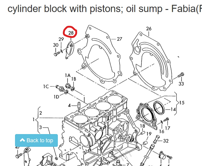

I think it's 038 103 648 H and is listed as part of the engine.
28 here...
28 here...
Fantastic
cheers for that mate
