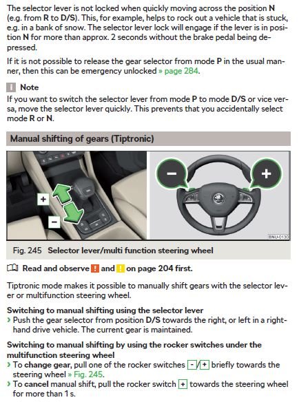

I have just took delivery of a Karoq SE L Auto. what is the right setting i.e gear and engine mode should I be in when going up a hill for those who know it I go up and down Parbold Hill twice a month. Also the gear shift moves to the left what is that for?
If the gear shift is 'to the right' then the car will decide automatically what gear to be in and if you press it to the left then you can also move it back & forward to change the gears manually within certain constraints.

 You also have paddles on the steering wheel that you can select gears manually

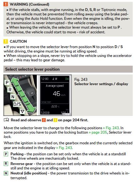

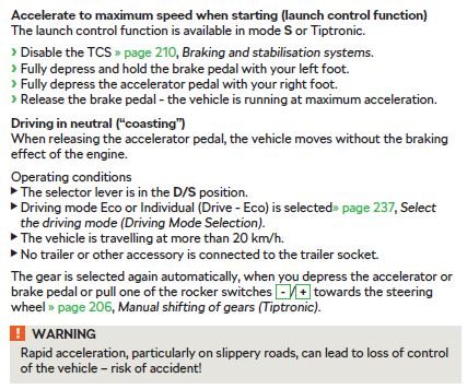

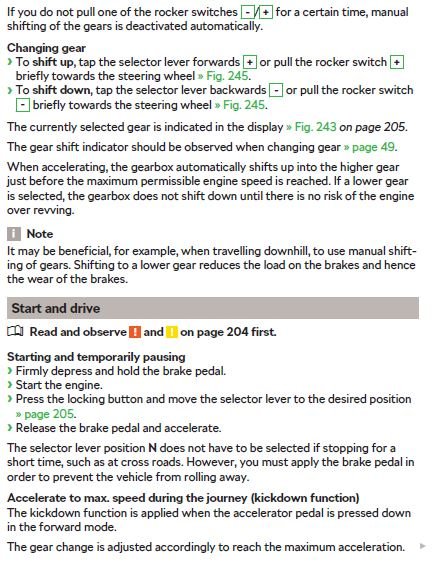

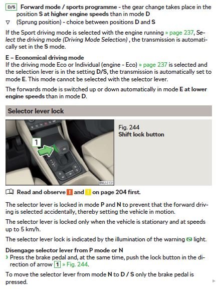

It's worth spending some time with the manual to familiarise yourself with some of the basic controls.
You can download them in PDF format here...
http://www.skoda-auto.com/services/owners-manuals

There is a kick-down function on the accelerator pedal. Pushing it down as far as it will go will drop a gear, increasing the engine RPM's and hopefully releasing some much needed acceleration before you reach the incline.
It is worth experimenting with the mode.  I used Sport mode on a run recently and it seemed to keep the revs in the 2000-3000 range (1.5 engine) compared with normal mode which kept the revs in the 1500 -2000 range on light throttle.  We don't have many hills around here so I don't know how it will change performance on a hill but at least you would start with higher revs.  Incidentally, at 60mph, sport mode does not select gear 7 but stays in 6..  My previous SEAT with the same DSG box would downshift to apply some engine braking if you braked on a downhill.  It didn't seem to react to down gradients unless you also braked.  I assume the settings on the Karoq are the same.
You can also change to sport mode on the gearbox.  To select sport, pull the gear lever back from the normal D position.  However you select Sport mode, you have to do it every time after the ignition is switched off
