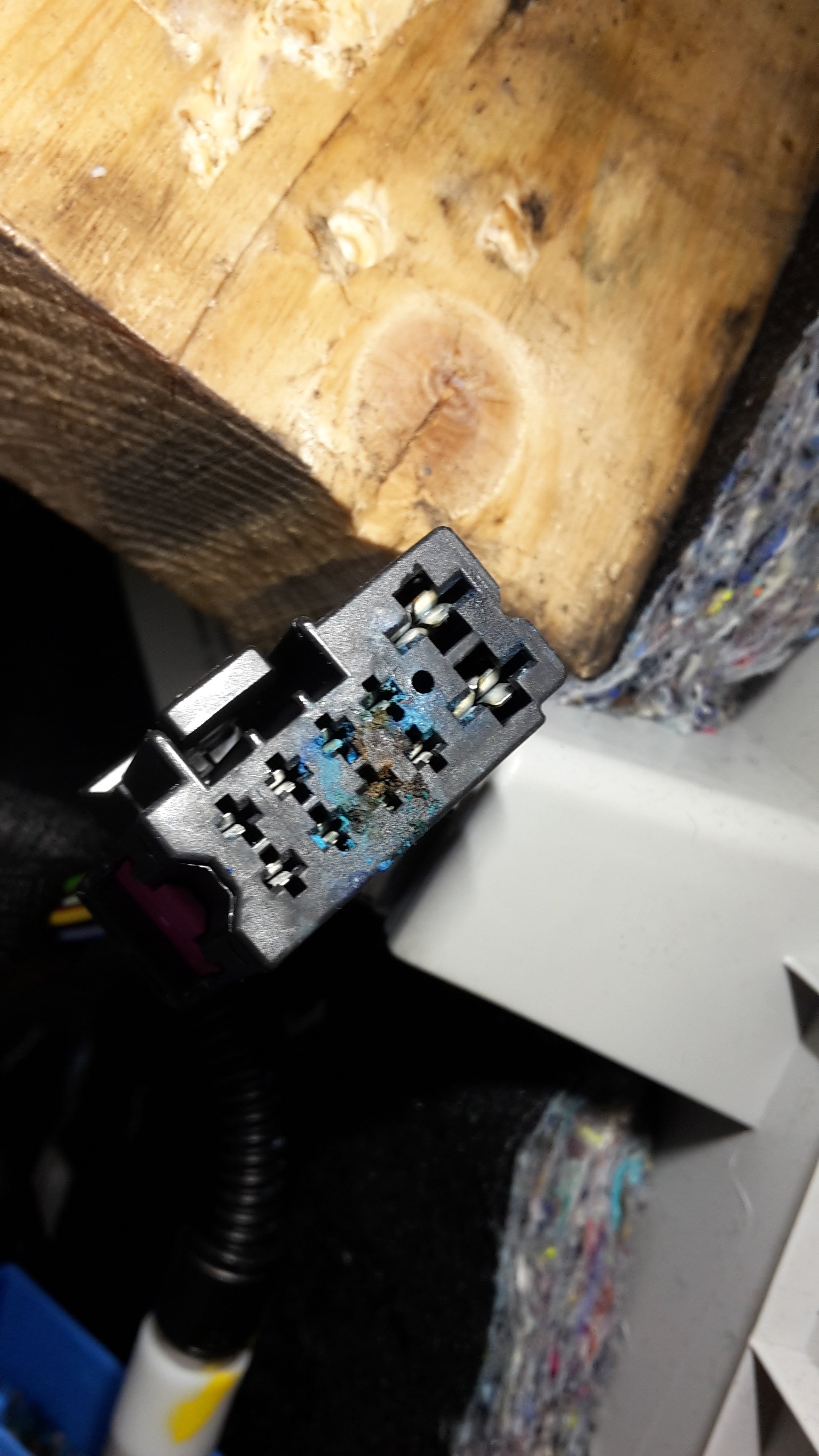

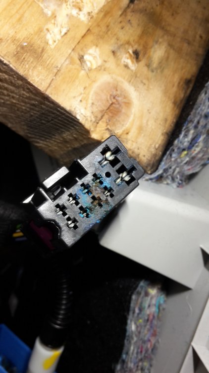

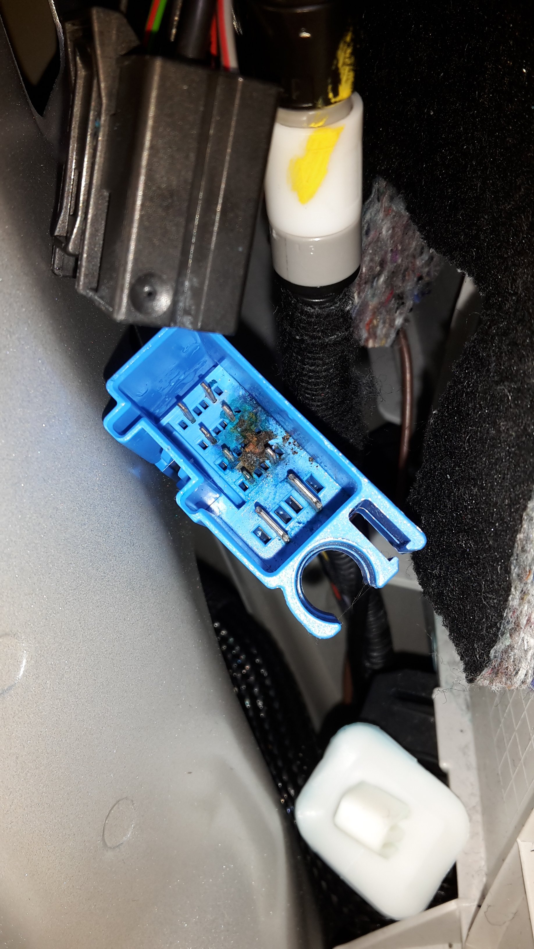

UPDATE:- Car fixed. Done at main dealer, Robert Eardley Stoke.
Multi plug in loom at the rear of the car adjacent to "D" pillar, LH side corroded probably due to condensation, or maybe water ingress where the loom exits the D pillar to the tailgate.
Dealer took photos of the multi plug prior to repair, will upload them.
Dealer reckoned they had not seen it before.
