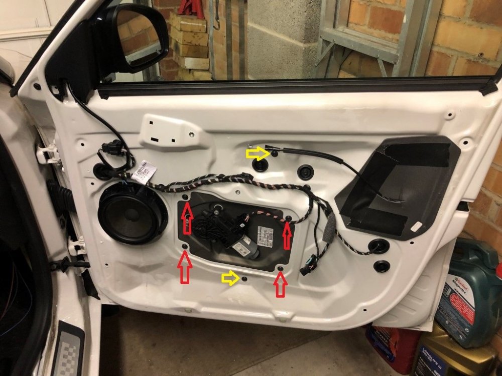

What I would do (first), is remove the door card / trim, then slacken and remove all the bolts x 4 that hold the regulator / motor panel to the door (see image red arrows), You can then manouver the panel inside the door a little and this will reveal the plastic slide which runs on the track. Here I would (if dirty) give it a clean as much as possible, with something like WD40 or similar, then apply a spray silicone grease to the track as much as you can see. Then put the 4 bolts back into the panel and do them up but not fully tight.
Then slacken the 2 bolts 1 or 2 turns that hold the channel to the door (top and bottom (yellow arrows), operate the window through full travel a couple of times up and down, then with the window fully up, re-tighten all bolts and see how that works. There is also a twack at the front end of the door basically runs down behind the speaker, if you can get some spray in there that will help to.
You can also if you want, remove the motor (3 bolts) and whilst "helping" the window glass itself, turn the wheel on the regulator and move the window up and down by hand, you may need to just refit 2 bolts in the panel a couple of threads to hold it in postion when you twist the wheel by hand to stop it twisting the panel, this will enable you to position the plastic guide in as many positions as you want.
Offcourse, if there is something "wrong" with the regulator itself, this wont help, but def worth a try before spending.

The Audi A3 has a regular issue where the regulator wire frays and causes a similar symptom, eventually the wire just breaks, so may be worth looking at the wires if the track lubing doesn’t work.  It doesn’t sound like a switch problem.
