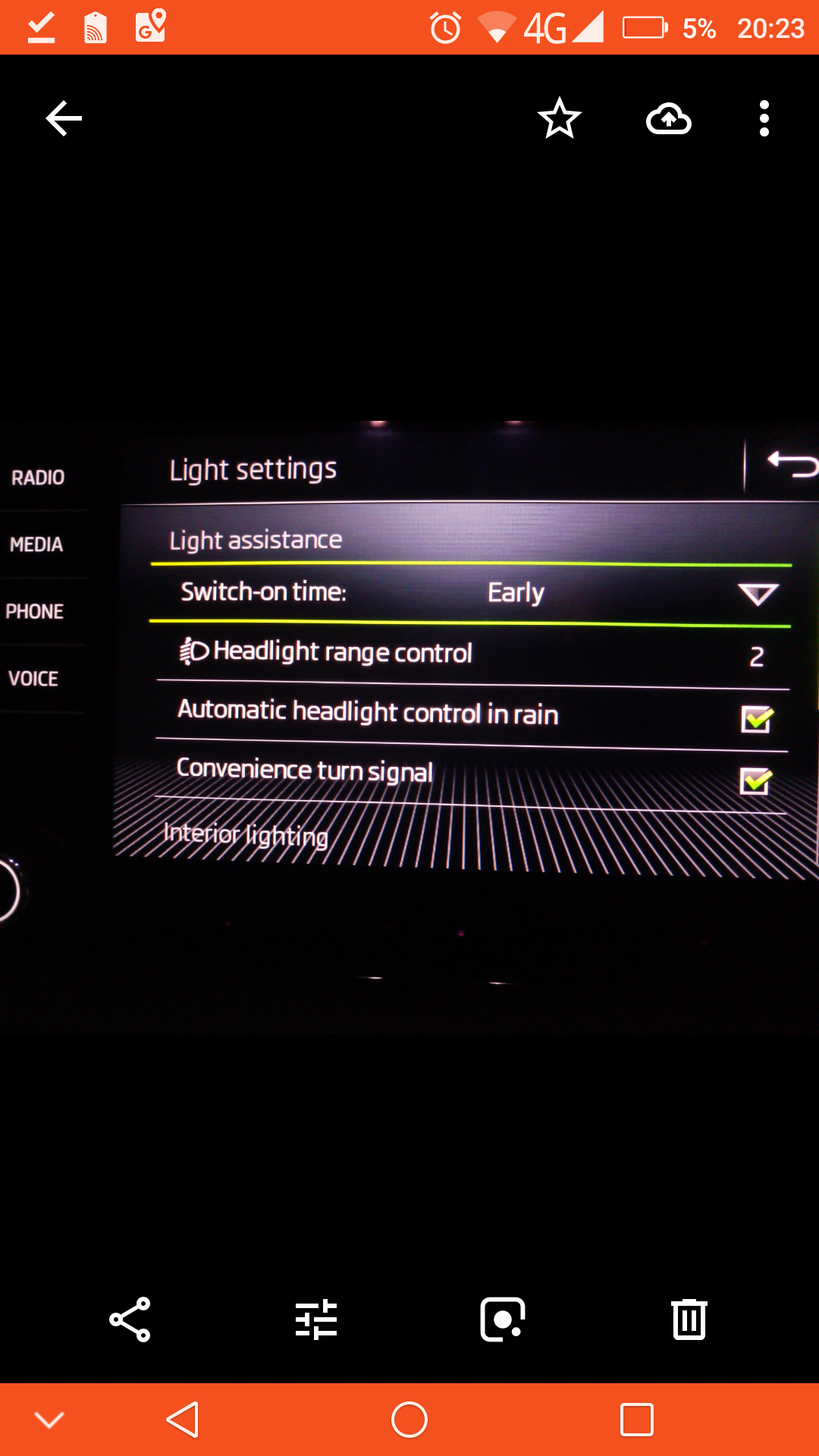

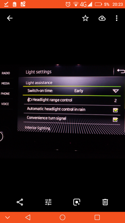

Hi again!
You know when you go to make a turn and a fog light comes on. Well I don't.
Is this what's in the settings as "convenience cornering lights"? If so it is ticked. But they don't come on. Is there something I'm missing? Thanks

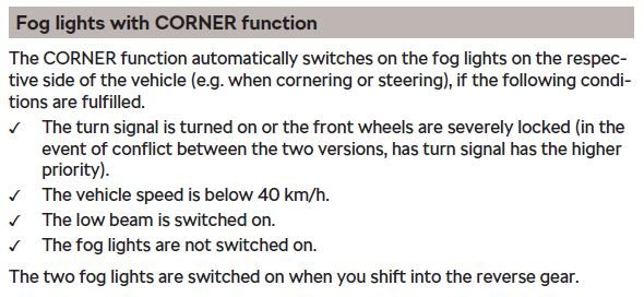

Are your dipped headlights turned on?
There are a number of criteria that need to be met before they'll illuminate.
You need to be travelling at speeds under 40kmph, dipped headlights must be turned on etc. etc.
Hi Silver, thanks for replying. I've driven behind enough buses to see reflections and I've gone through the list you sent making sure all the criteria are met. I'm still doing something wrong!
In the settings, this is "convenience cornering lights" isn't it? The box is ticked, maybe they just don't work?
There is no option, in UK anyway, to enable or disable the cornering fog lights, I sometimes wish there was as they are handy on unlit roads, but in well lit towns etc they sometimes cause confusion with other drivers.
The only convenience lights I can see in the settings is the convenience flash option for the direction indicators, that flash for 3 or 5 flashes when the indicator stalk is flicked lightly.
Ah Silver, you said dipped lights. I just use auto. Does the car need to be in manual dipped setting for the cornering to work?
And is this the setting for it? Convenience turn signal?
Thanks again

Convinience turn signal is: one touch, three blinks.
From your picture above the headlight range control means you have halogen headlights. I believe the cornering fog lights are only available on the SEL model  and above that have LED headlights as standard here in the UK, so presume other markets will be similar and you need to have LED headlights to have the cornering fogs.
Convenience turn signal has nothing to do with cornering fogs.

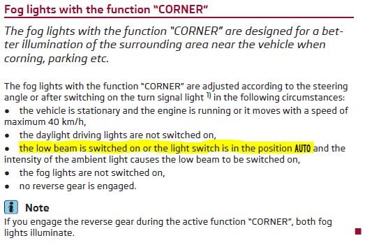

They will work in either 'On' or 'Auto' as long as the actual headlights are illuminated.

Cornering fog lights work on Superb 2 only if light switch is in Auto position.
So there is kinda possibility to switch them on and off.
I have a MkII Superb, the cornering lights work in both 'On' and 'Auto' on my car...

Hi all Linni, Kenny... between the two of you I think you've hit the nail on the head. I think my car just doesn't have them. Oh well. Won't lose sleep over it  :)
