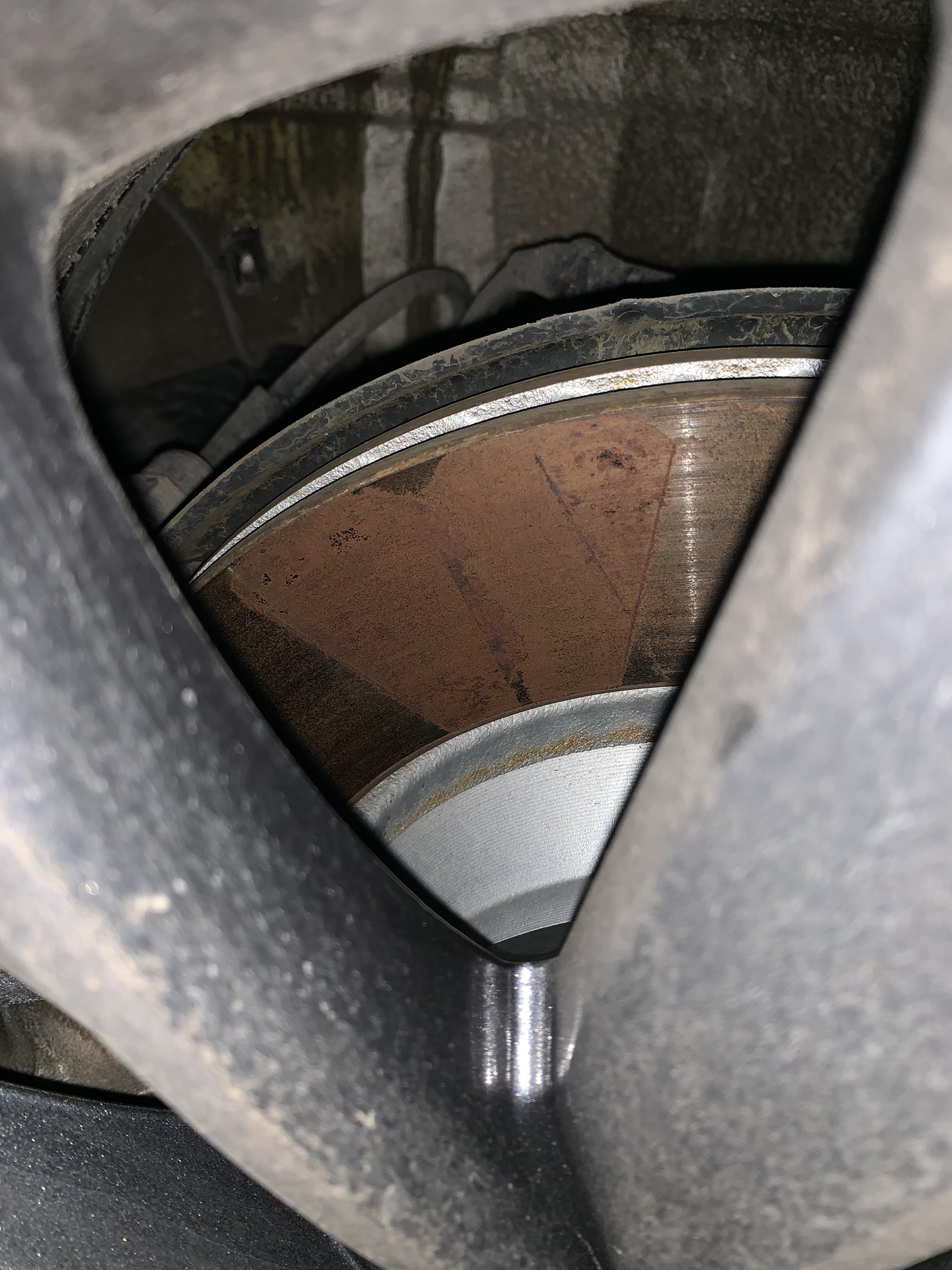

My discs in 2000 miles car are extremely damaged visially. Lot of vertical scratches and noise when braking. I took it to dealer they asked me to observe it apparently there is some issue with rear brakes but my vin is not on the list nevertheless if they will not get better over time they will replace them.

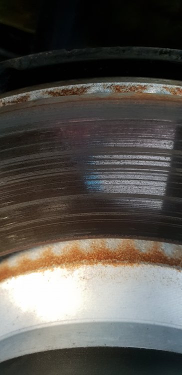

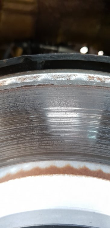

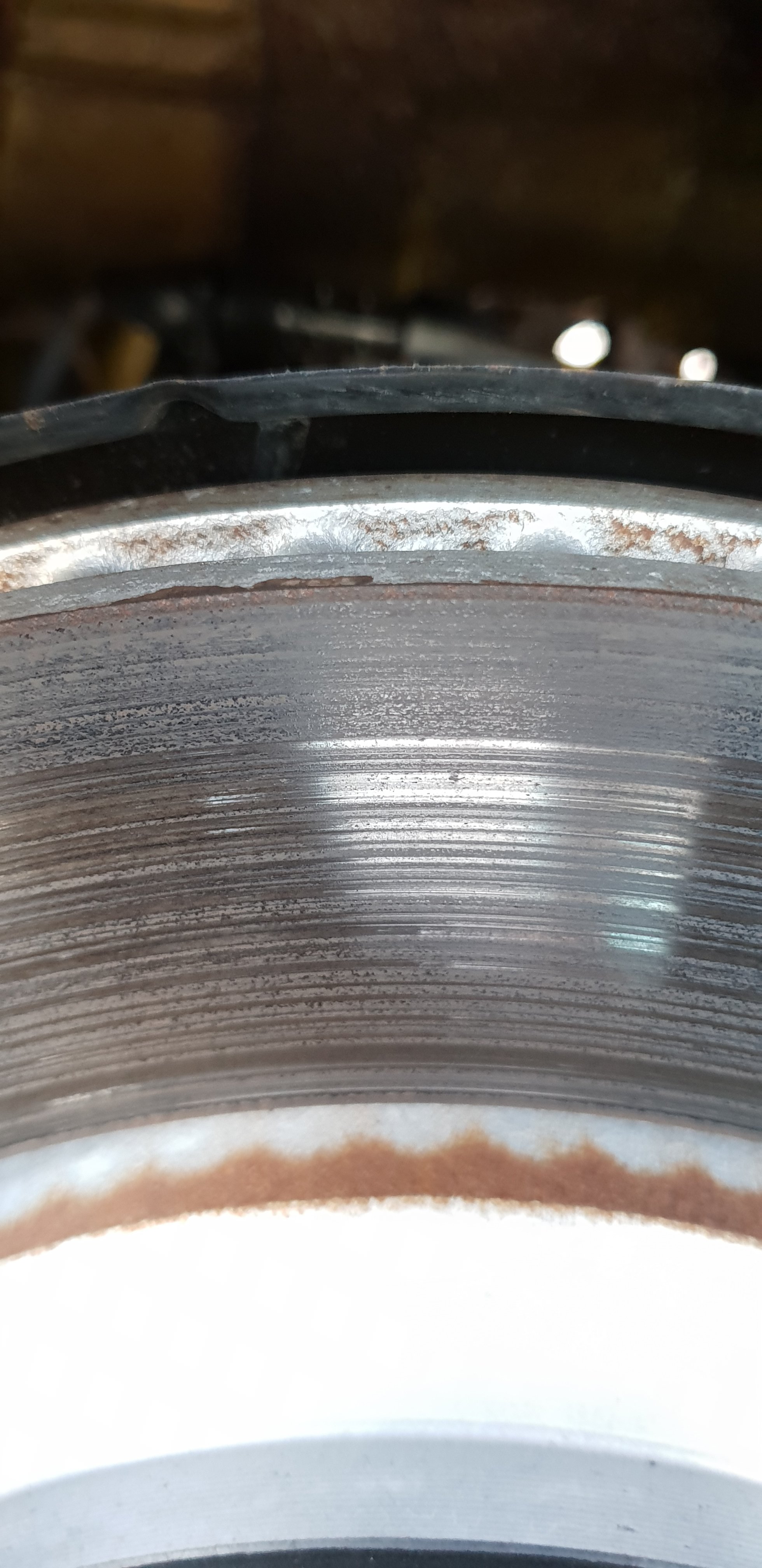

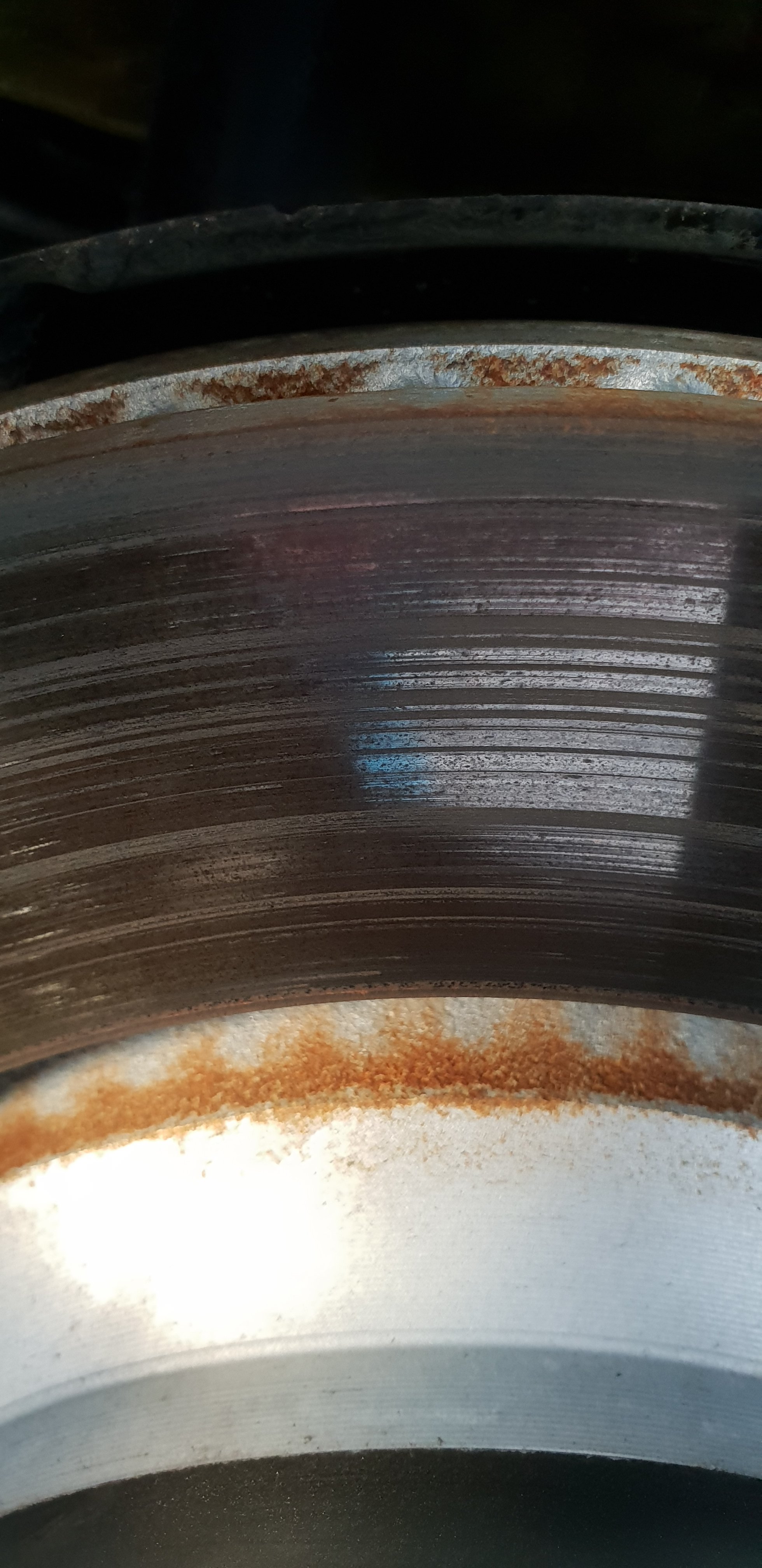

Just to make it clear, by worn/scorched you mean that the surface does not look "flat" or it does not feel flat to the touch?
I ask because here is a photo of my rear discs on the GTI, 26k km 2.5 years in, with Auto-Hold ON since the beginning:
Would you, by the looks of it, call this a worn disc?
Edited by newbie69
2000 miles.
these discs are made of butter

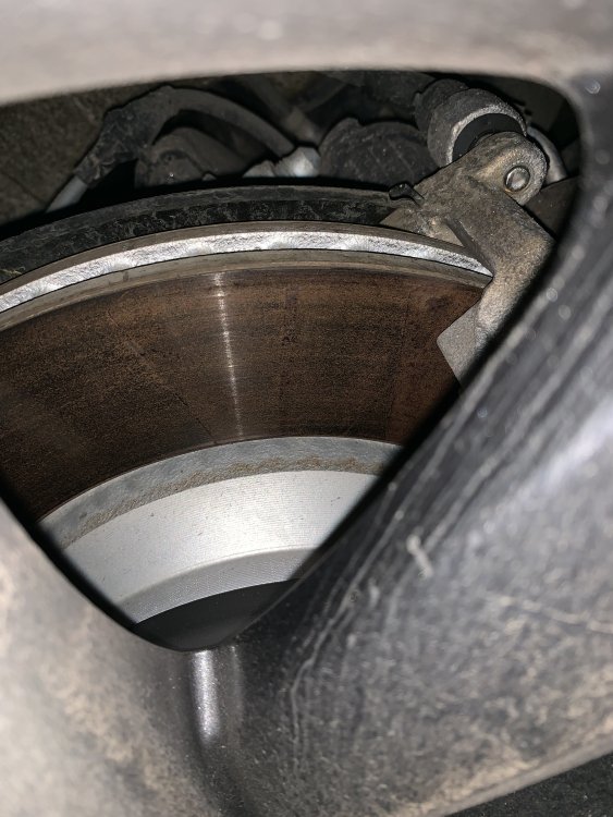

Here's my rears after 1900 miles. The fronts are fine. Should I raise this is an issue? Never seen it this bad on previous cars.
Edited by WeeDee
