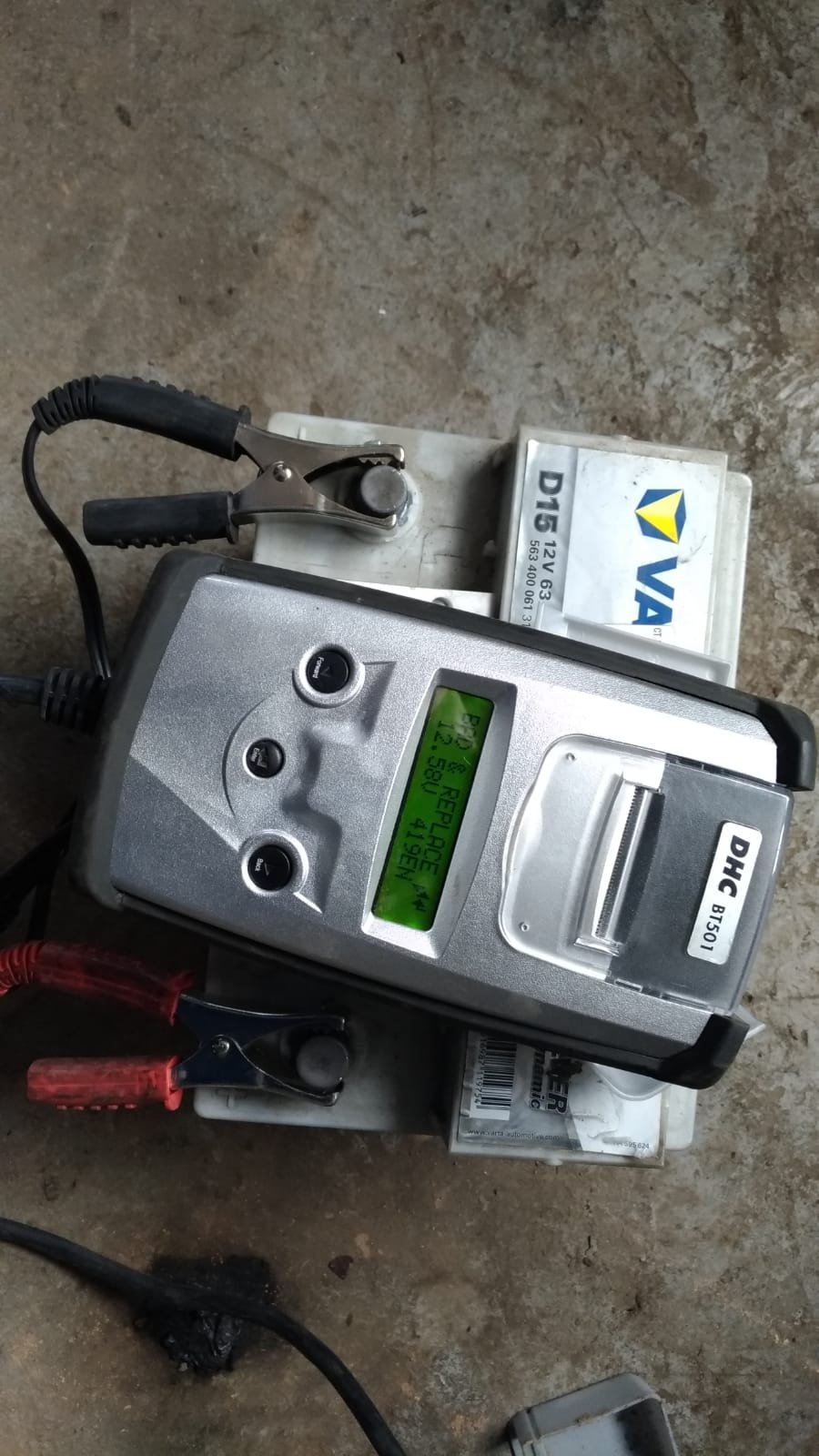

Do a battery test and decide. Mine was staring to  show signs of discharge over cold nights but started quite OK in the morning. However after 5 yrs tester suggested to go for a new one. It's not a hard decision to make.
