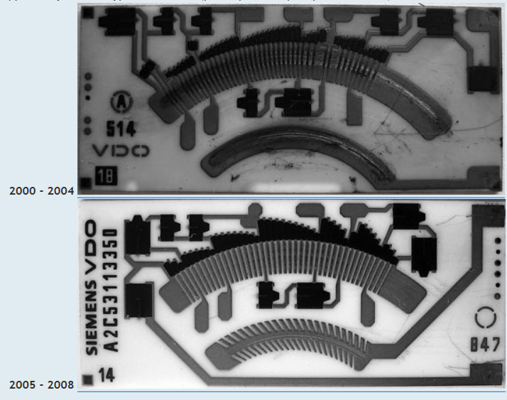

They changed the fuel gauge sender unit to work the other way around after about 2004. You would need the correct sender.
You can see here how they changed the resistance tracks. They are an almost mirror image of each other, which explains why the gauge would read backwards....
