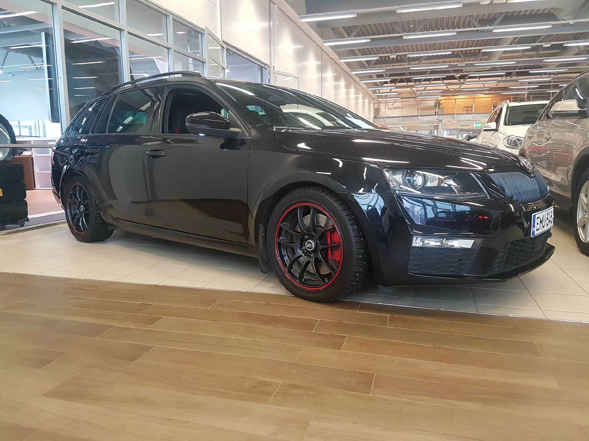

Lowered on 18s and 19s same H&R spacers and H&R springs. no issues at all after 9+ months, no rubbing on the 19s or crashing in pot holes etc.
spolier12.jpg.3ba94404b637342cd2aeccbec042957c.jpgon18s.jpg.86d6512c0df6b92b612b3fdda7aaa0aa.jpg

How much did you lower this?

standard 40mm all round, the (vrs springs are already 15mm lower, so an extra 25mm but closer to 35 in real measurements)
Skirts do make it look lower

Hi what size spacers are you using? And how easy was the side skirts to fit? Sweet car btw!
spacers are 15/20 front/rear, skirts took 10 mins per side on ramps, on the ground it would be much harder, i would buy rieger side skits next time though. these are too brittle. thanks for the compliment. looks alot different than the poverty spec i bought it as.
