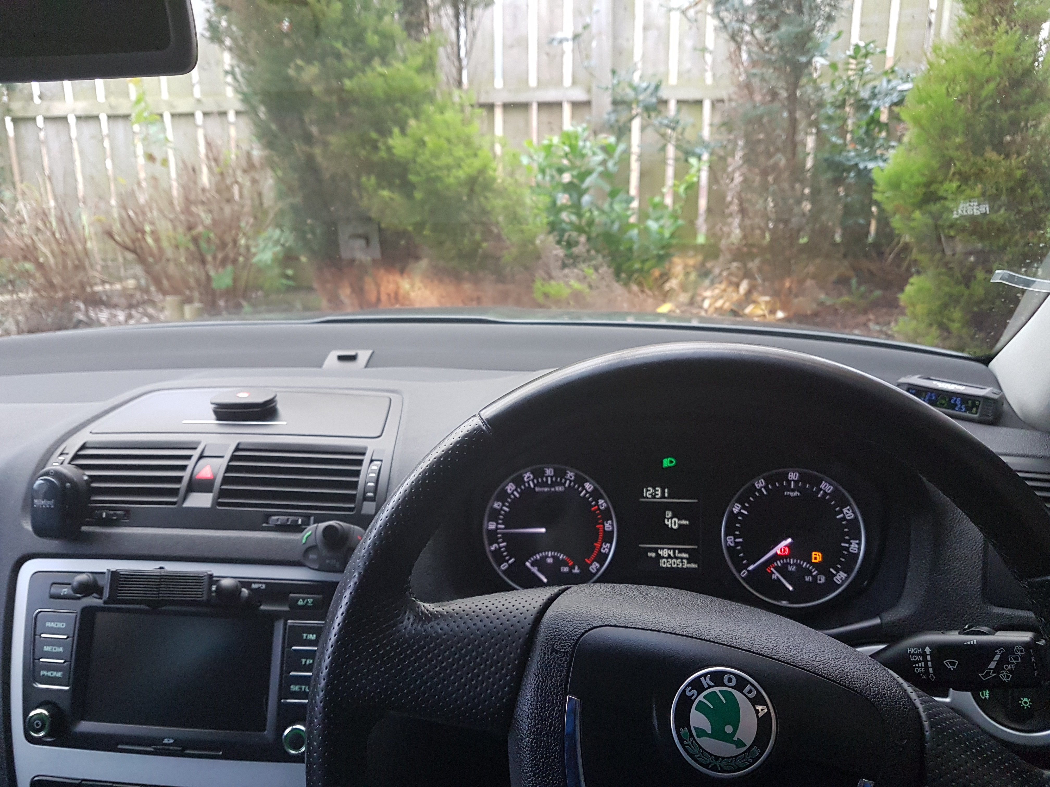

This is my dashcam (behind rear view mirror), TPMS, phone holder (it's located in the CD slot), Tomtom (dash top cubby) and Parrot phone set up in my Scout
