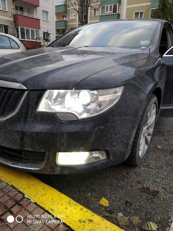

Hello dears,

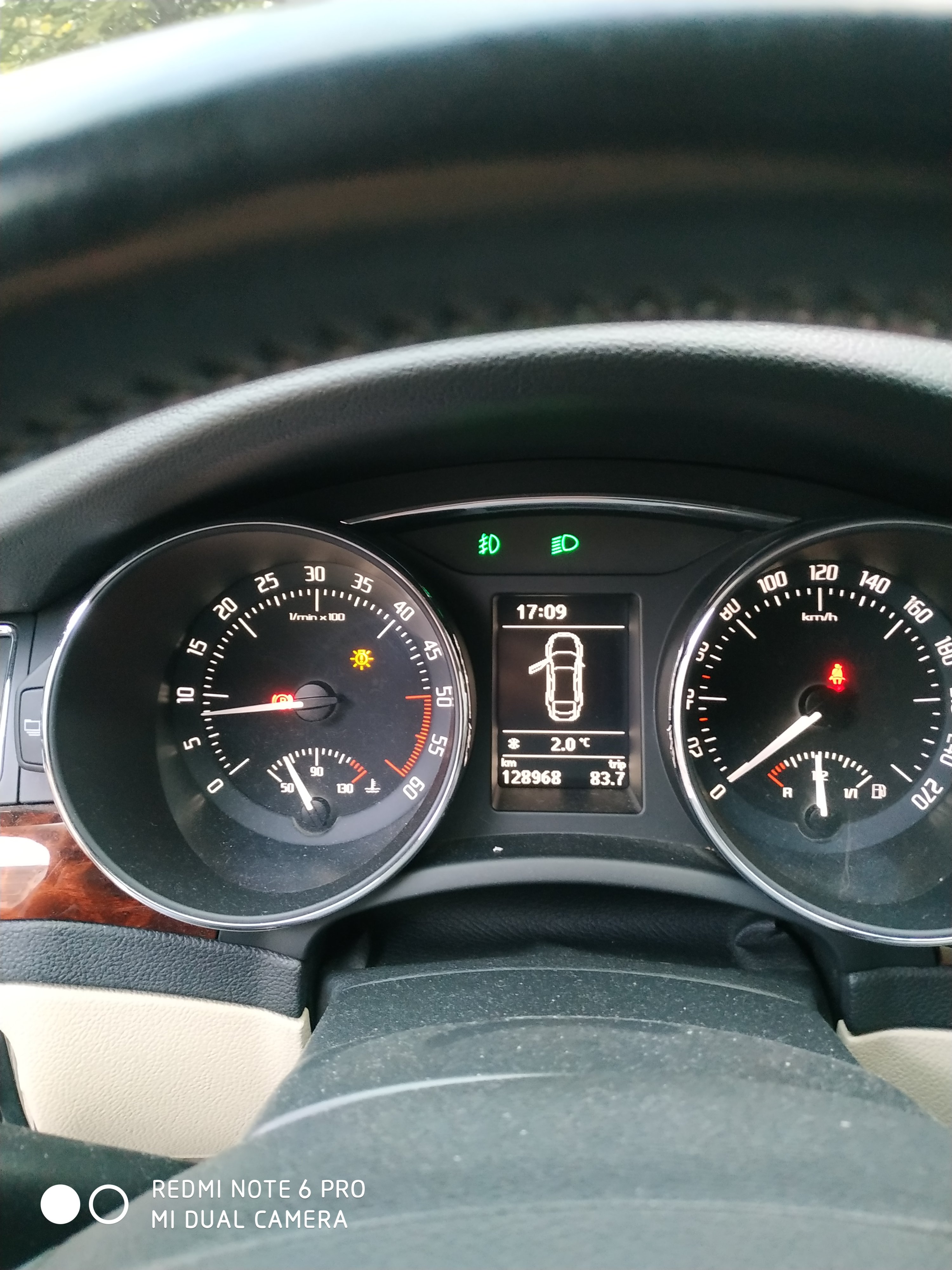

Today I have changed my H8 fog ligts bulb to led one, light and lumen was great but I've got an error code, do you have any advice what can I do for solving this problem.
Options:
1)  Vcds coding (if it is possible)
2) Try to use load resistor about 40-50w
3) Buy a new led fog light bulb suitable for can-bus
Thabk you so much.

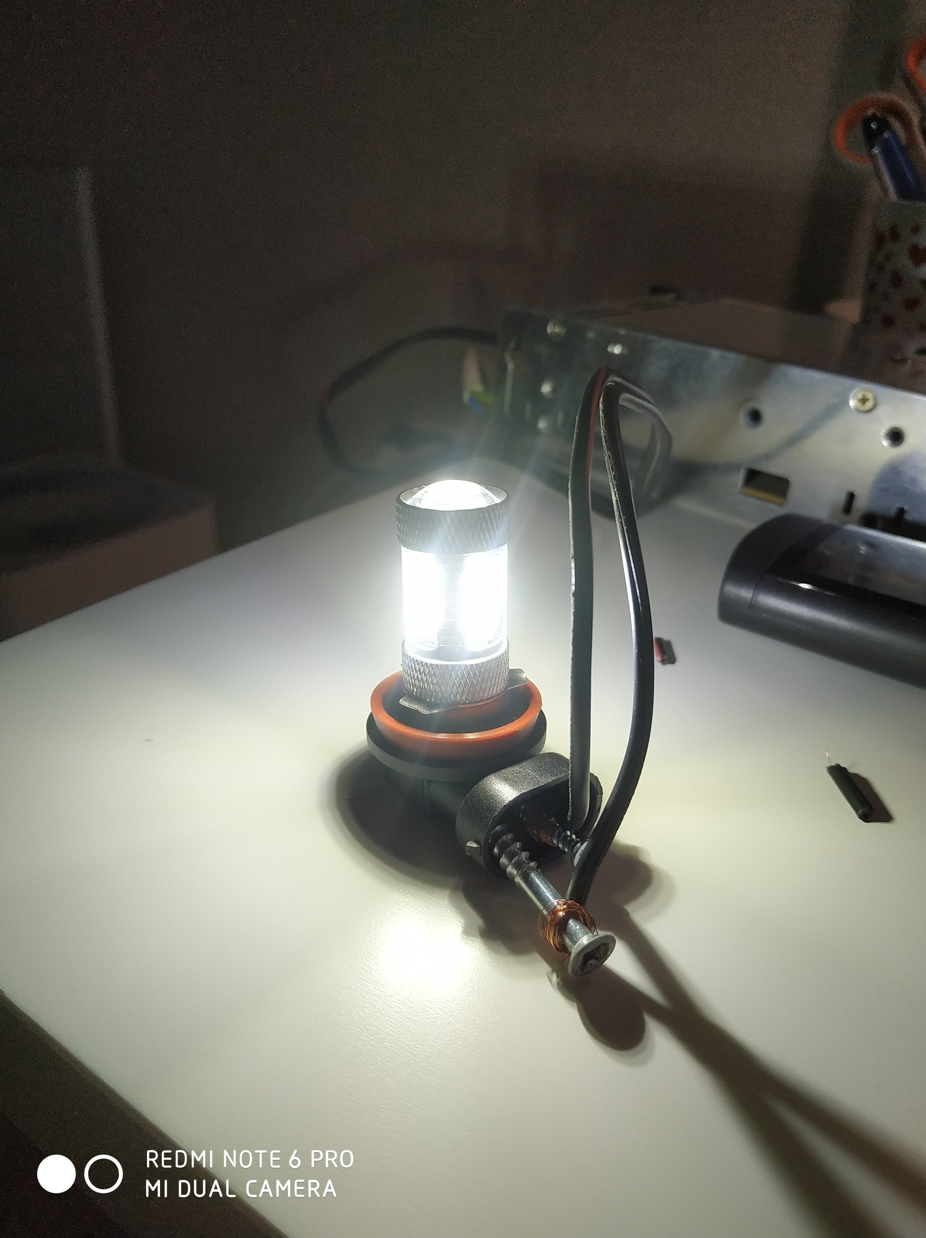

My h8 fog light bulbs :
https://www.aliexpress.com/item/2x-H8-H11-30W-CREE-LED-High-Power-Pure-White-6000K-Fog-Tail-Headlight-Bulbs-Auto/32566731161.html?spm=a2g0s.9042311.0.0.38b84c4dkAZu1i

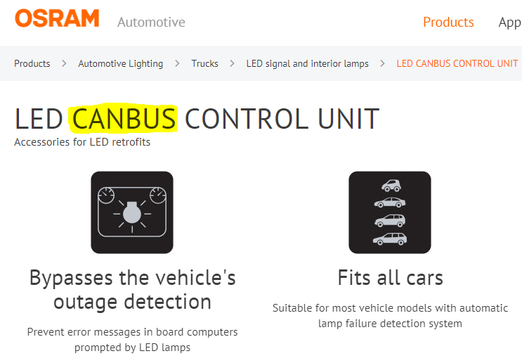

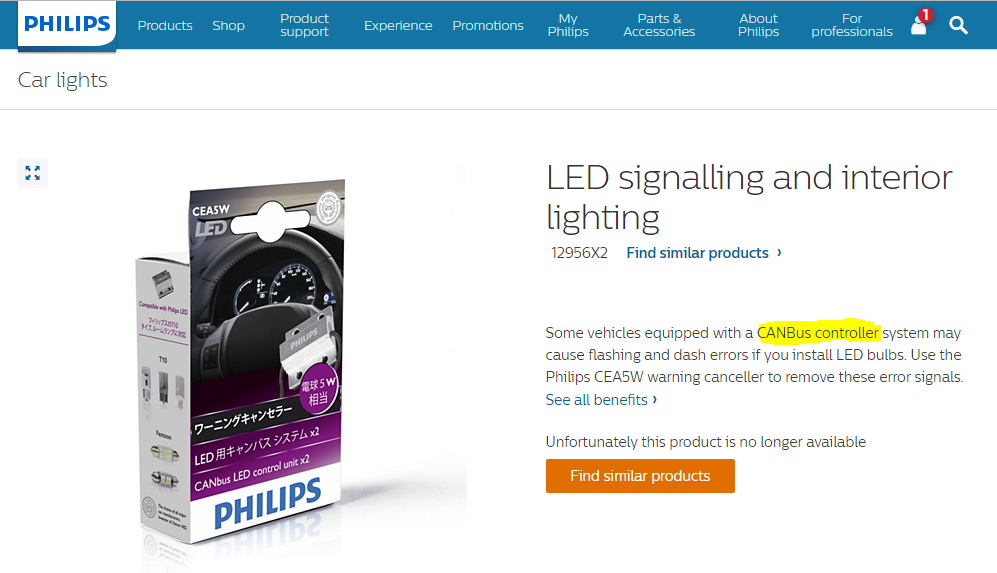

To retrofit LED bulbs, HID kits, or any other electrical lighting load outside of the bulb monitoring systems parameters they need to be 'CAN-Bus Friendly', a common term to describe lighting components with built-in capabilities that fool the CAN-Bus into thinking the regular bulbs are fitted.
You said it yourself, the CECM relies upon the CAN-Bus to control the blown bulb warning on the dash.

But hey, why should we ignore all the major LED bulb manufacturers.
Oh, and leave the foul language on your side of the keyboard where it belongs.
When you say 'error code' do you mean a fault code that you've read using a fault code reader, or are you referring to the blown bulb warning light on the dash?
Yes sir same warning

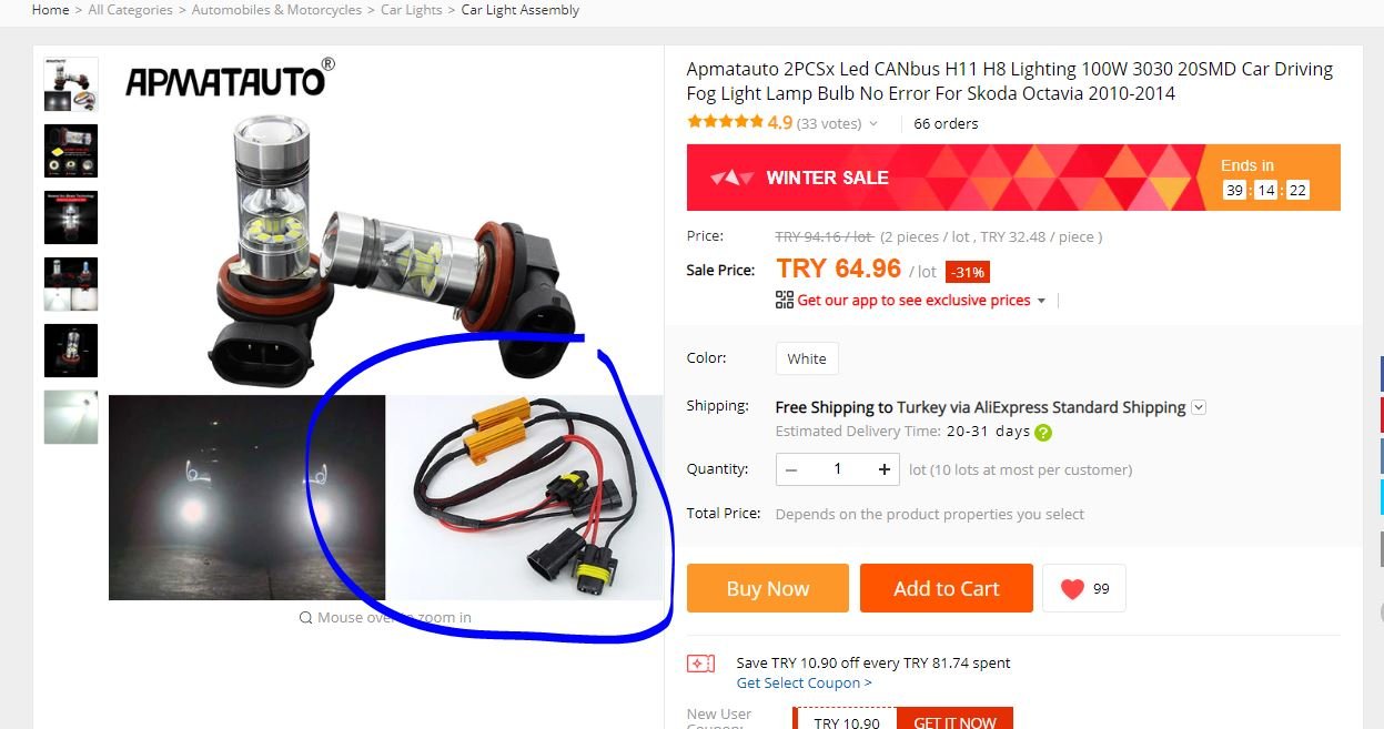

And you definitely used this resistor kit?
Yes sir I have ordered that one but not apply yet. I have deciced because, I saw that resistor link below. they used h8 led bulb with this resistor for skoda
https://www.aliexpress.com/item/Apmatauto-2PCSx-Led-CANbus-H11-H8-Lighting-100W-3030-20SMD-Car-Driving-Fog-Light-Lamp-Bulb/32877157802.html?tt=Copy+to+Clipboard&aff_platform=default&cpt=1547916316885&sk=biHBM3OY&aff_trace_key=94c5c88e08de43e29a9e86829353cc7a-1547916316885-08765-biHBM3OY&terminal_id=46c145ace16245bda2e8eed50f2878af
I wish I were apply this resistor, the fault code will disappear
Edited by sinfulAngel
Ah, that's your issue then. I thought you'd already fitted the resistor kit and were still seeing the blown bulb warning.
After you've fitted the resistor kit you should be OK.
Just make sure the resistors are specified to cope with the electrical loads, and as they get hot during use be careful where you mount them.

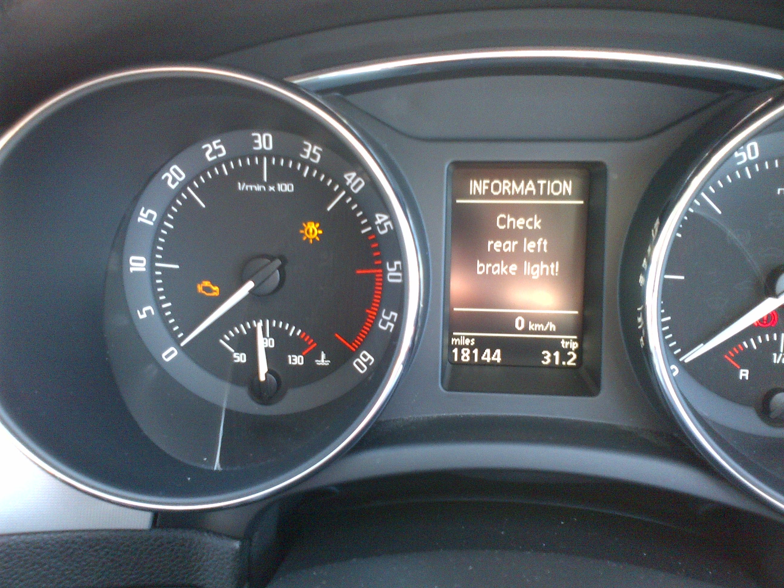

This relates to the rear lights but you might find some of the content useful...
