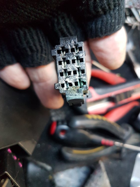

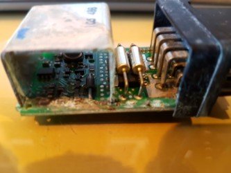

Thank you silver 1101. What a nightmare to get it out. found corroded plug / socket connection so cleaned up and tried again. Still not mworking so removed and dimsntled unit. circuitry ruined by water ingress, see pics. Unit is located under front passenger seat towards the door. I had to cut the carpet to get to it and remove the oblong plastic which holds the sockets for the heated seat and the air bag, ( the module slides out downwards from this housing) . ( I also had to cut away the front section of the plastic tray which carries many wires for and aft and is right over the control module, it helps to gather the wires in a couple of tie wraps ). Also need to remove the four splined screws securing the seat and tilt the seat back. Hope this helps anyone else with nthis [plroblem.
