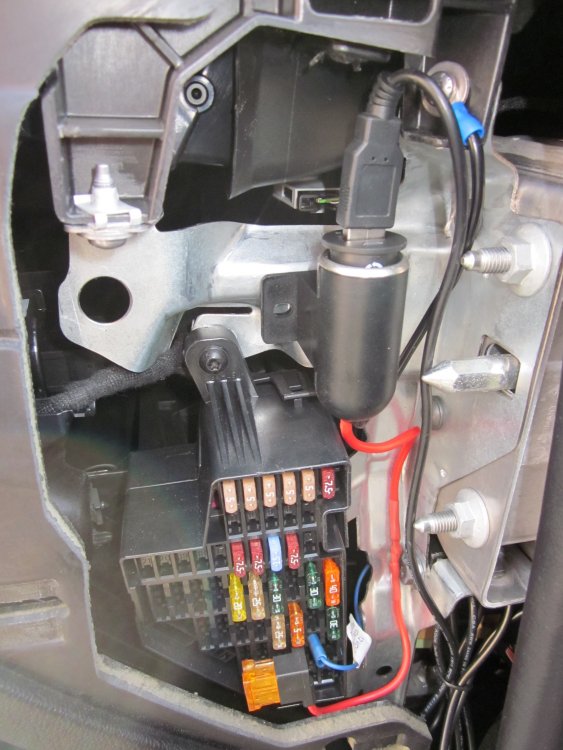

Didn't you post about having the same problem with a new entertainment system recently? Langers2k gave a solution and like that issue, you need to solve this the same way by using a switched power source.
Have a look at silver1011 post in this thread: Fuse to piggyback a dashcam switched supply which has a picture illustration this.

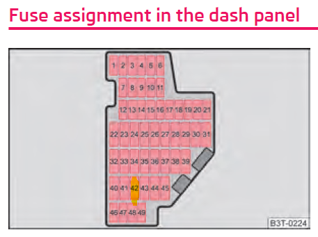

On my UK-spec car I used fuse #42 - Light Switch.
Fuse #39 (Rear Wiper) and #38 (Heated Rear Seats) are both empty on my car, and are switched live (i.e. on/off with the ignition).
Sounds like a good pair of fuses to test! Thanks!

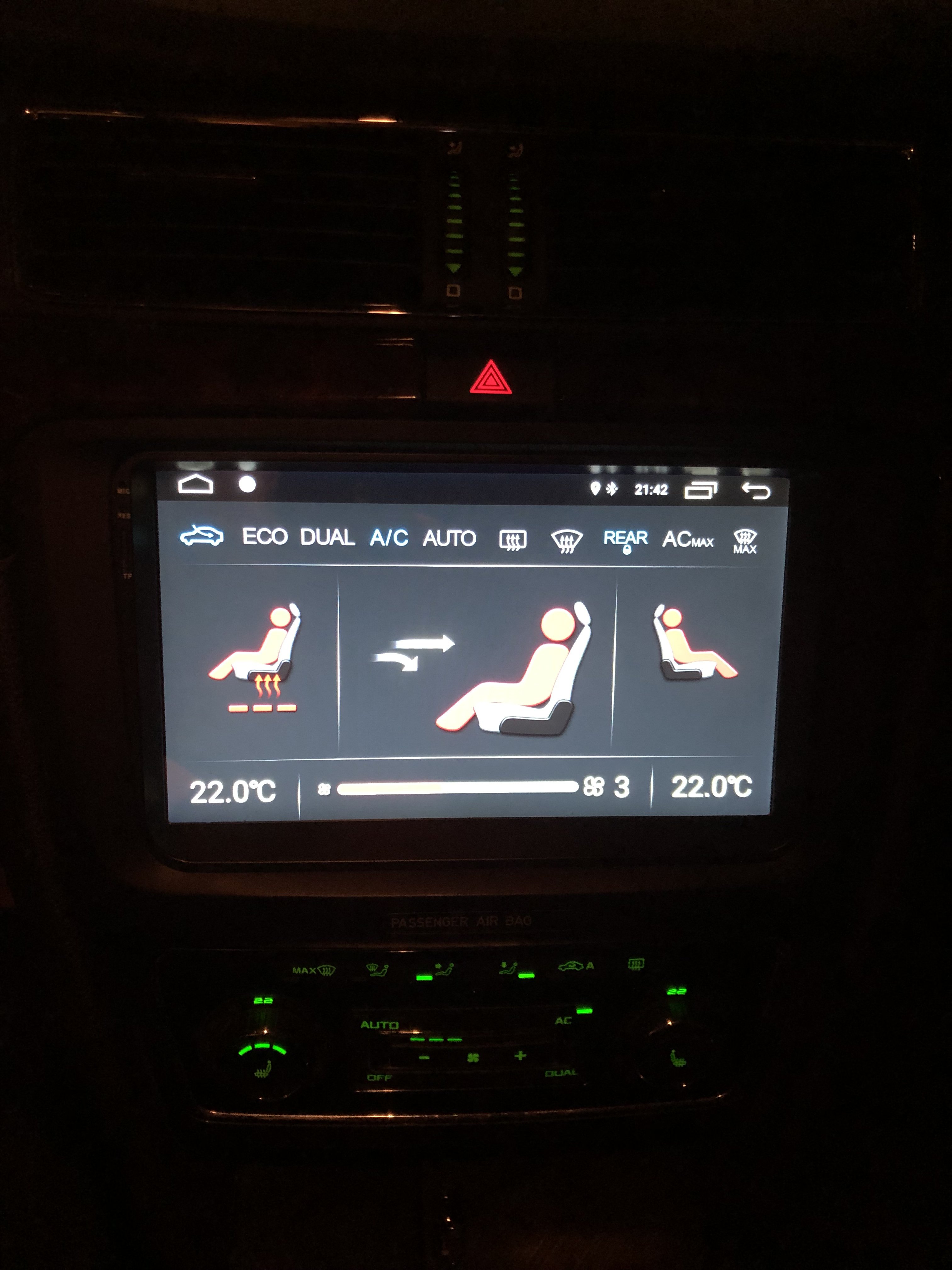

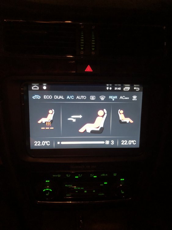

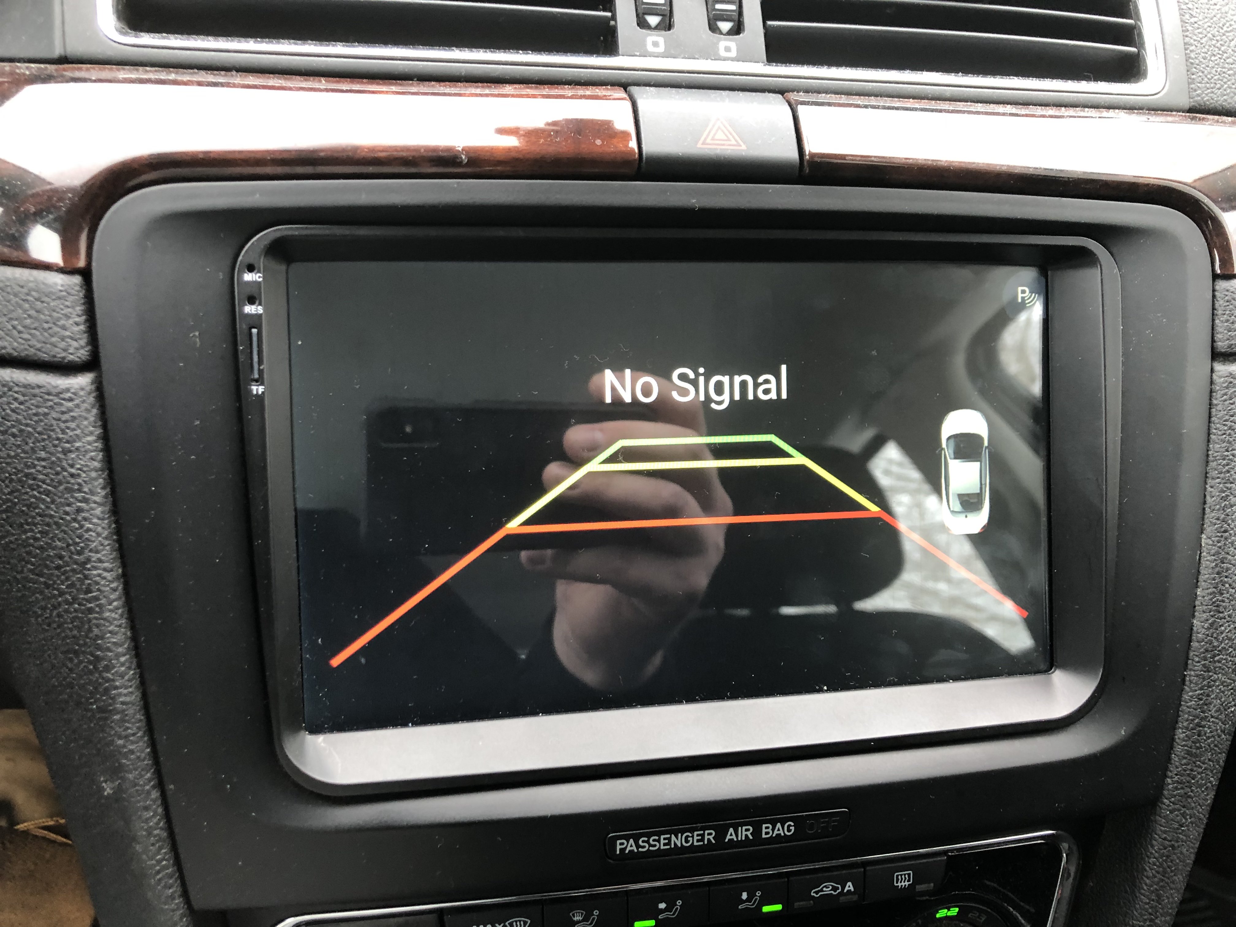

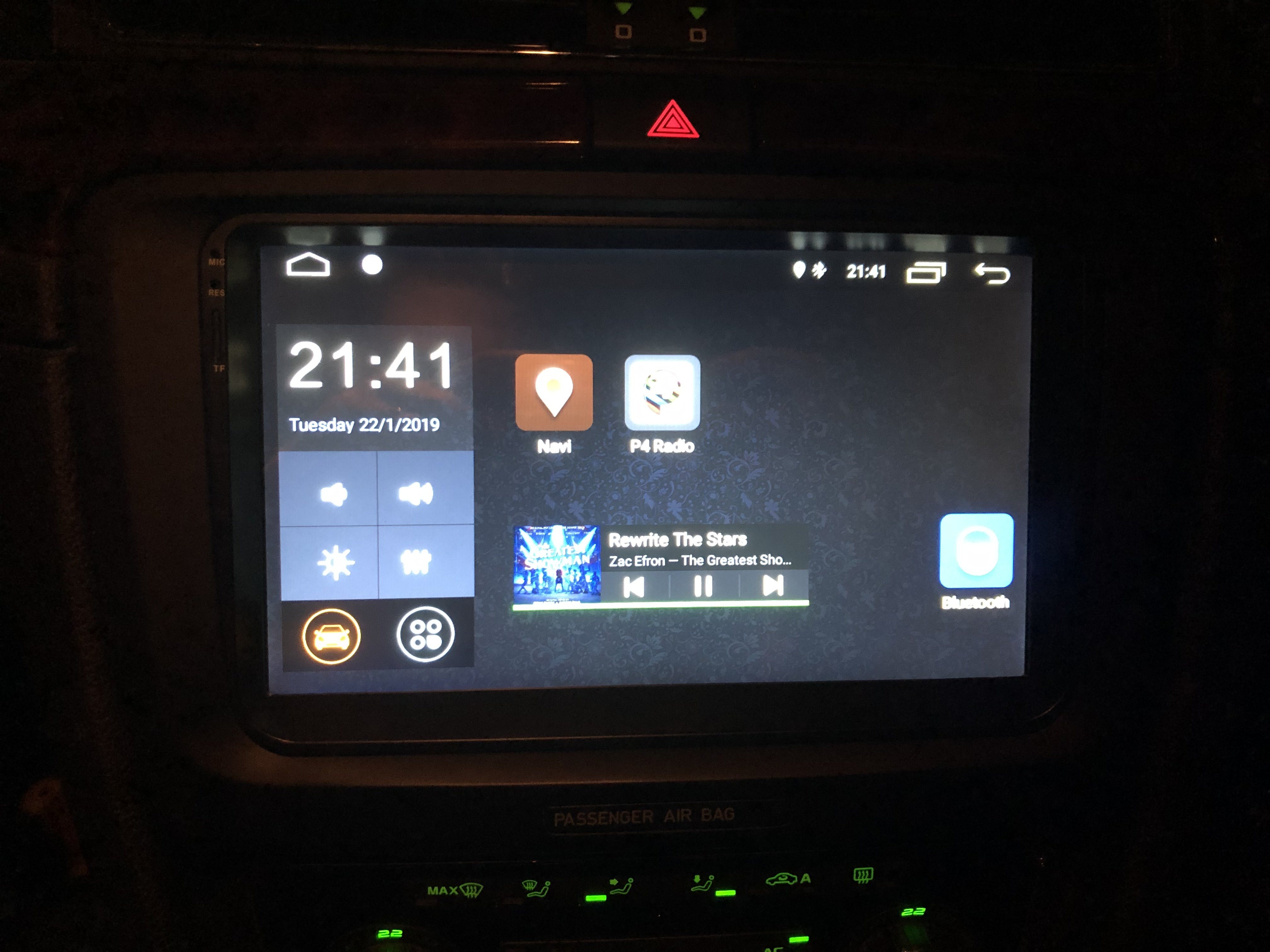

Very happy with the new setup!
A whole lot better then the standard setup
What unit is that?
I see you have climate display but do you still have maxidot information etc?

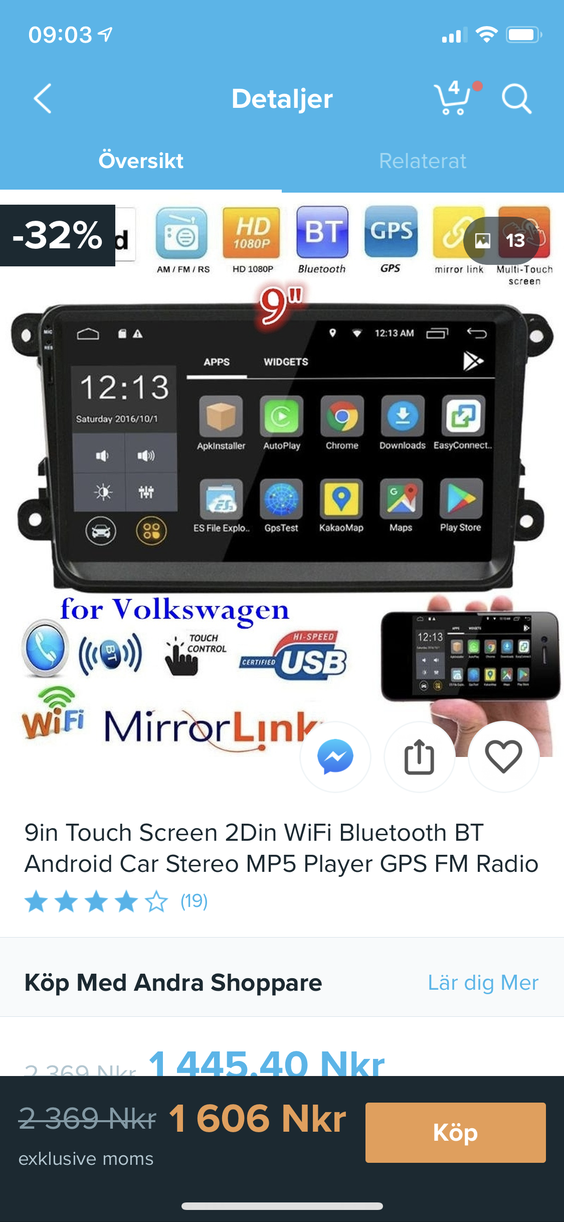

Changed it mainly because off the BT and CD-player didn’t work. So got it of wish.
Maxidot Information, thats the MFD between the speed needle and RPM needle?
Haven’t installed the camera yet

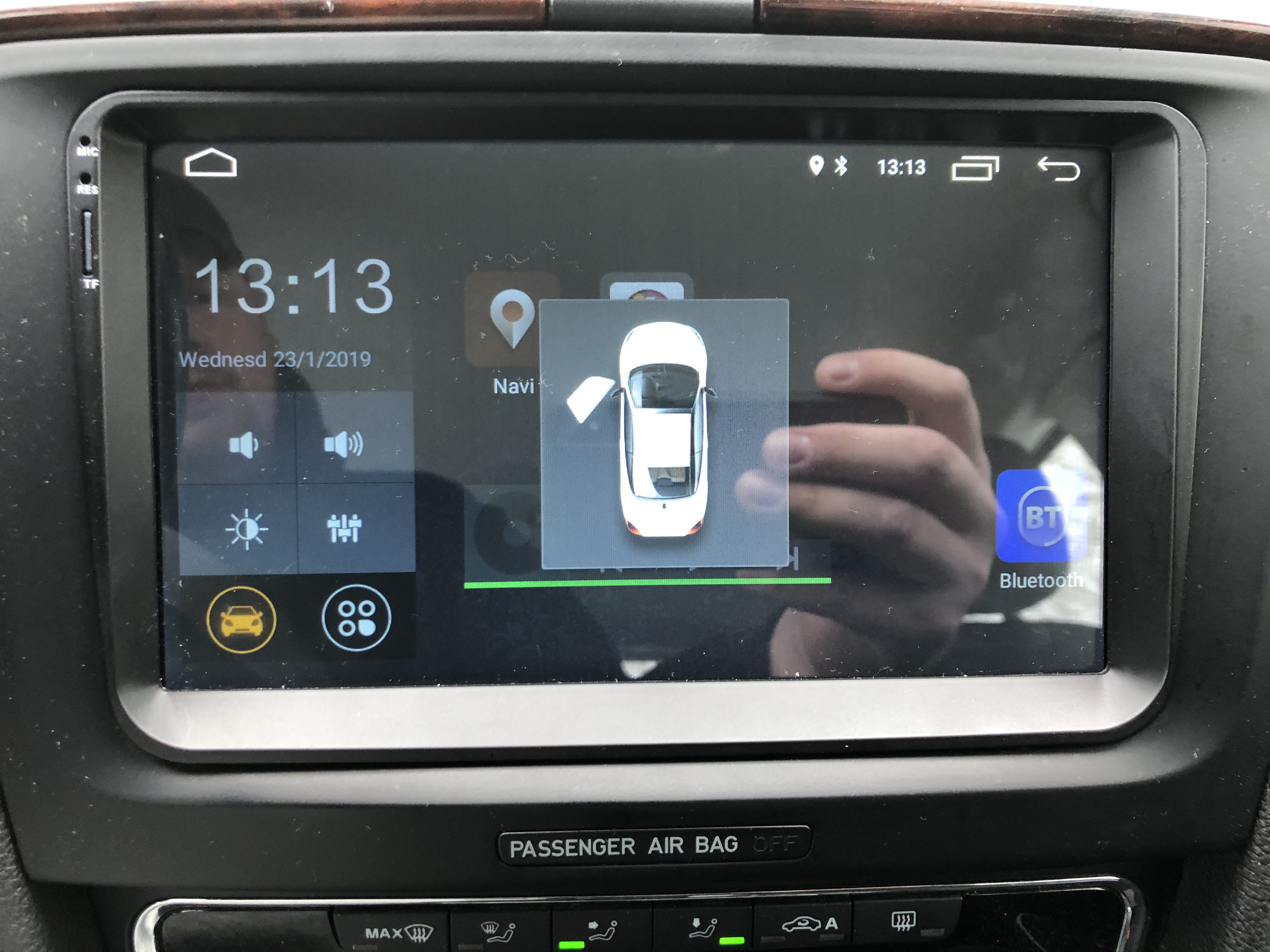

Looks quite smart!
I love it, very sturdy unit despite “cheap china stuff”. Handled -26°C with no problem at all so this is good stuff!
