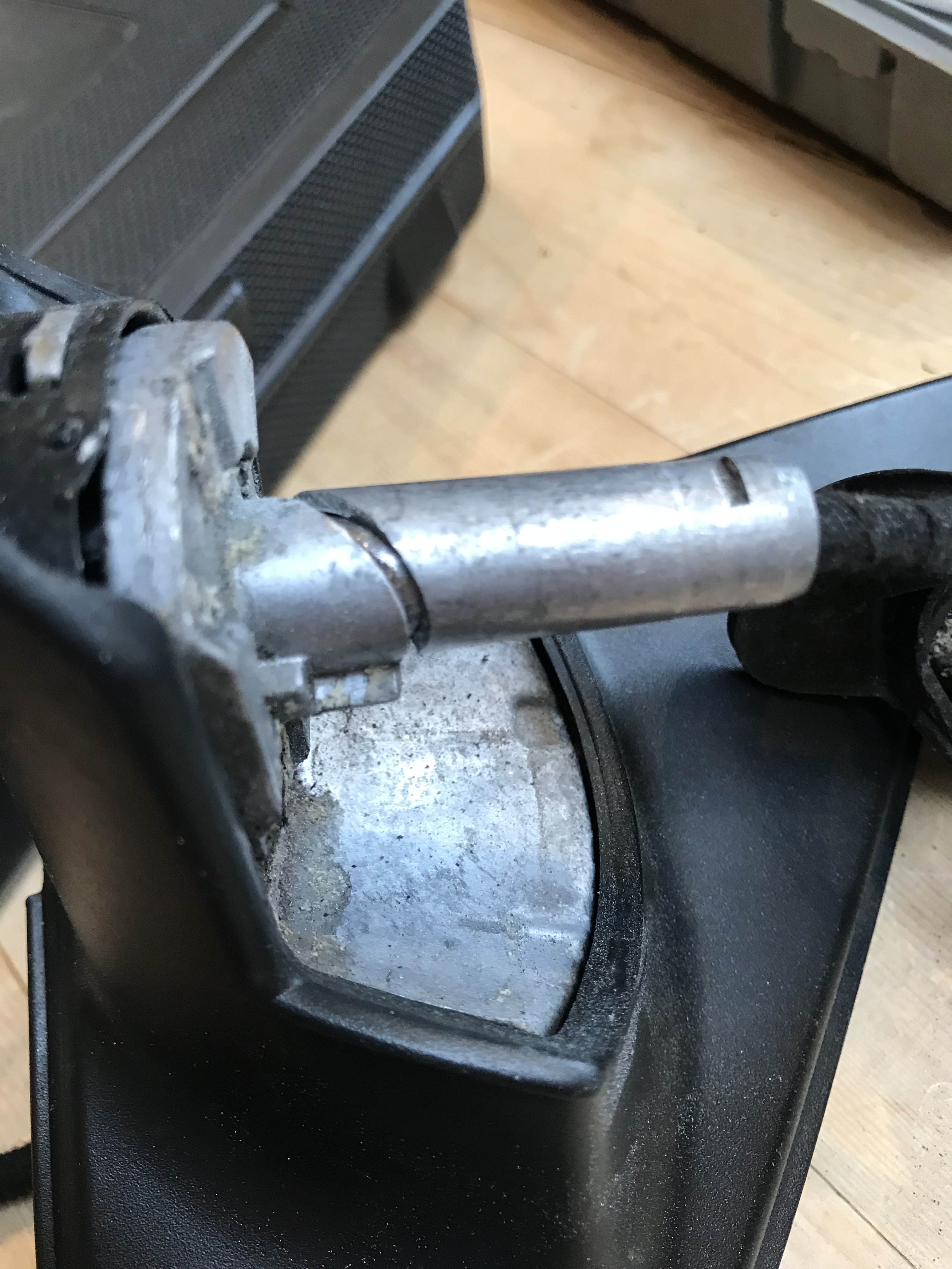

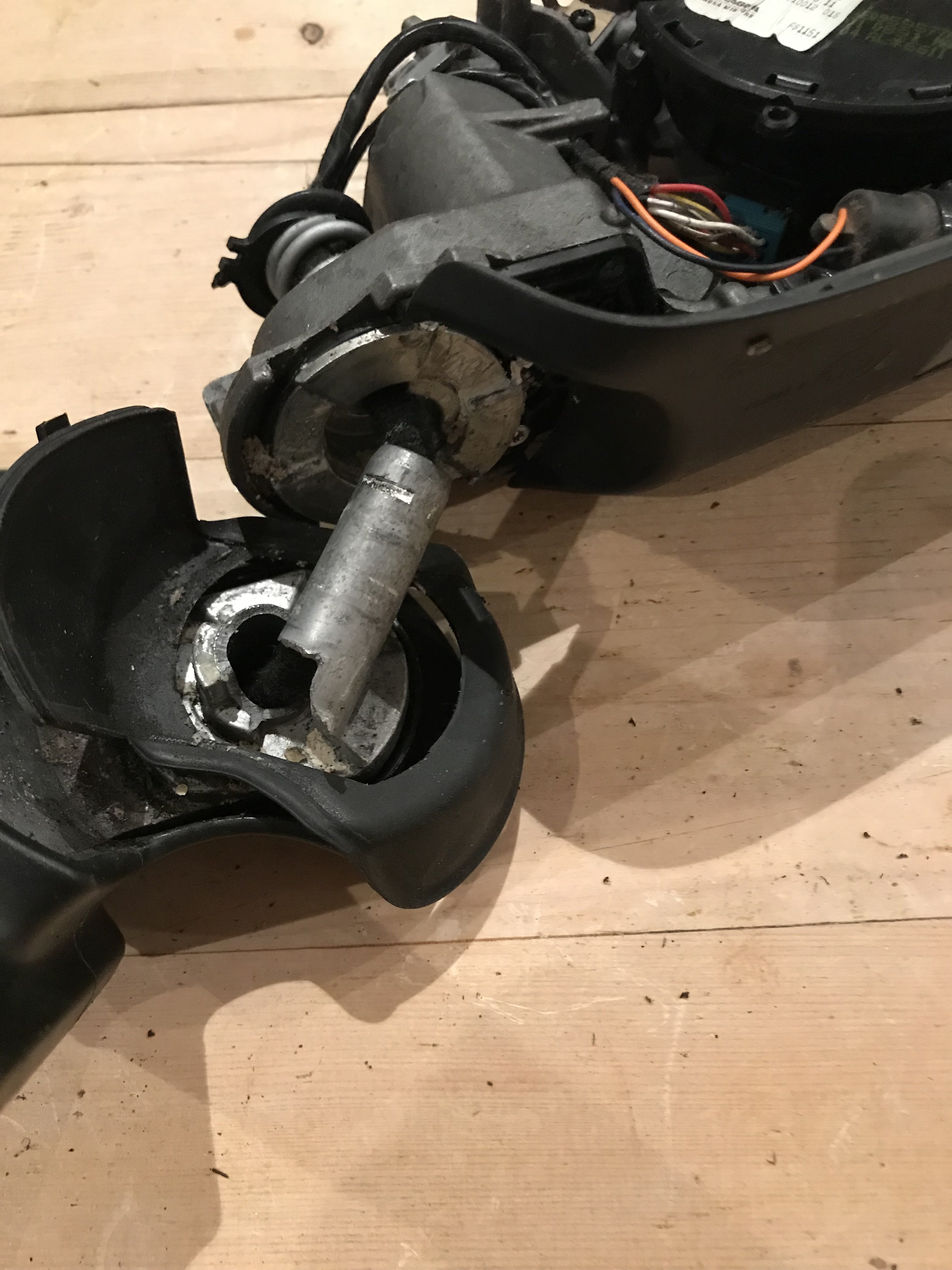

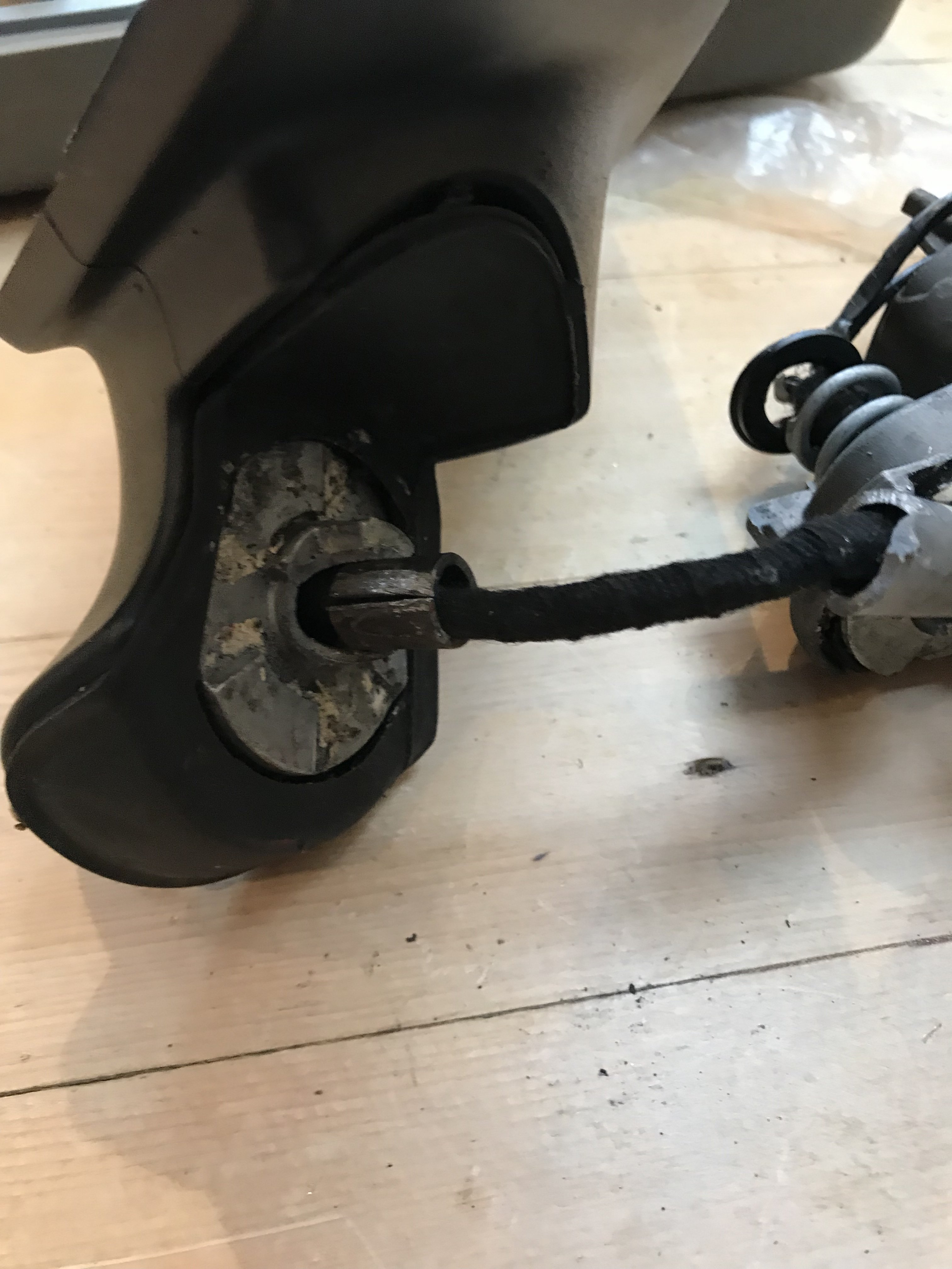

first the damage: the main case was cracked, but repairable. The indicator was beyond repair as was the mirror, but the main thing was the casting inside the mirror. It was snapped clean off and didn’t look repairable.
Initially I thought about TIG welding (it’s aluminium) but that would mean taking apart the wiring for the unit to get it out first. Therefore I decided to make a steel insert. I got some steel tube, cut it to slip over the wire and the bent it round. I have some experience doing similar things so was able to get it pretty round and fit perfectly inside the casting (pic 2).
I made it to be an interference fit hammering it into the casing first and then after coating with jB weld, hammering it home. Pleased to say it dried really well, straight and strong.

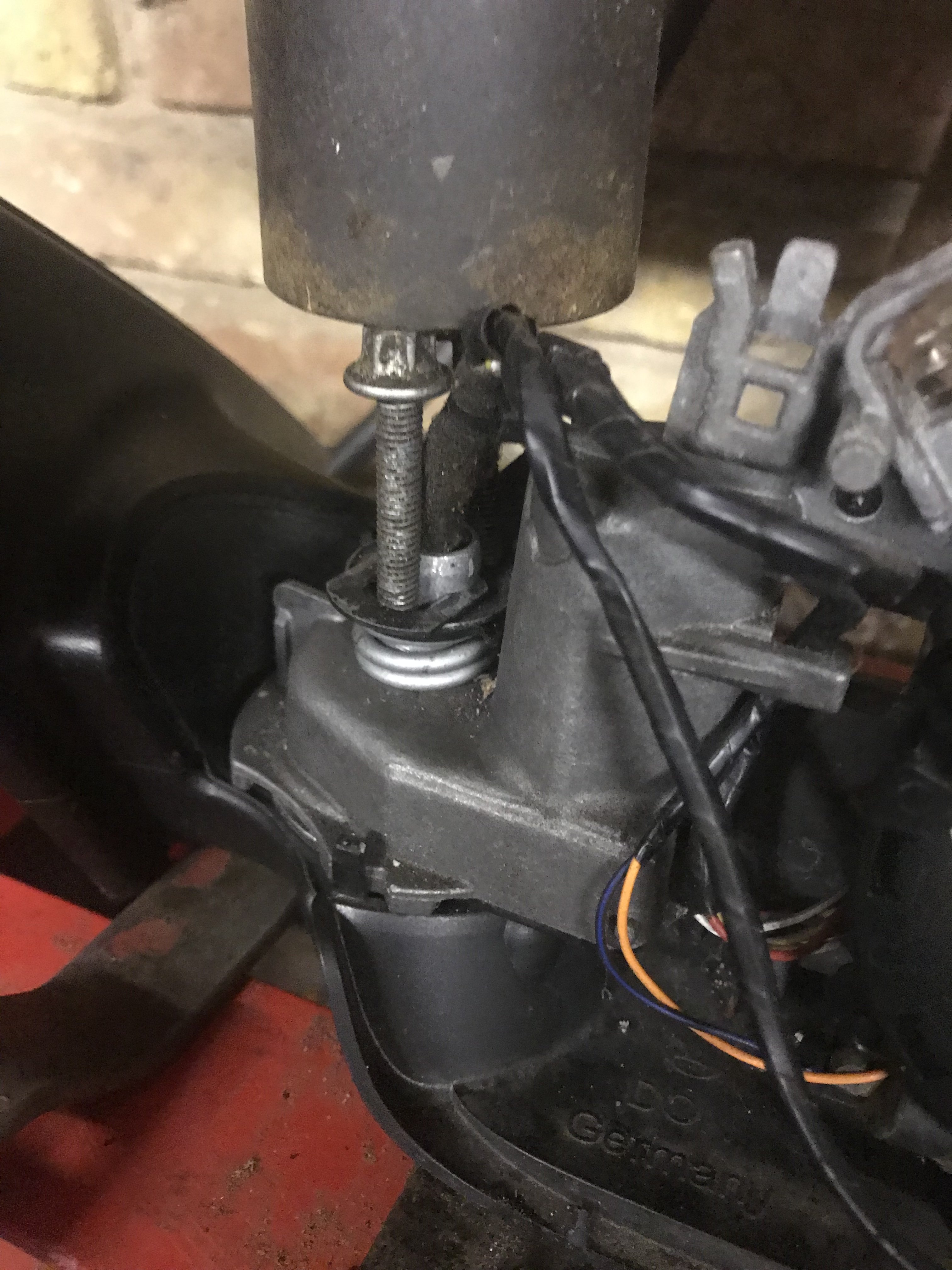

You never quite know how well the repair will hold up until you put it under load and believe it or not, the wing mirror mechanism is under quite a lot with a spring mechanism. I am sure vag group have a special tool, but I had to rig up something on press to hold the spring in whilst I put the circlip on. Warning here, I tried a few things including valve spring compressors, g cramps and a bit of brute force. Nothing came close to getting it done hence using the press. (Will post a pic)

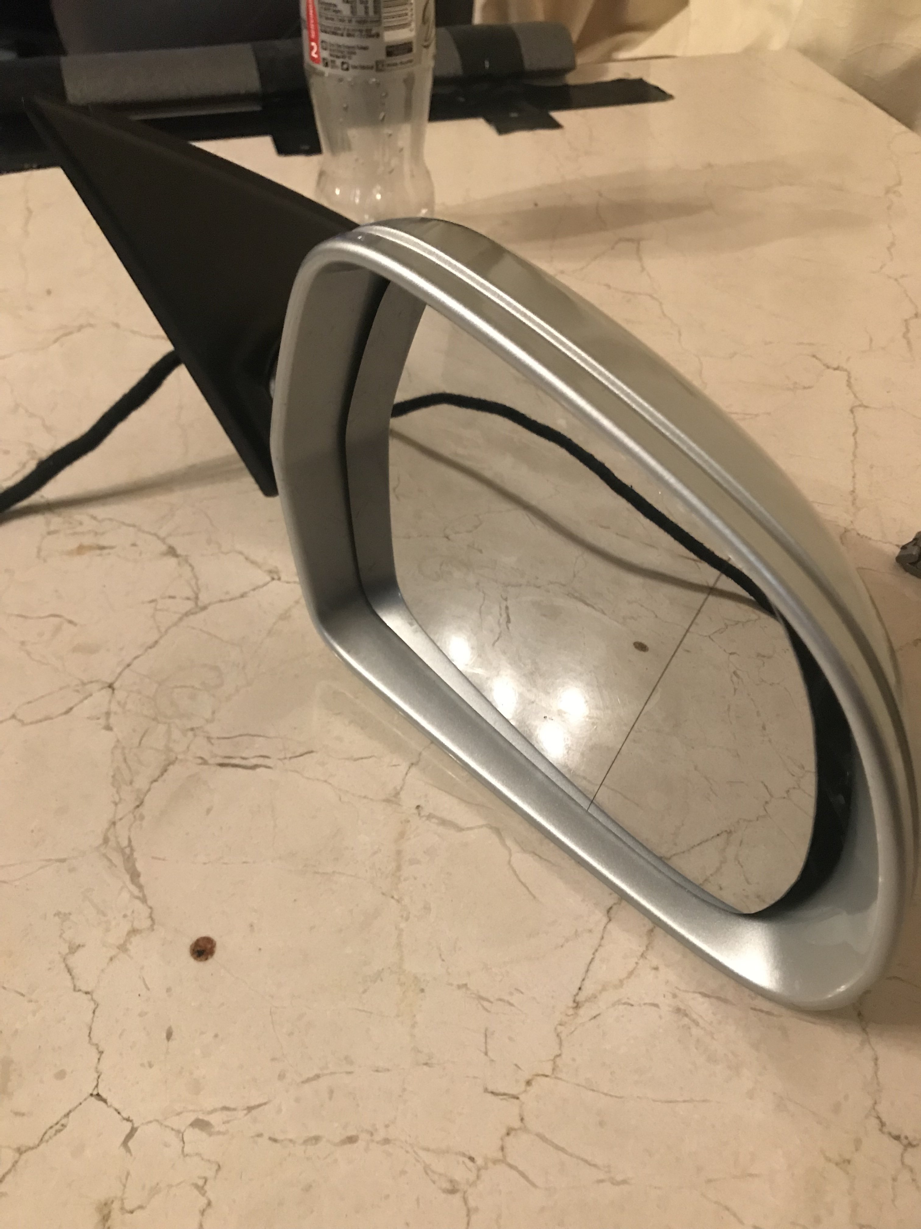

So with a bit of remedial work on the case, and a new indicator and mirror (25 quid off eBay) I am back and running again. Quite a simple project once it was worked out, which is why I thought I would post it in case it happens to you.

The follow up press pics and end result.
