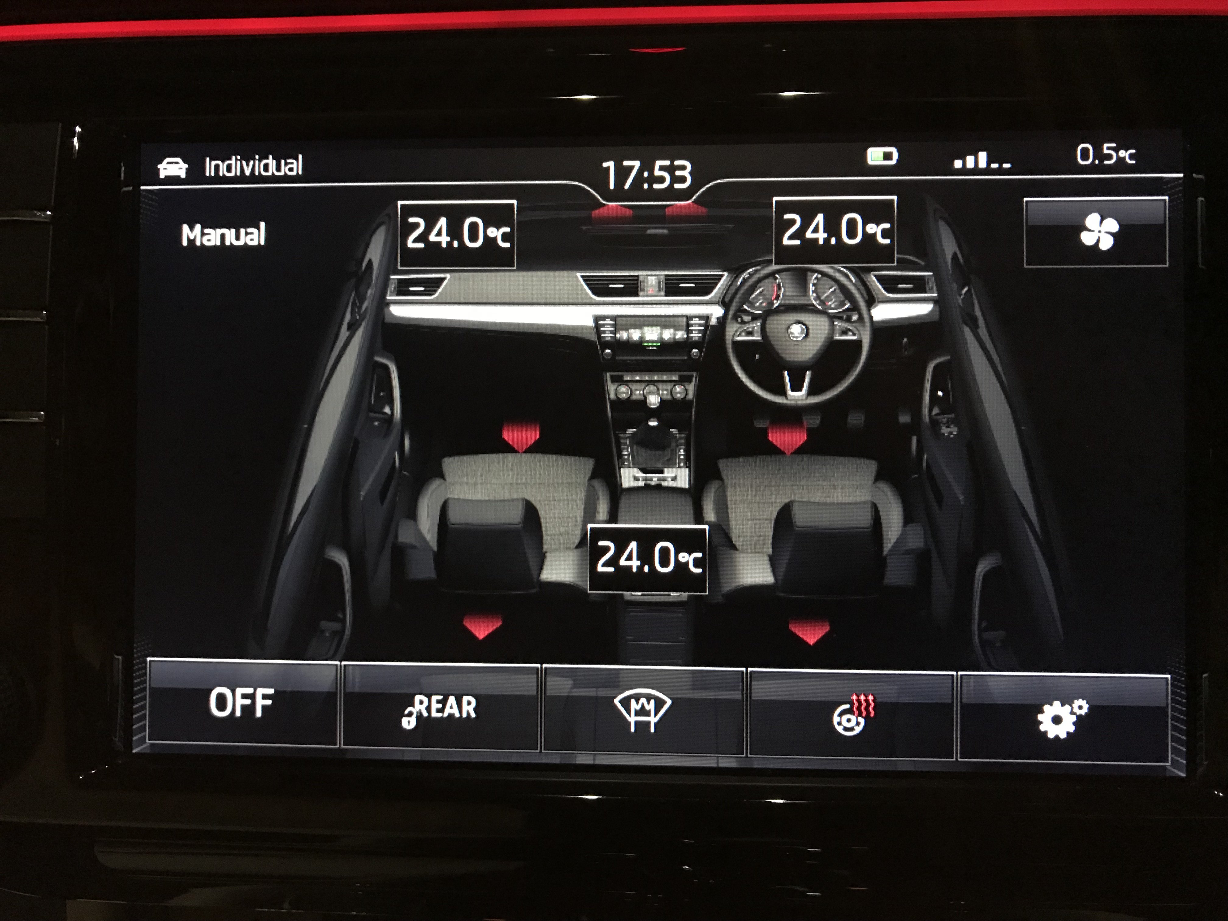

As above, it will definitely need coding, so that the option to turn it on and off is enabled via the infotainment screen*...
IMG_3041.jpg.160972e6c28430a7c02f2b99120a119c.thumb.jpg.c6bd2ad66133c395d5c3451c4c497c0e.jpg
* this isn't a view of the Kodiaq screen, but you get the idea.

So finnaly  without problems with coding,,,,if i will order retrofit Heated Steering Wheel
