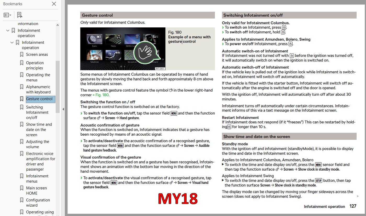

I think the 'Gesture Control' you mentioned is more accurate - in which case I think I found a post here relating to MY17 and MY18 units + page from manual attached.
Think I read it shows how to enable / disable the feature, even though it's for Superbs :thumbup:

I'm off out to my car now to see if this works - thanks for that.

Aye - that appears to have done it :)
Playing music on the way home and at every opportunity I was waving a spare hand around and in front of the screen and there wasn't a single track skip in any direction.
