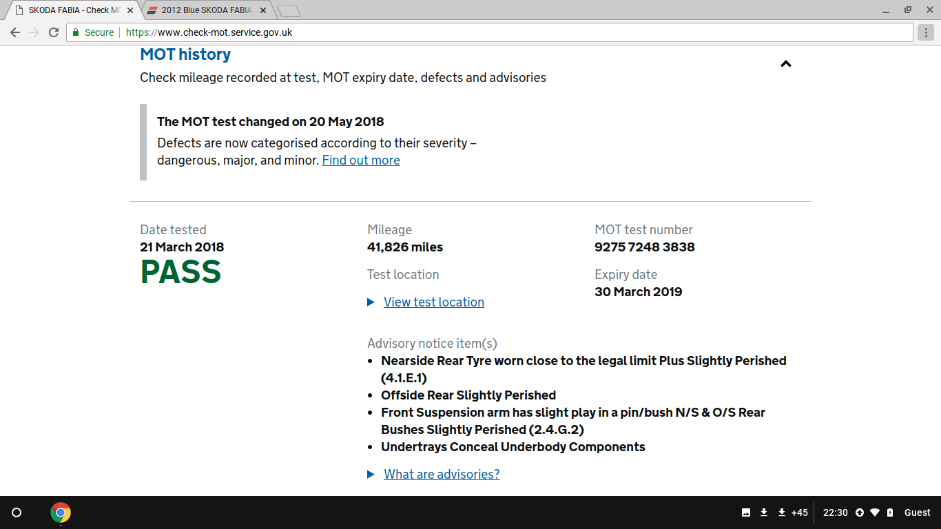

Are they not MOT'ing it?    I looked at last years advisories on the MOT.
I would want that work done if not done already, and a new MOT. Or you need to budget for that being done.

5 minutes ago, Skoffski said:
OK.
Thanks. Very good point. Hadn't looked at the MOT history but have now! If I like it I will ask for a new MOT - not long left on the present one...
Edited by cosmicjazzer
See how it goes.   It is only their asking price anyway, and a bit high.
Likely if you offer to pay for a MOT before you buy they will not be interested.
Places that will not pay £35 trade price to MOT cars before sale are not where i would go to buy.
They might just not be interested in cars that fail and need work done.  Reducing their profits.  But then a new MOT at proper 'testers' not 'mates' is a plus on pricing cars IMO.
Looks like a good car. However its a bit strange that the suspension bushes are wearing out after only 40000 miles.
Yes, what might be the cause of that? Maybe last owner used to speed over speed humps or something??!!
Slight play, common on wishbones to look like play, they are a bit weak on the fabia and depends who or how its looked at, and perished.....well a bush can always look worse than it is, could just be a fussy tester.....in fact he bothered to put down undertray fitted, well thats just the norm on modern cars.
And as mentioned, 12 months MOT before you agree to buy, if the dealer has anything about him, he would not question that.
Also has "something" stuck on dash near headlight switch.....bluetooth adapter or ......

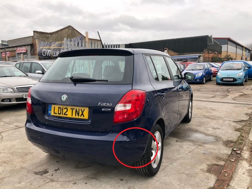

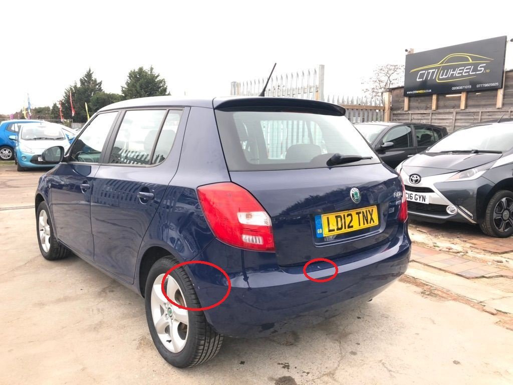

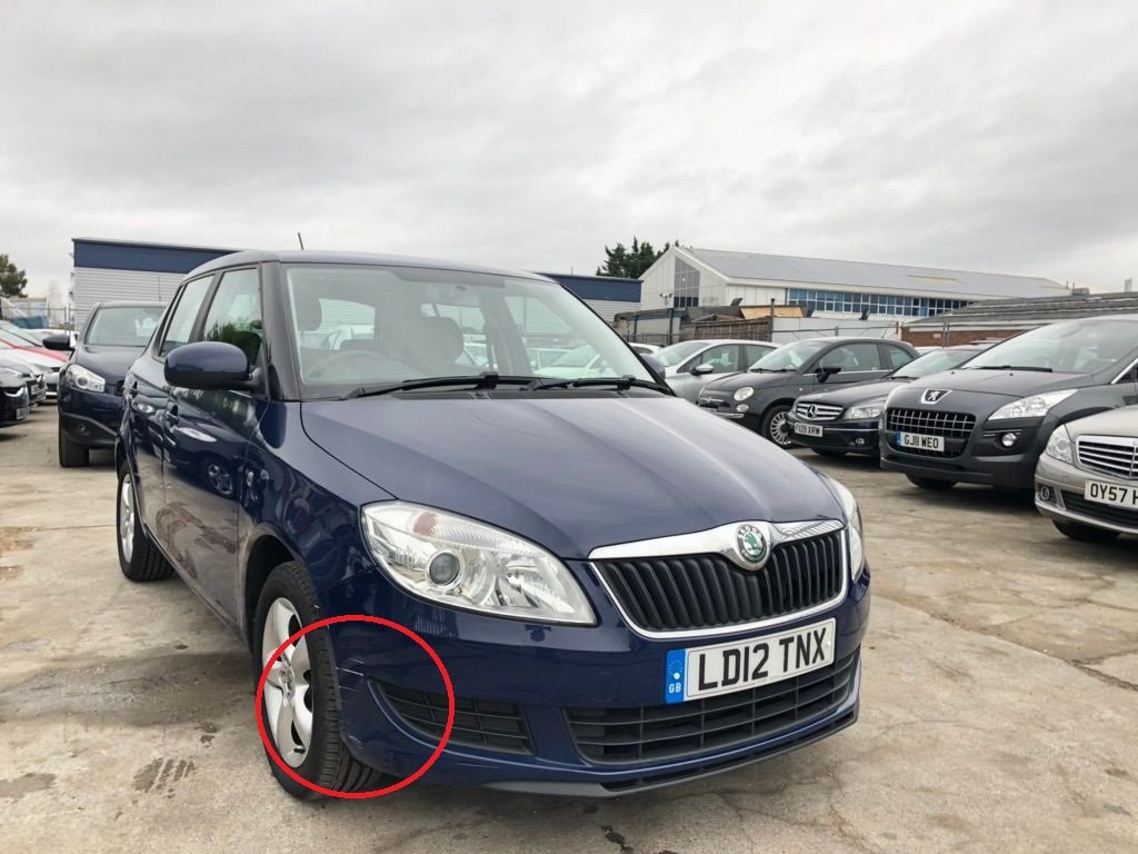

ALso, its states bodywork in good condition, well the problem is with that EVERYONE has diff opinions....look at damage on bumper......to me that is not good condition, so I think you need to see it because photos hide crap bodywork...
And more.....so to me this car does NOT have good condition body work......its "fair" imo...
You have to decide what YOU want......but it needs looking at as its top money for what it is so it should be MINT..
Looks like a typical low mileage older person run about (probably women) and damaged on each corner.......(not that im sexist at all)
Many thanks for pointing out those blemishes UrbanPanzer. I'm not bothered by these as long as they're superficial, however they may give me extra bargaining power!
Hey no problem, Not trying to down it, if your not bothered then great........... just wasted days to many times travelling to see cars "supposedly" in good condition at top money and they turn out to be rubbish.
And yes bargaining power for sure, at top dealer money it def should be pretty much perfect, the dealer is relying on the "low mileage" to sell because generally they like to think people will "assume" it will be good and no matter how much of a baragining person you are once we have travelled to see a vehicle that we might have been looking at for few days it can difficult to walk away as you "want" it and for me things like body damage would just **** me off everytime I wash it :@
