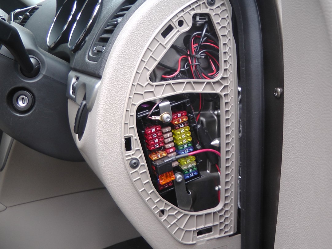

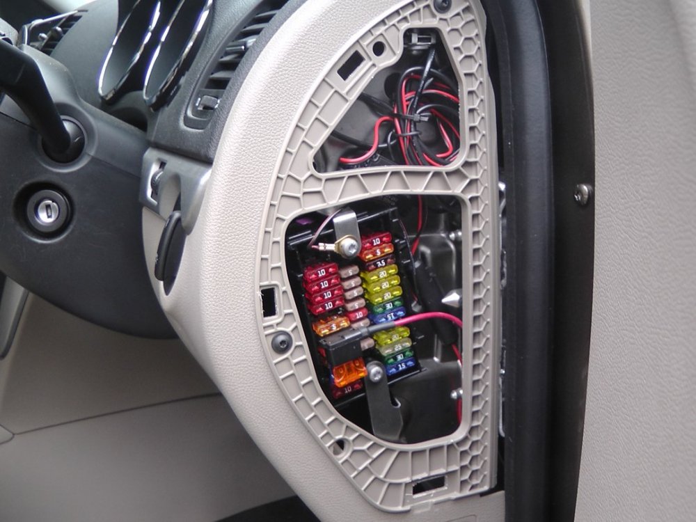

Straightforward installation, initially trialled by plugging into the centre console socket, then hardwired via piggyback fuse as fully described elsewhere.  The cable is tucked comfortably and securely behind the headlining across the screen, then down the front edge of the A pillar cover, round the bottom edge and into the fusebox.
I do have to admit to the use of sophisticated and high-end equipment, in the form of No.1 Son, who knows about these things.  He has a Mark XX sonic screwdriver or something (other tools are available, apparently) and could check which wire was which, whether it was live and which way was 'up'.  I'm pleased with the Viofo, which now has done two or three months service; I download into a temp folder every 2-4 weeks (via a card reader rather than USB from the gadget - quicker) and archive the odd clip for whatever reason.

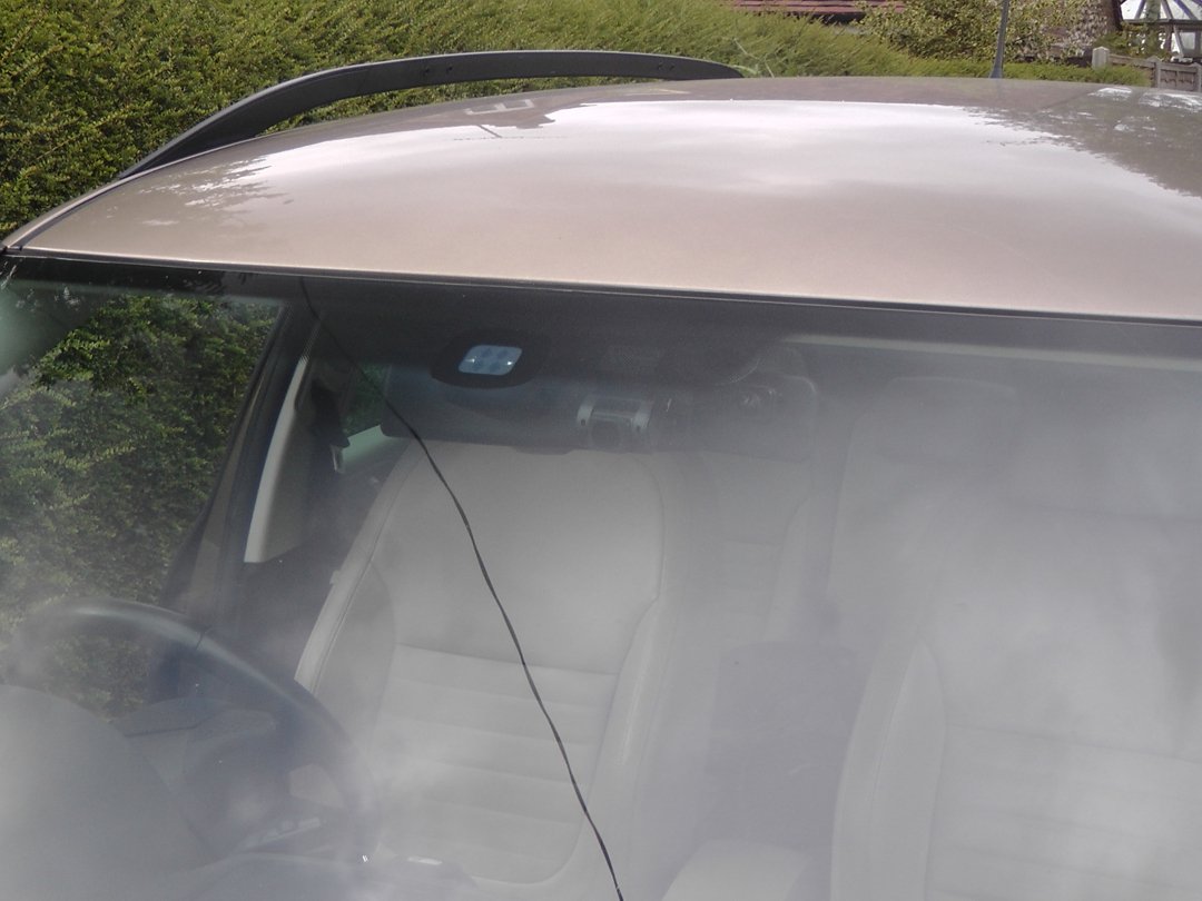

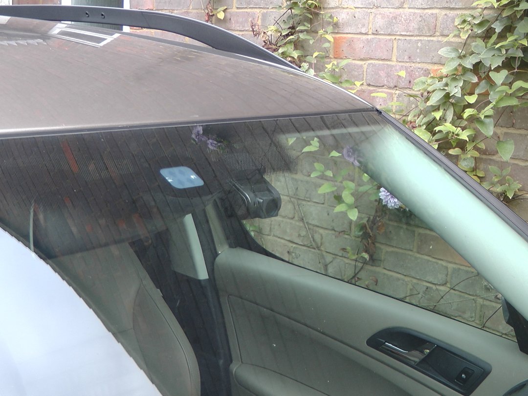

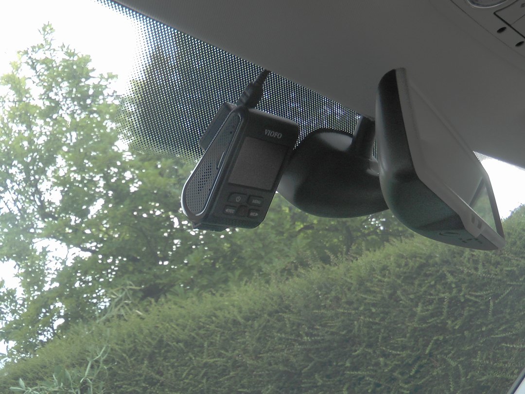

These pics show how it's mounted and what it looks like from outside (with and without a polarising filter to cut reflections off the screen)
imageproxy.php?img=&key=66c1d7df650950da
All's well - the screen isn't cracked, it's the reflection of an overhead cable.
