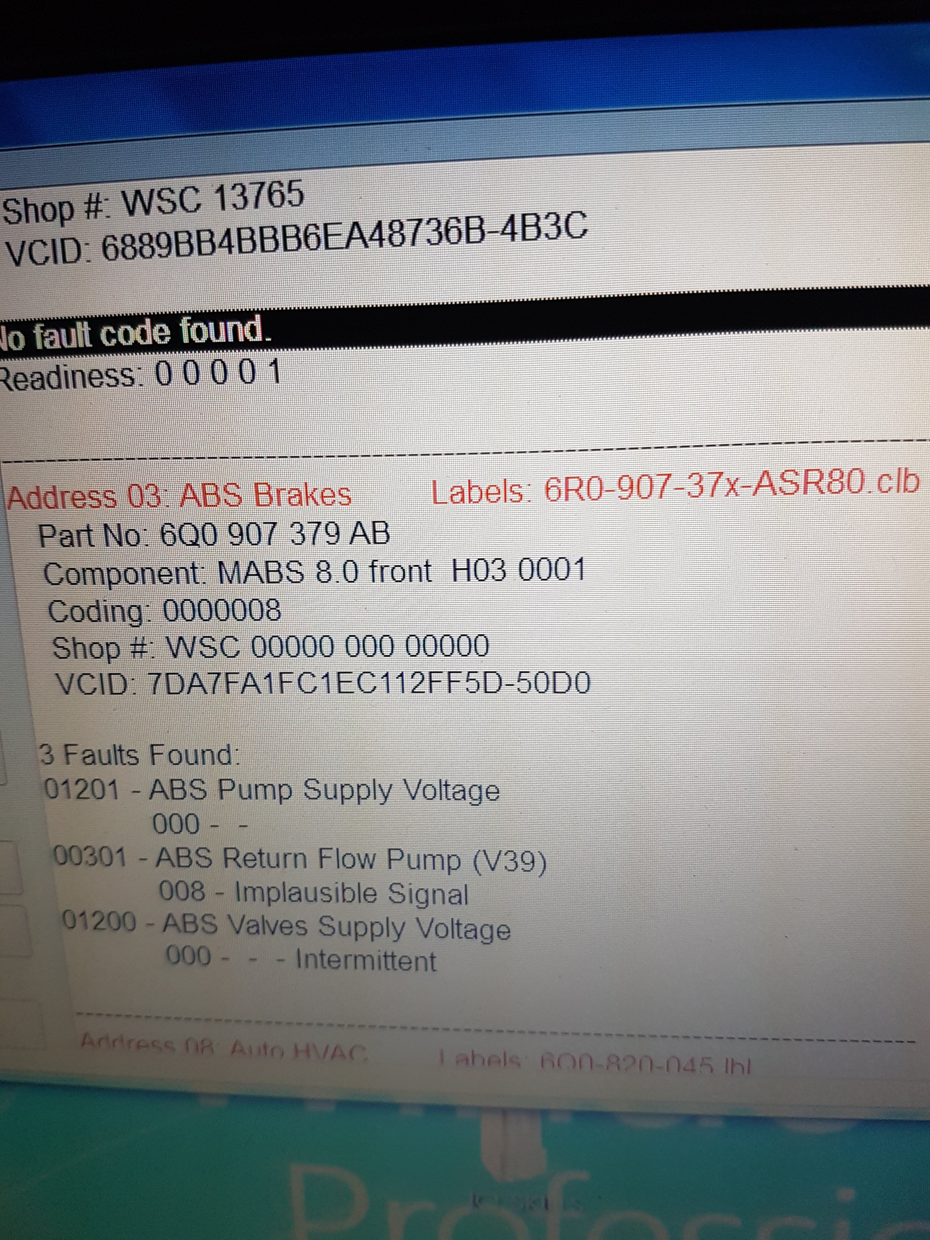

New to this game hope this is better
You probably want to track down what's causing those fault codes as they might be preventing you cycling the ABS pump.
