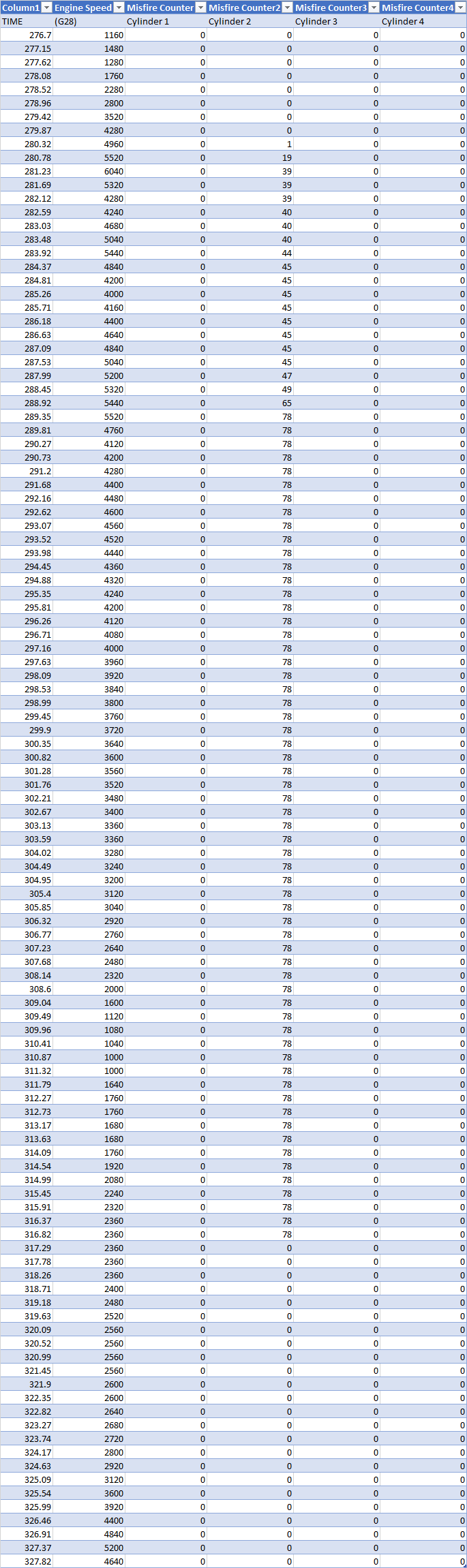

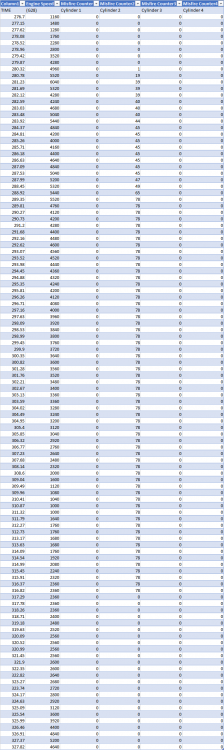

Measuring block 115 for boost pressure and actual came back fine (no boost leaks)
Measuring block 2 for MAF shows increase of g/s from 2g/s to 140g/s @ 5k revs before the misfires kick in
Measuring block 32 shows adaption bank sensor going no higher than 5% so it appears no obvious leak for fuel trim
Table attached for real-time cylinder misfire logs.
Im going to re align the throttle body and potentially check the PCV even though its less than a year old and not whistling or anything.
Is this all helpful to make some suggestions?
