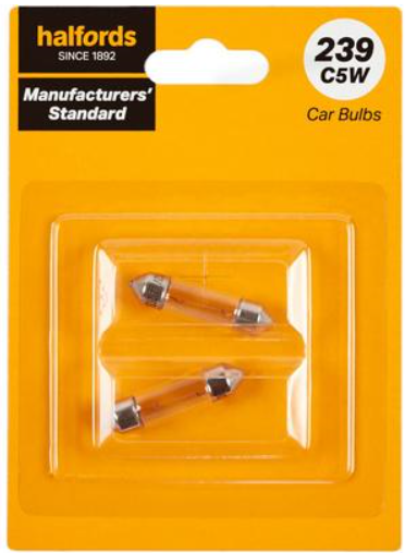

 might be a silly question but I’m changing my reg bulbs but have NO IDEA which bulbs to even start with.. would some one be able to tell me what type of bulbs I need to swap them with? Any help is much appreciated... I have a ‘53 plate mk 1 fabia
C5W
Edited by TMB
As above, but the retaining screws are torq. ( 2.5 from memory )
