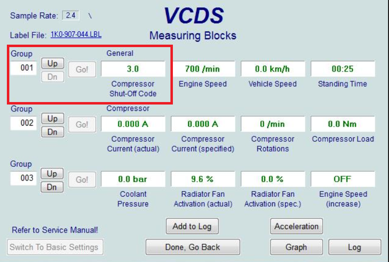

My point is that you can’t fault find properly if the car is inhibiting the air con compressor but if you must persist....
 If you warm the evap temp sensor up it should at least take that out of the equation and you might see the compressor want to run unless the ambient air temp is tied into it which I don’t know for sure
The heater matrix is after the evaporator so that won’t make any difference you will either have to physically take the sensor out and warm it up to 20-30C. That way the compressor should want to run at a decent load but it will freeze up if you leave it too long.

  • Well done Wino!   Just been out in the cold again, it was there! Shutdown code 8, evaporator temp less than 3°c   Now I know what to look for when things warm up a bit.

38 minutes ago, J.R. said:
I have found now that the evaporator is inside the cabin, part of the heater/climatronic unit, as such it should be at the same temp as the interior vehicle temp and not 6° beneath it,
The evap temp has nothing to do with the interior temp, the load of the compressor is controlled by this temperature. In most circumstances the ideal evap temp should be as cold as possible but above freezing temperature. This is what dehumidifies the car. This is also why if your trying to run the air con and its lower than 5 degrees outside the compressor will not run as its getting down to that temperature in which it would freeze solid and not let any air pass through it.
You could turn the heater up to the max and the climatronic should still be asking for that evaporator to be cooled down.

Evaporator is indide cabin, but nearest the outside world in terms of airflow. So if no cooling is coming from the A/C it will be somewhere between external and cabin temp, depending on fan speed/airflow into cabin.
Yes they make sense after I have been out for another play, the shut down code 8 was for outside air temp, its currently 0.5°c so I understand and agree that i am wasting my time at the moment aside from learning and knowing what to look at when things warm up.
Heated the cabin right up and the evaporator temperature rose to 7°, cant recall what I said it was before but i saw it rise through a couple of degrees so the sensor appears to be working.
If as you say the evaporator is intended to be cold then it will I guess be insulated from the cabin temp so the 7° appears plausible. Will leave till warmer weather.
One interesting thing, ran the car with heater on HI for a few miles, temp guage up to the middle 90°c I think, sitting with the engine idling and the heater on the temp guage dropped to 1/4 and VCDS showed the coolant temp as 63°c so in freezing conditions the engine does not give out enough heat for the heater demand.
If you warm the cabin up and put it in re circulation mode set the vents to footwell (where the intake is), that is one way to warm the evaporator up.

So when you got the compressor to run, what was the evap sensor saying?
It didnt drop in temperature at all when switched to 'LO" I was able to use advanced measuring blocks or whatever it is called to look at several parameters, the outside temp was 4°c and set to "LO" the air coming out of the vents was 10°c.
