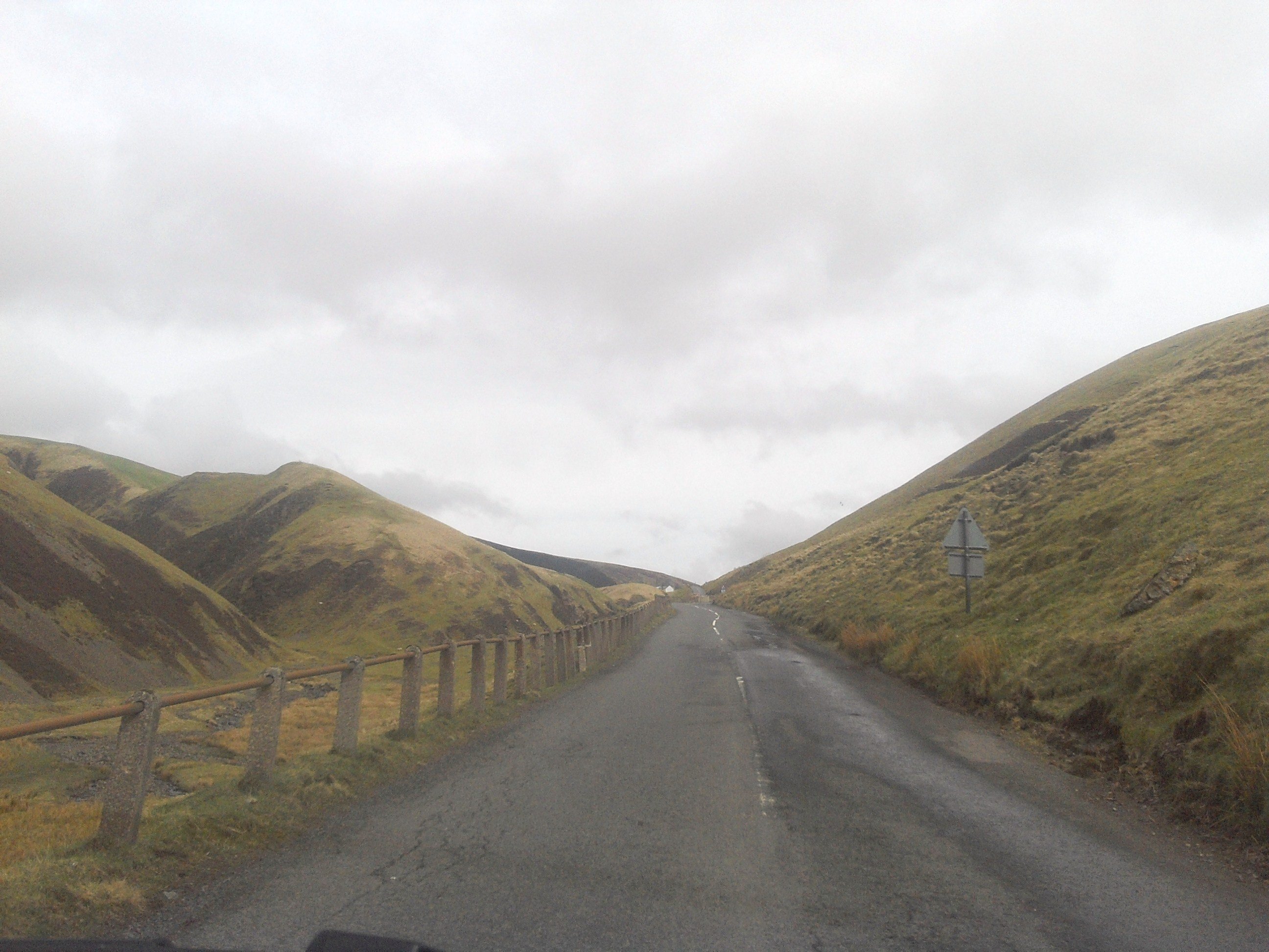

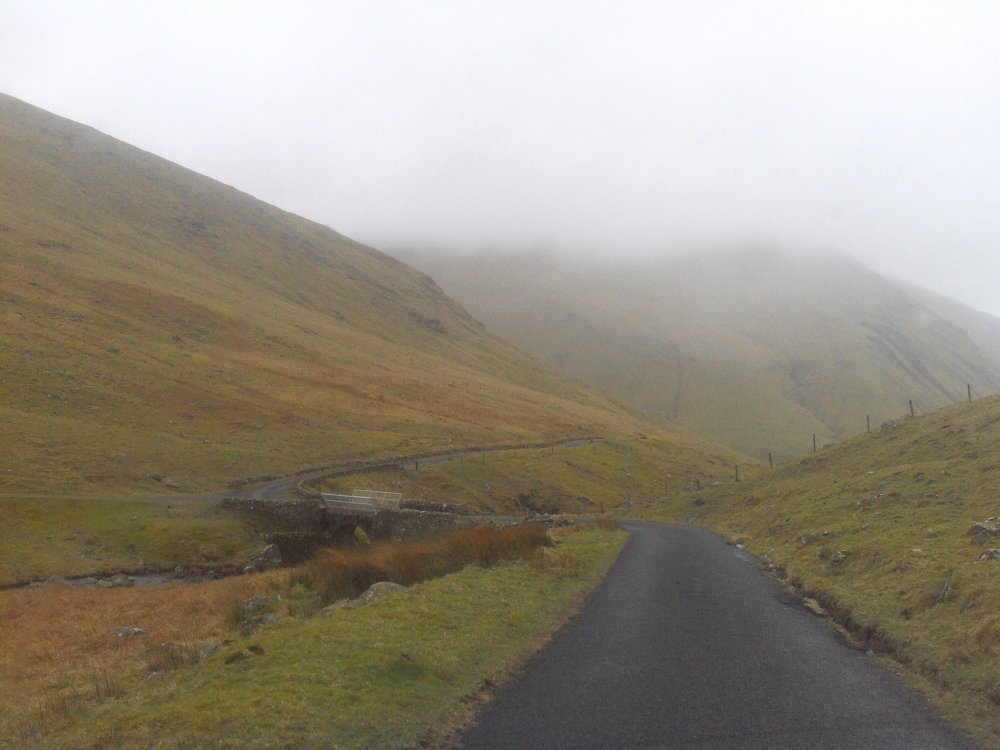

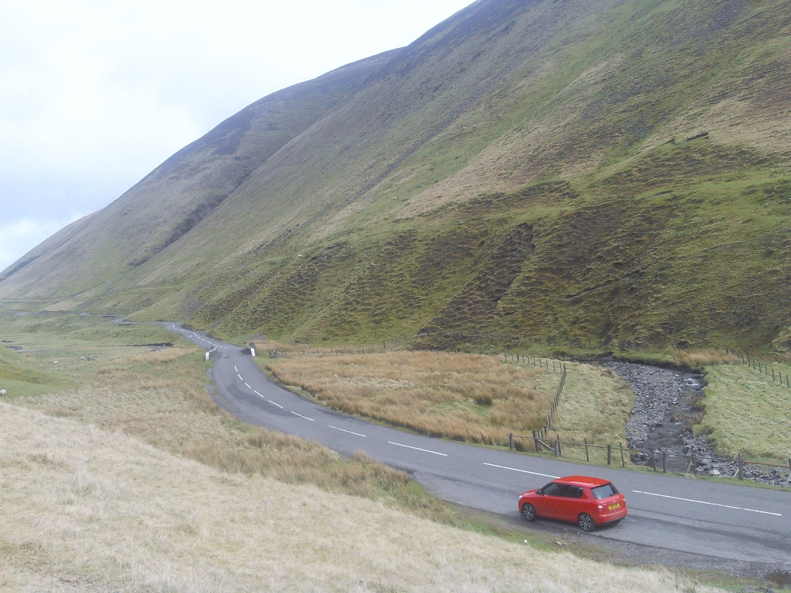

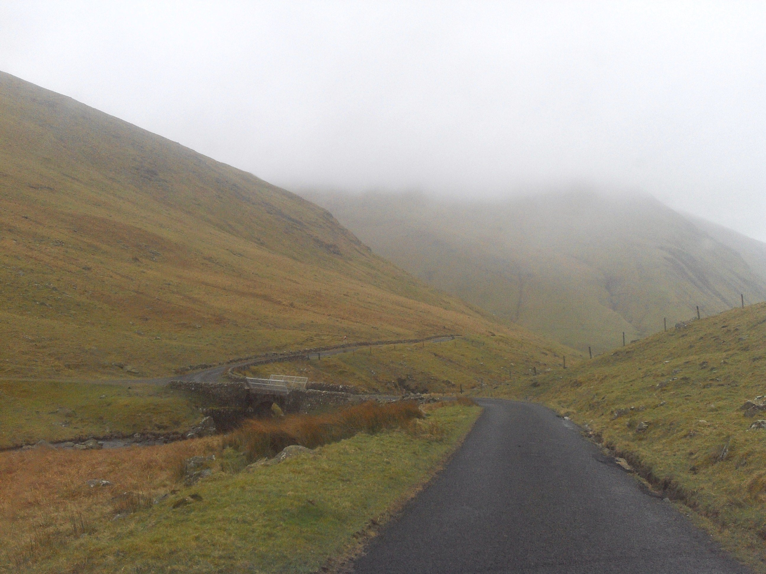

When i had weights off i had 2 spare wheels in the boot anyway on 'Adventure Trips' to the great driving roads, and a trolley jack and spare High Octane Fuel.
Sometimes a passenger or 2.

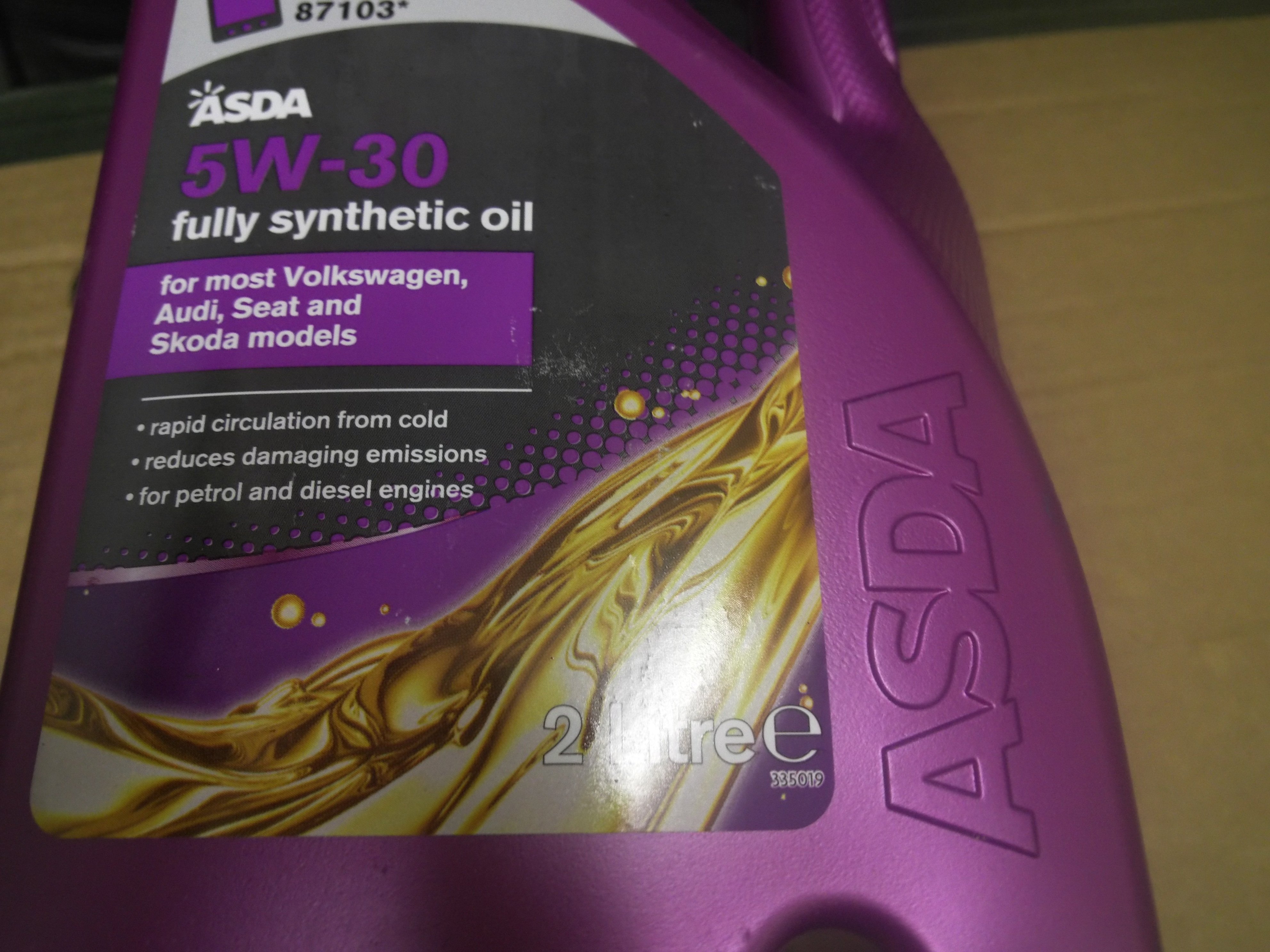

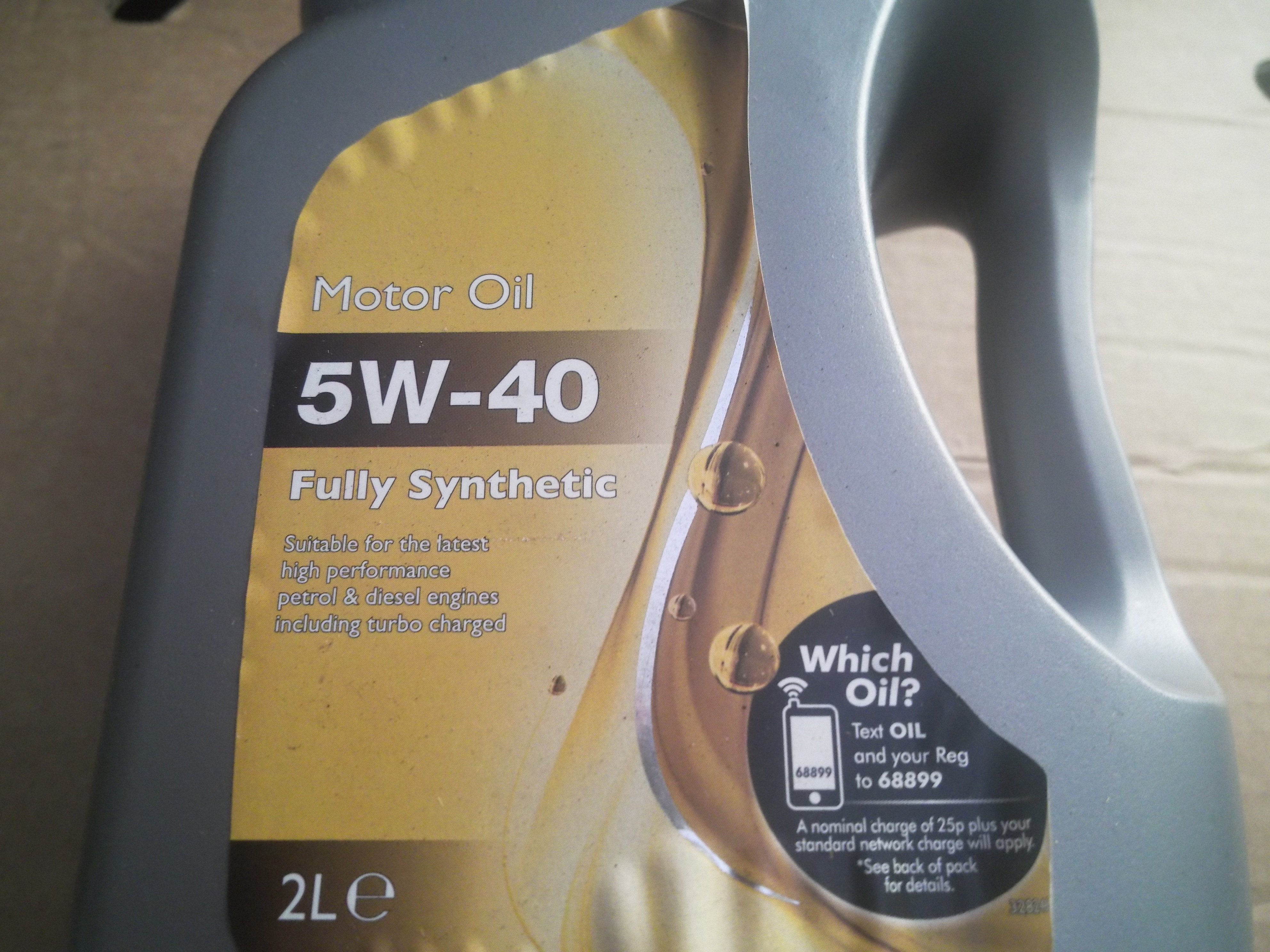

I highly recommend ASDA oil.
4 litres to VW 502 00/ 5w 40 FS.  Perfect, and just keep topping up with this if you are not going to drain the 5w 30 FS LL that is in and change the oil sooner than 10,000 miles since the last oil and filter change.
Or Comma, 5w 40 FS, Fuch, Mobile, Quantum or whatever.   Just stay away from 5w 30 FS LL and as well to avoid Castrol since VW recommend them.
(For TDI's that require VW504/507 i use the ASDA Oil.)
