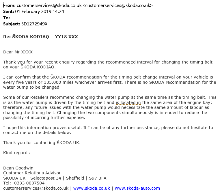

Skoda Kodiaq 1.4 TSI Cambelt / Timing Belt Interval
There is often a lot of misinformation floating around on cambelt intervals, so I checked with Skoda UK.
Still not what you'd call a reliable source of information, but probably as good as it gets :D
