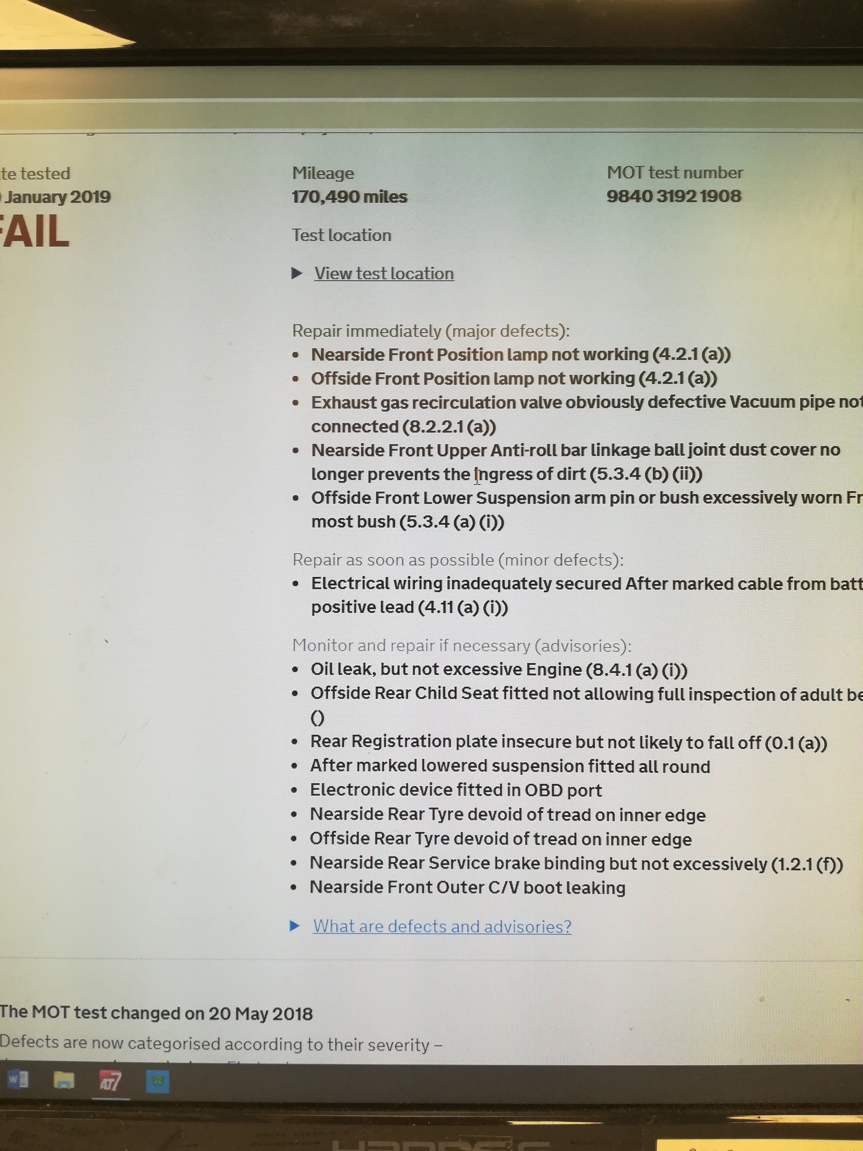

I'm a bit stuck on what to do with this...56' Elegance Estate PD105 with 170k.
Had this car for 5 years, done 65k in it and so far spent around £800 on it. I didn't pay for the car, it was a gift. I do get attached to my car's, be it this or my old 1991 fiesta...it's my car...
Now....MOT calls for a lower arm and an ARB link dust cover to pass as well as having a few advisories. If that was all it needed then it would be going through and being kept.... however... I'm positive the turbo is shot (may replace with a refurbished unit) and now the clutch has just about had it which makes it just about unusable (very harsh vibrating under any load while in 3rd-5th gear. Disappears with clutch pressed, may be replaced with an SMF Conversion).
But, at what point to you decide that the repair costs outweigh replacing the car? Even though replacing these will likely give another few years of fairly cheap motoring....I'm guessing the parts and labour for what I think it needs is going to be £1-1.2k and for that kind of money I could definitely replace the car, but for one that's going to be any better in a year's time?....

So far i have:
Lower arm and droplinks -£150 Inc labour
Clutch - £150 labour plus parts (Or £650 all in for SMF Conversion from a garage)
Turbo - £2-300+Surcharge depending which version + £100 labour
The costs slowly add up but hoping to be able to spread it over a few months depending how long the major bits are going to hold up!

I love how they write "after marked" rather than "after market" and they consider the vehicle having been lowered a defect that an owner would want to be warned about.
I don't see anything on that screen shot I would consider terrible or not fair wear and tear for a vehicle of that mileage. The plus side of getting it fixed is that you know what state it's in. You aren't going to have a new to you second hard car that looks like a good runner but starts springing nasty surprises on you in 6 months.

Well it seems the general consensus is to keep it, so it's booked in to have the MOT necessaries sorted on Monday and a retest on Tueaday. New clutch will be ordered tomorrow (DMF as it's cheap enough for a Sachs kit). New turbo is being looked at and will be done at the same time as the clutch. VAC lines will be replaced, I'll service it while it gets the clutch and...Drivers window regulator....mine broke 18 months ago and has been taped up since! Must do that soon, I have a replacement mechanism, just need to replace it! Would be lovely to not have to open my door to get a ticket in a car park...or visit a drive through! It will also get a proper clean, something it hasn't had for a long time!!

Widdershins, the "After Marked"  suspension is mine, the car appeared totally stock when I got it apart from a couple of cut cables in the engine bay and some screw holes in the center console which I assume had some form of radio equipment or controls for lights and the sensors behind the rear view mirror were missing. My guess is it was a commuter or beat car rather than response (Like the Fiestas we have around my way), but either way I doubt it had the easiest of times!
