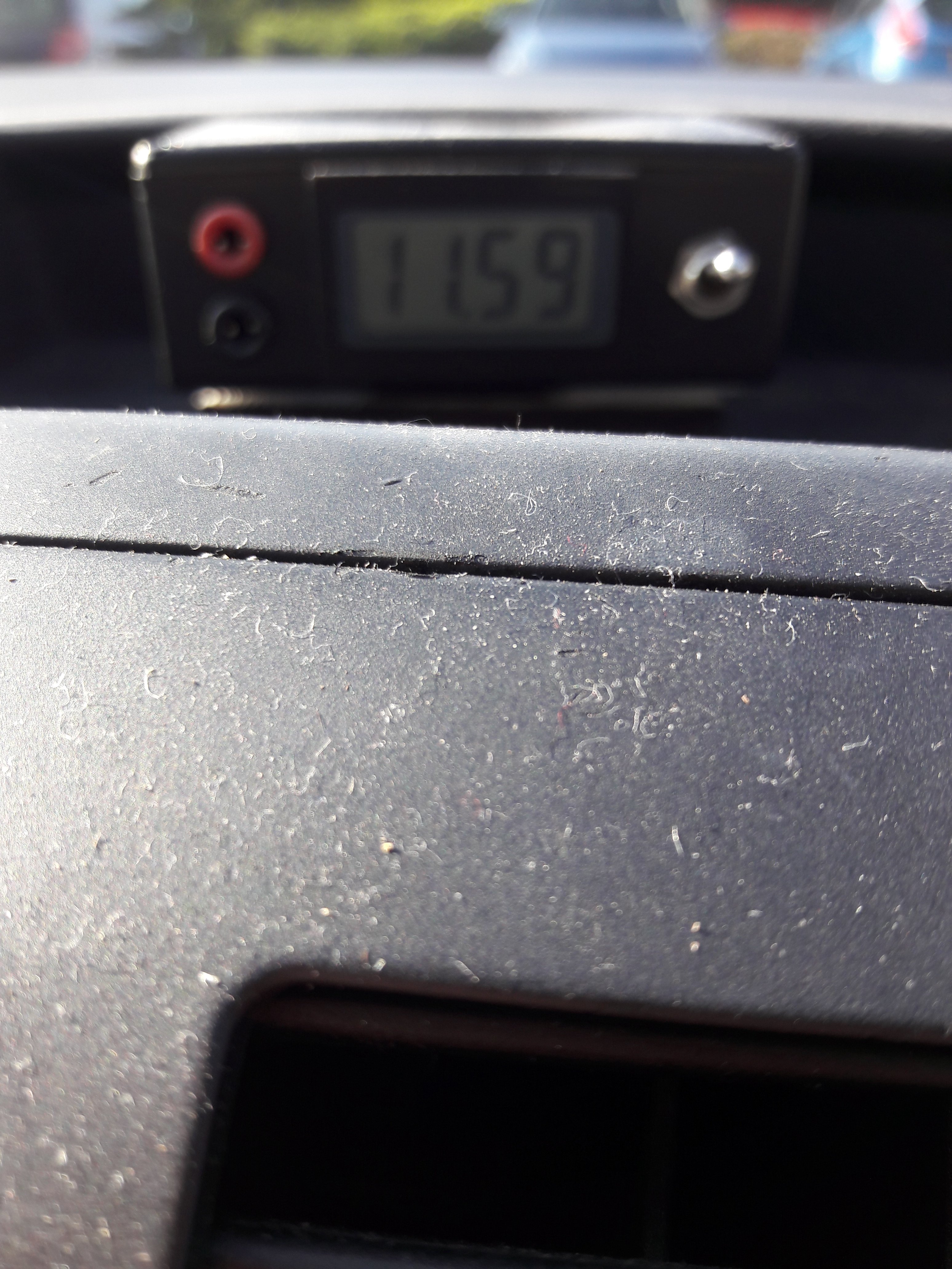

I succeeded, but had to try pretty hard. From a 12.79V starting point (before unlocking car) the lowest reading I could get was 11.59V. That was with lights on and full beam, heated rear window, blower on 4, wipers front and rear and (probably importantly) the auxiliary PTC heater on full, which was a retrofit, so slightly unfair as the petrol engines/alternators don't usually have these heaters.
DVM is wired directly across battery posts.
Idle speed I didn't really look at until the end of the experiment, which was at just under 900rpm I'd say, maybe a little higher than I'd expect at that time after a cold start.

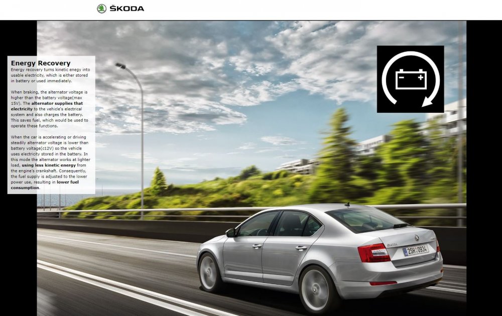

Nearly there but not quite!
A potential difference in an electrical circuit is needed for current to flow. This is measured in Volts and current flow in amps.
The reduced voltage you measured is a reaction proportional to the current flow / draw from the consumer devices active at the time of measurement. On these micro hybrid vehicles, this will be mostly from the battery until such time the system senses that the voltage is low or the current draw is too great for the battery alone to support without damaging it. The alternator is switched in and out to recharge the battery as a result. Engine speed does not affect alternator output unless stopped. Regen braking uses the rotation of the engine off-throttle to capture the kinetic energy of the vehicle through the alternator instead of burning fuel.
For a battery to charge, a potential difference in the circuit needs to be greater than that of the voltage of the battery so that current can continue to flow. Hence a charging output from the alternator on the electrical circuit no higher than 14.8v, battery voltage will settle at 12.8v open circuit for an AGM (depending on specific gravity of the acid). That difference of 2v allows a small current to flow in the circuit for a period of time ensuring the battery is always able to be fully charged.
The principle operation for a vehicle battery is to provide the high rate current flow the starter motor demands. It can sustain this rate for approx 250 seconds before being fully discharged to 6v. It’s secondary operation is to provide electrical energy for connected devices and as a byproduct smooth out the electrical system absorbing electrical spikes and irregularities.
Repeated short engine run times kill batteries as there is never enough time to put back the electrical energy that has been borrowed previously.
