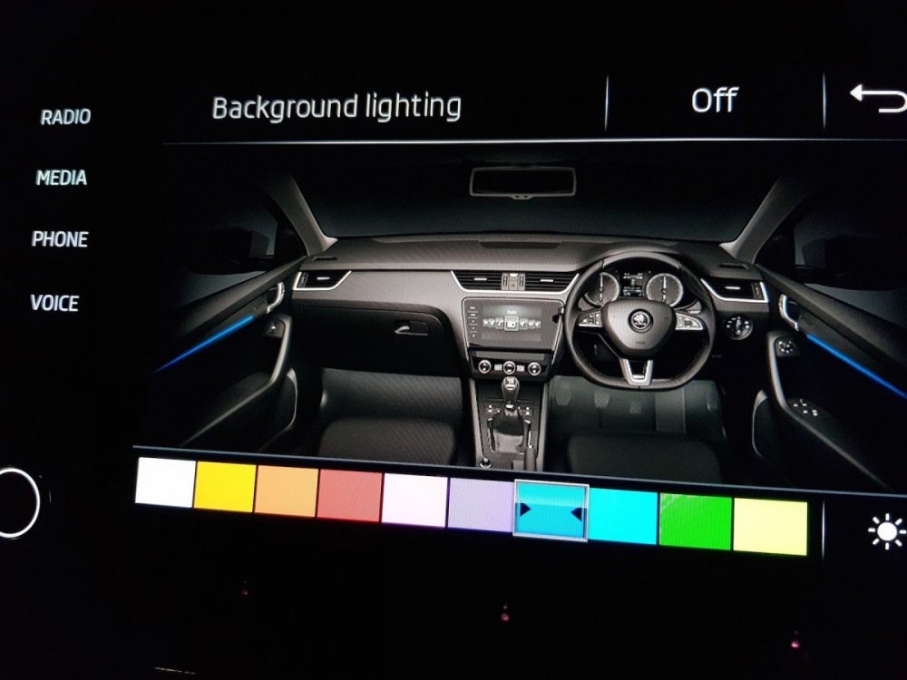

Does anybody know if it’s possible to retrofit the LED door panels on the facelift mk3 to the pre-facelift?
I guess there are 3 areas that need to be considered:
1) Physical fittment of the door trim that contains the LED light bar
2) The connection for the power and control of these LEDs (guessing its powered and driven by the head unit?)
3) The headunit itself as this controls the colour etc of the LEDs - I guess you’d need to fit a newer head unit?
thanks
Matt

no way this will be cheap. I know how I would do it, but the integration is teh hard part. It's been looked at before and, personally, because I'd be surprised if you could get away without new doorcards, i'd put the cost at well north of £1k

it's not that hard to plug in some WS2812Bs and a controller and then use a small opening at the bottom of the door decor strip, but you'd need to do an awful lot. The strips are generally EL wire and not programmable; WS2812Bs really are programmable, and a controller - ESP8266 - is not expensive.
