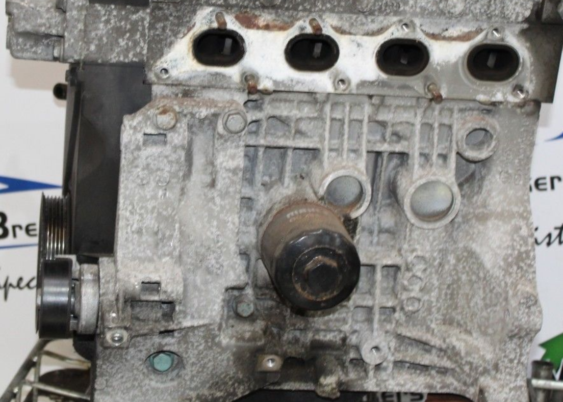

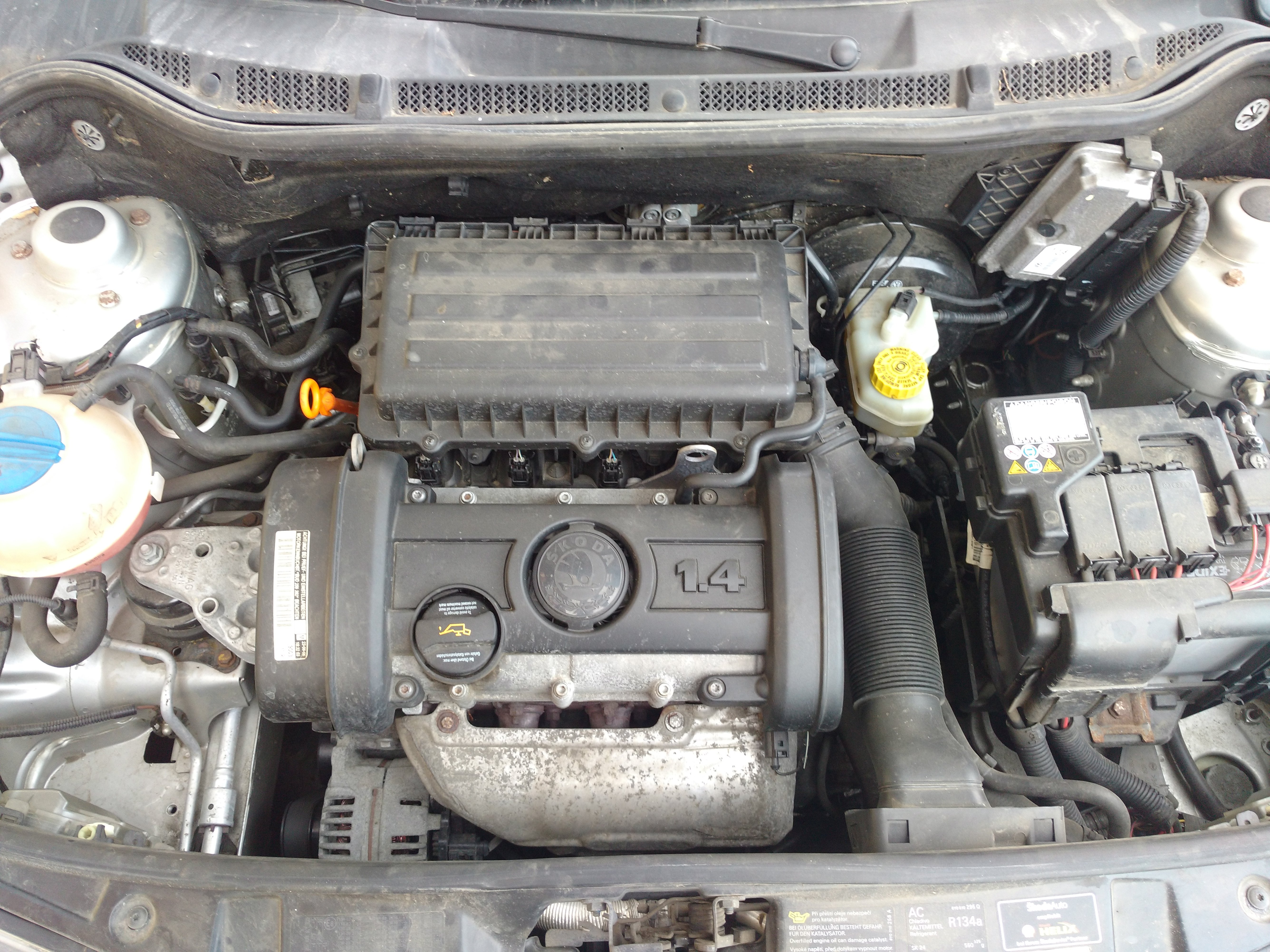

I have a Fabia 1 1.4 BUD, the 80PS version, and I can't locate the oil filter. Is it under the plastic hood of the engine? The plastic hood is much smaller than on the 75PS version (the air filter seems to be separate, closer to the windshield).
  • Sponsor
Just next to the back of the alternator:
I can sense the disappointment that the oil filter was not up in the engine bay as expected where its easy to access :D
Ok, thanks a lot. So, I have to access it from below the car, right?

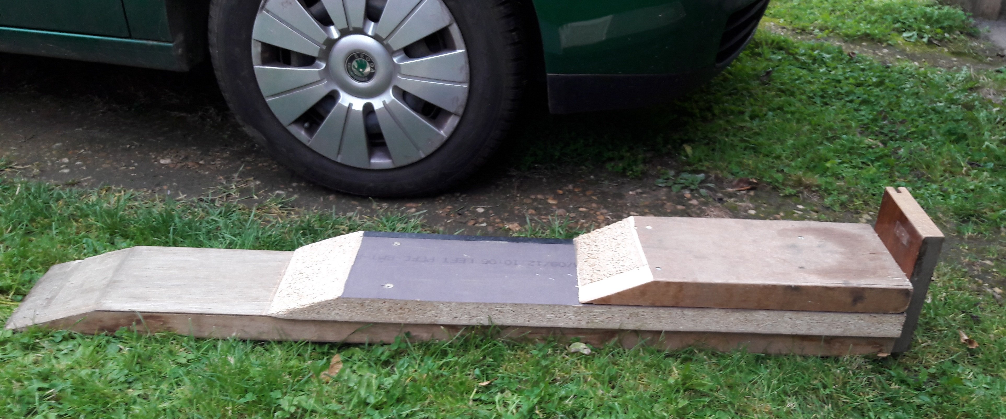

Do you not have any ramps?
So handy!
If you pay for the courier, I'll make you a set.
Oh I've got plenty ramps, a set of 4 wooden ones made by me and 4 axle stands and 4 Jackpoint Jack stands, but I've always found that unless the car is lifted a lot higher, getting yourself into the correct position to remove that oil filter while lying on your back is not the best way of working - from a pit yes.  My 1992 VX Cav GSI 4X4 was easy to rear from below as was my 2000 VW Passat 4Motion, but these Polos/Ibizas made me change my plans, I've yet to discover if "from below" is possible with my wife's Polo with the 1.2TSI engine, that pleasure comes mid summer!
