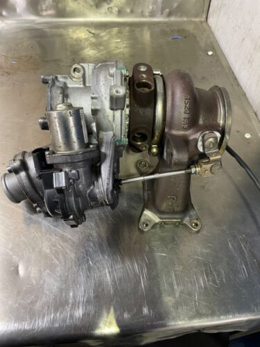

You could try and move the wastegate actuator rod, move back and forth. even lube the pivot of the wastegate arm end, see photo,  but waste of time if the fault is not related to boost.
If the fault is over boost / under boost related, it could be the actuator, the gears in the servo can fail or it could be the actual wastegate flapper arm pressed into the turbo housing itself that is much more difficult to deal with and will need a turbo rebuilder or part new casing. Turbo out for either of those.
According to Mk7 GTI posts you can change the actuator with the turbo in place but I imagine they are tight to work with. This thread suggests a low profile T30 in the IHI20 actuator bolts.
AFAIK VW/Audi do not sell the actuator separately, but you can obtain them.

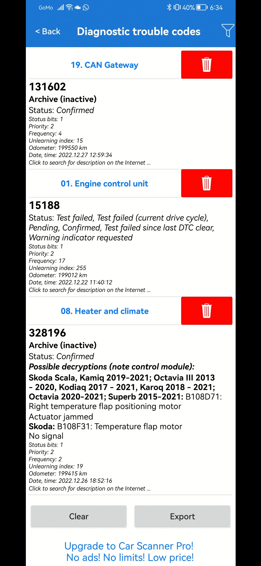

These are the codes I got off a simple obd reader at home. Don't know what the garage found exactly.

15188 is oil pressure switch malfunction. So that makes sense why they suspected and replaced that.
the others are inactive and don’t seem related.
is this a scan as of now or end of last year? Have you cleared and re ran? As if you are still getting limp mode still,  I’m expecting there may be a new fault code that wasn’t present before?
Or if the fault is coming back after clearing the other oil pressure switch maybe faulty as well. There are two I think, high and low pressure. Seems very coincidental for both to go faulty though.
those scan fault codes on generic scan tools don’t give great descriptions as you’ve probably noticed.

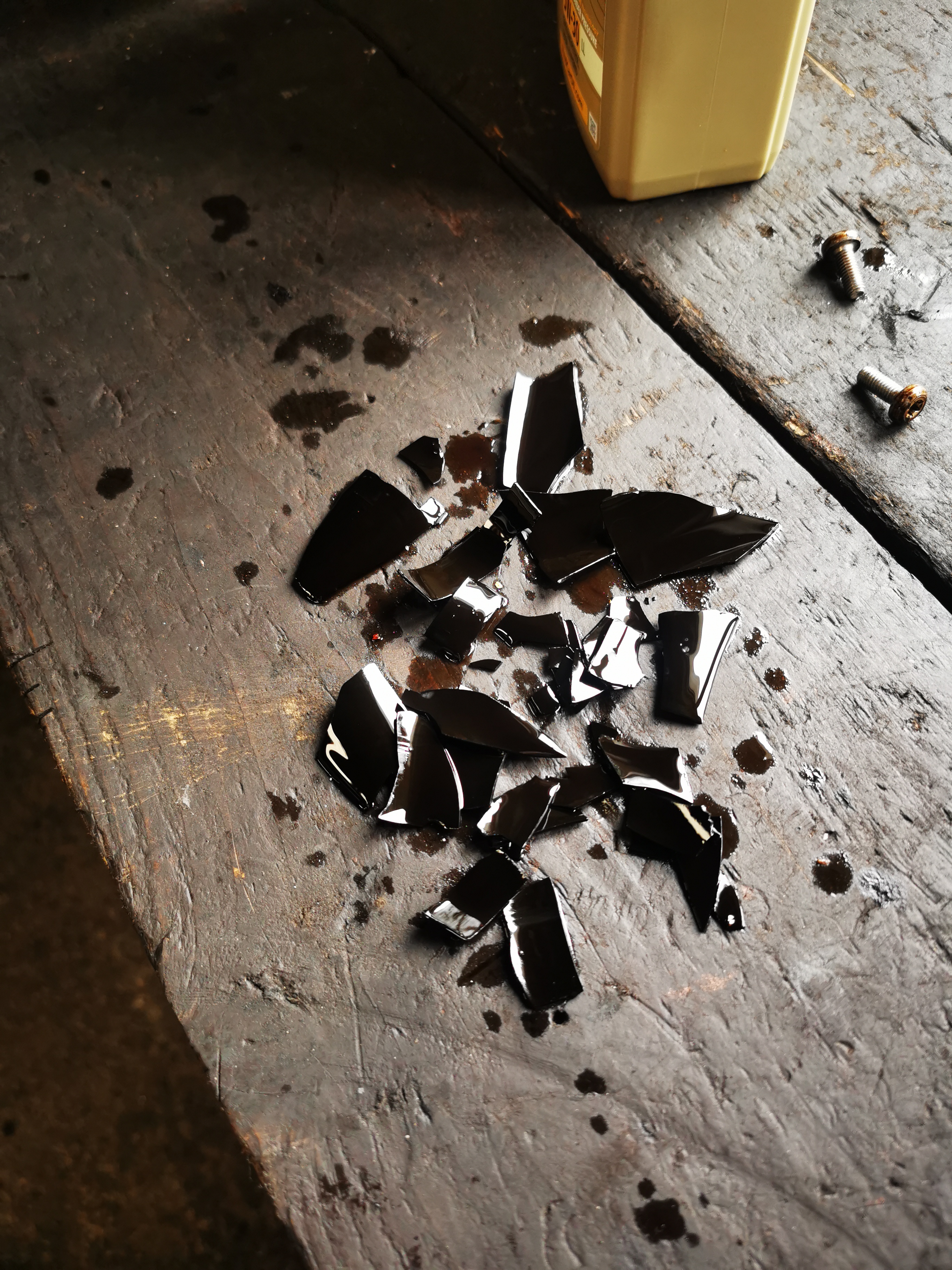

Myself and a friend got the car up on a lift, drained the oil after running Engine flush through it and then dropped the sump. When the sump came down we found a load of bits of black plastic. Thought it was part of the baffle at first but none of it was broken so we were stumped. Put everything back together and filled with new oil and filter and its as good as new.
But i went looking online then to see where the plastic could have come from. And from what ive found i think its part of a chain tensioner from either the oil pump chain or the timing chain.

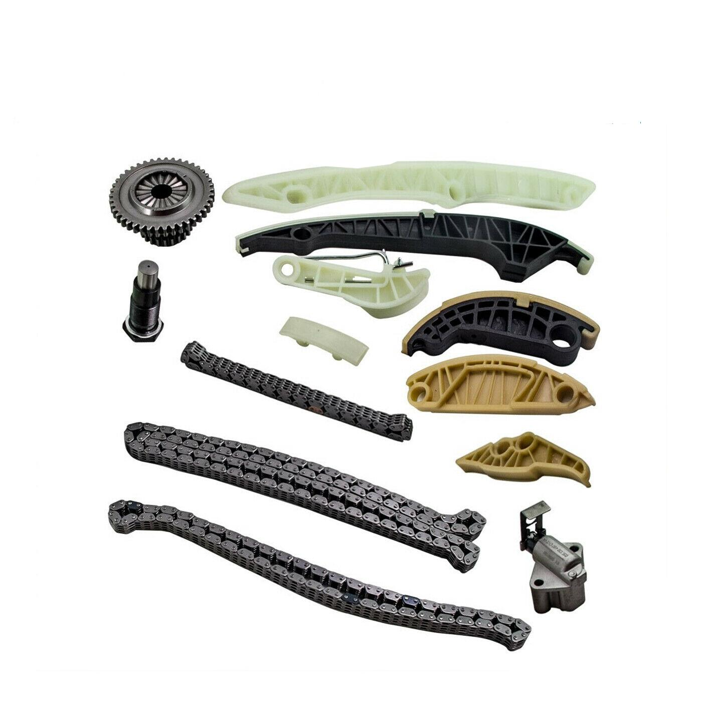

You mean it a guide or rail for the chain? They have been known the fail or get ripped off sometimes. They're mostly white plastic from memory often with cross hatching reinforcement I think. I can't really tell from the photo as its all covered in oil.
Edit. This is for a gen 2, but will be similar. There are white brown and black rails and guides!!

Yeah i think its most probably part of the oil pump chain tensioner... Apparently the original ones were black and the revised ones are white plastic.
I think you are going to have to pull timing covers off and inspect. If your going to all that trouble and cost you'd want to replace the main chain, rails and tensioner even if it is not the broken one. I wonder how much plastic has got ingested. Hopefully it just broke up and dropped into the pan.
Yeah I think so too... I dont think any got ingested as the gauze in the oil pickup stopped it all.
