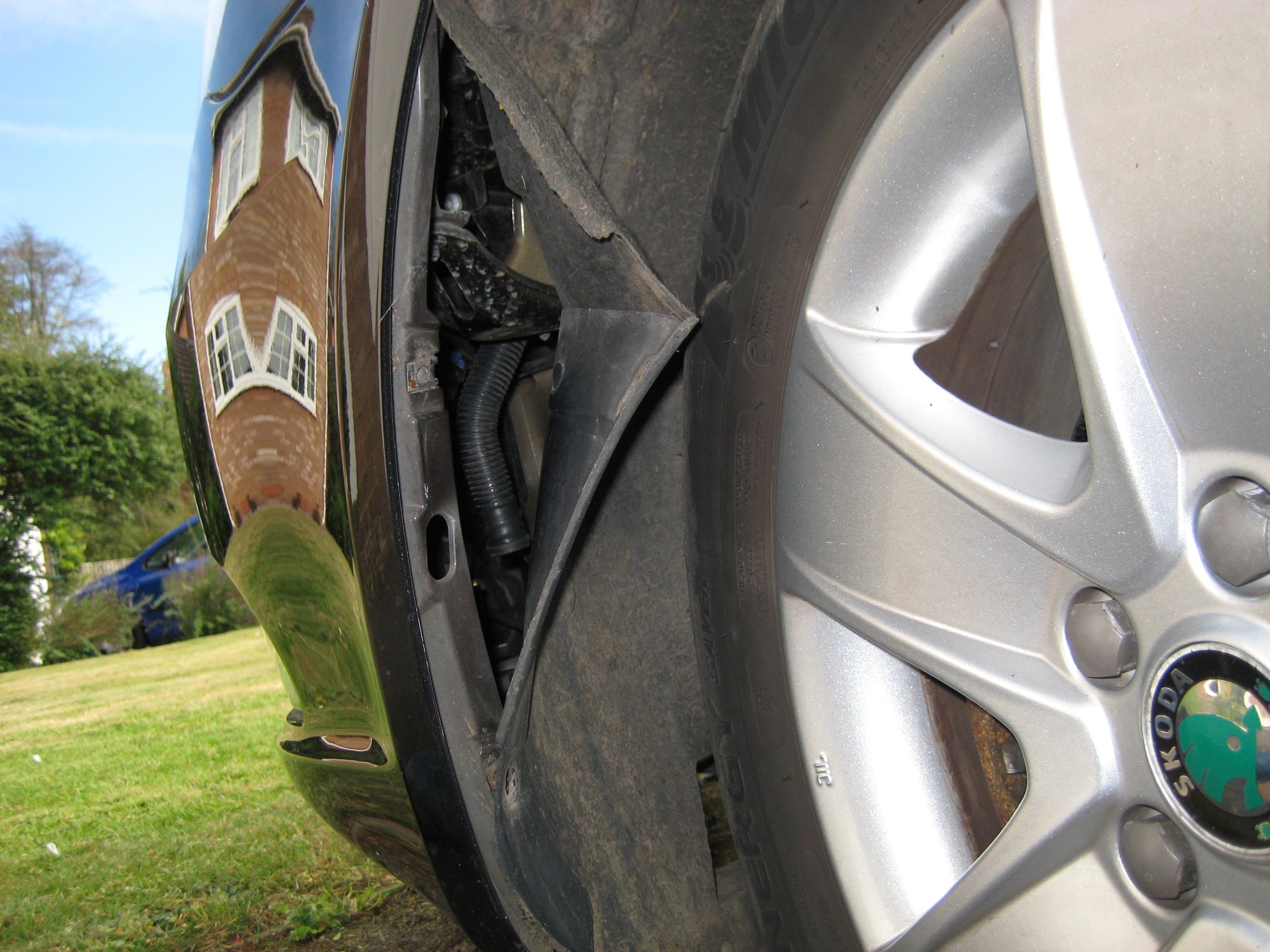

I had the same problem with accessing my drl bulbs. Gave up trying to remove the grill as shown in the handbook as it seemed likely I would break something as I was pulling with all my weight.
I turned the front wheel inwards on the side of interest and then removed two or three of the screws holding the liner in place (see photo). You can then pull back the liner enough to get your arm and hand to the drl bulb for replacement. Note that it looks like I have bent the liner but in fact the liner is in two parts and they are just resting one against the other.

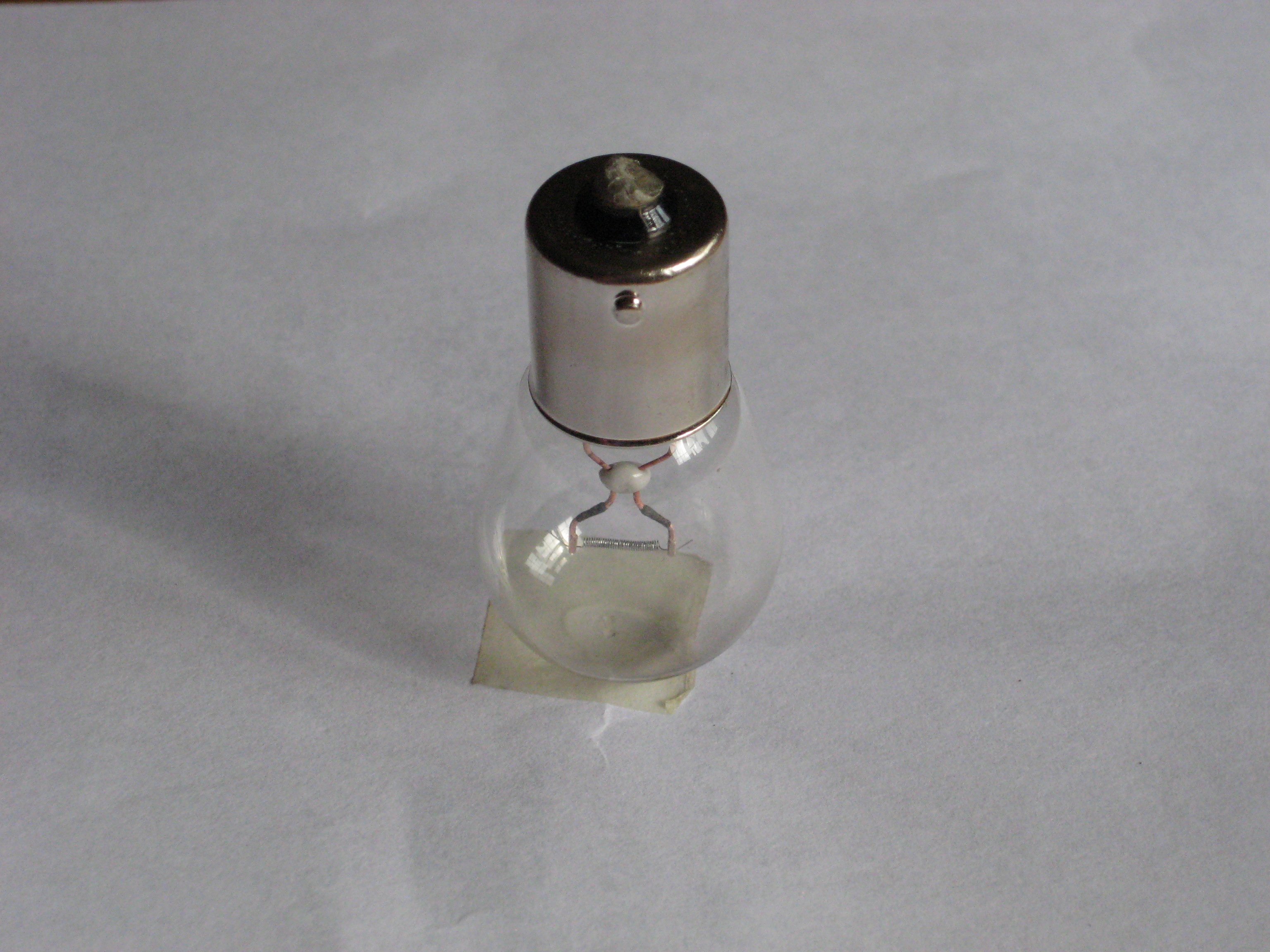

When I took the bulb out, I found the solder pip contact on the tip of the bulb had been fretted away to almost nothing by vibration. I built back up the solder pip with an iron and it has been fine ever since. That also explained why the bulb out warning had been intermittent as it wore down.

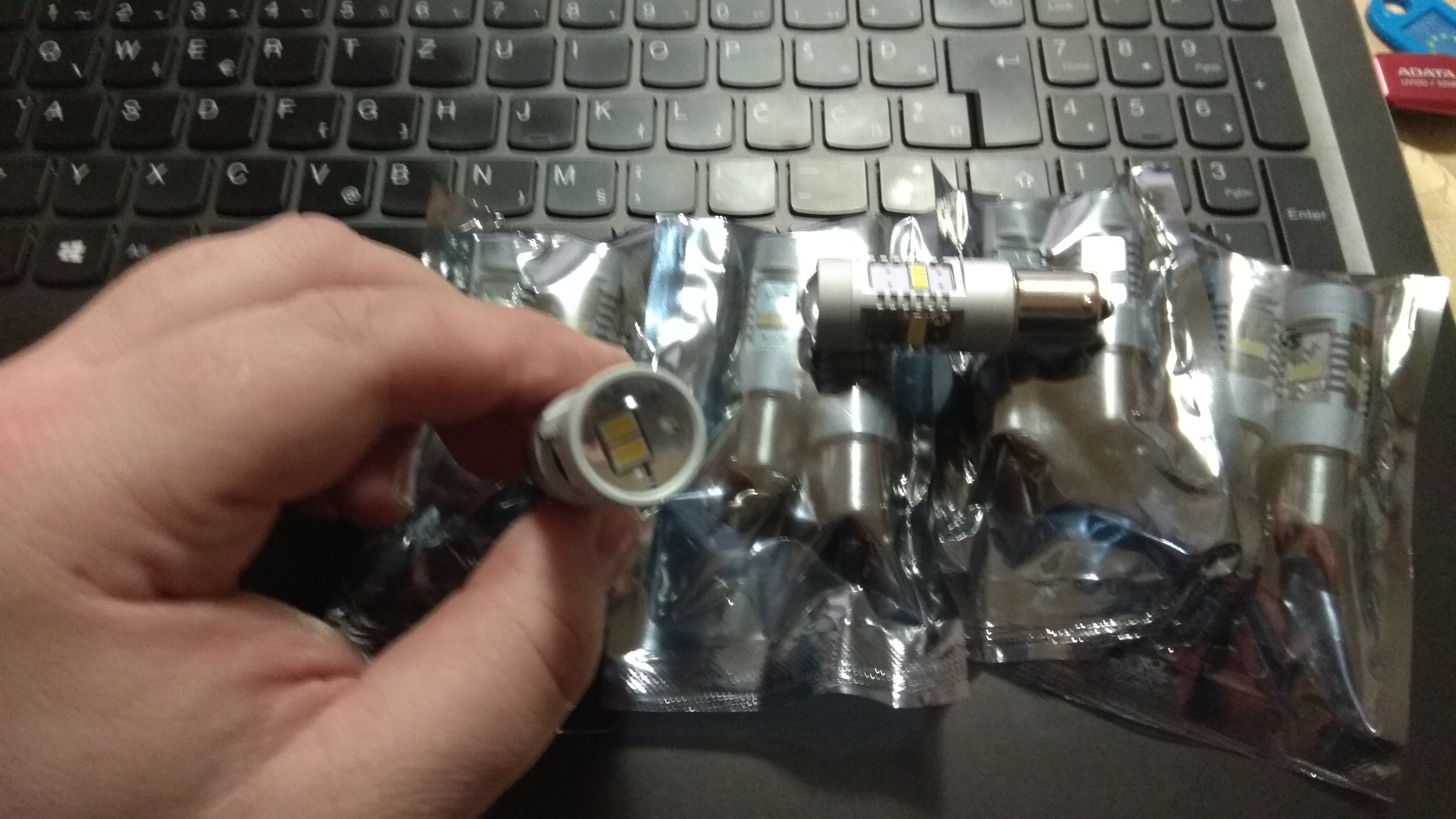

if you are going to replace the bulb, make sure it is a PY21W SLL bulb (as shown in the handbook) as it has a thicker filament to resist vibration. Normal bulbs don't last. If you want LED equivelent then use the type shown in the first video. LEDs that have the resistor in the cap can overheat the connector.

No need for additional resistor in DRL bulbs. This P21W do not show blown bulb error on dash.
That LED bulb will have a resistor built into the cap to try to fool the bulb monitoring systems and any excess heat it creates can melt the bulb holder.
It's best to get quality 'non CAN-bus friendly' bulbs and code out the bulb warning.
That's true. I use this bulbs about a year. No damage to holders.
