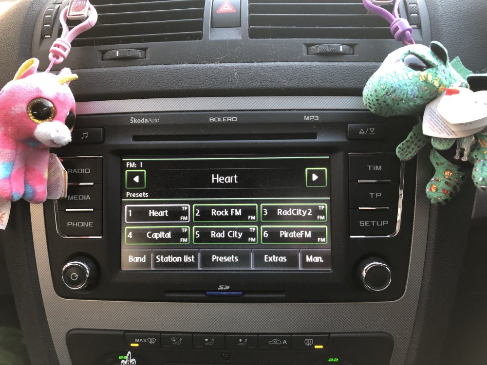

I’ve got a 13 plate Octavia and it’s got a 6 CD,MP3 player fitted. It has a button on the left saying phone and it just mutes the radio ( or pauses a CD/SD card ) I’ve borrowed my Dads 16 plate L&K Superb last weekend and his radio system is obv way more superior to mine having a map system built in aswell as Bluetooth but the thing I’m wanting to know is if it’s possible to change my radio to have the phone function working as Bluetooth or if I need a whole new system.
Added pic of my unit.
You'll need to add an appropriate bluetooth module, microphone and wiring :)
:biggrin:Thanks So it’s a possibility to get this radio updated then? Do you know where I’d get what I needed please? I did look at Bluetooth units but as my cigarette port is permenantly live it’s not really suitable.

If you're happy with the headunit, just get a genuine Skoda/VW BT module...
There are retrofit looms that'll connect between the quadlock and headunit which take care of all the wiring. The actual BT part number will depend on your cars equipment and the functionality you want,

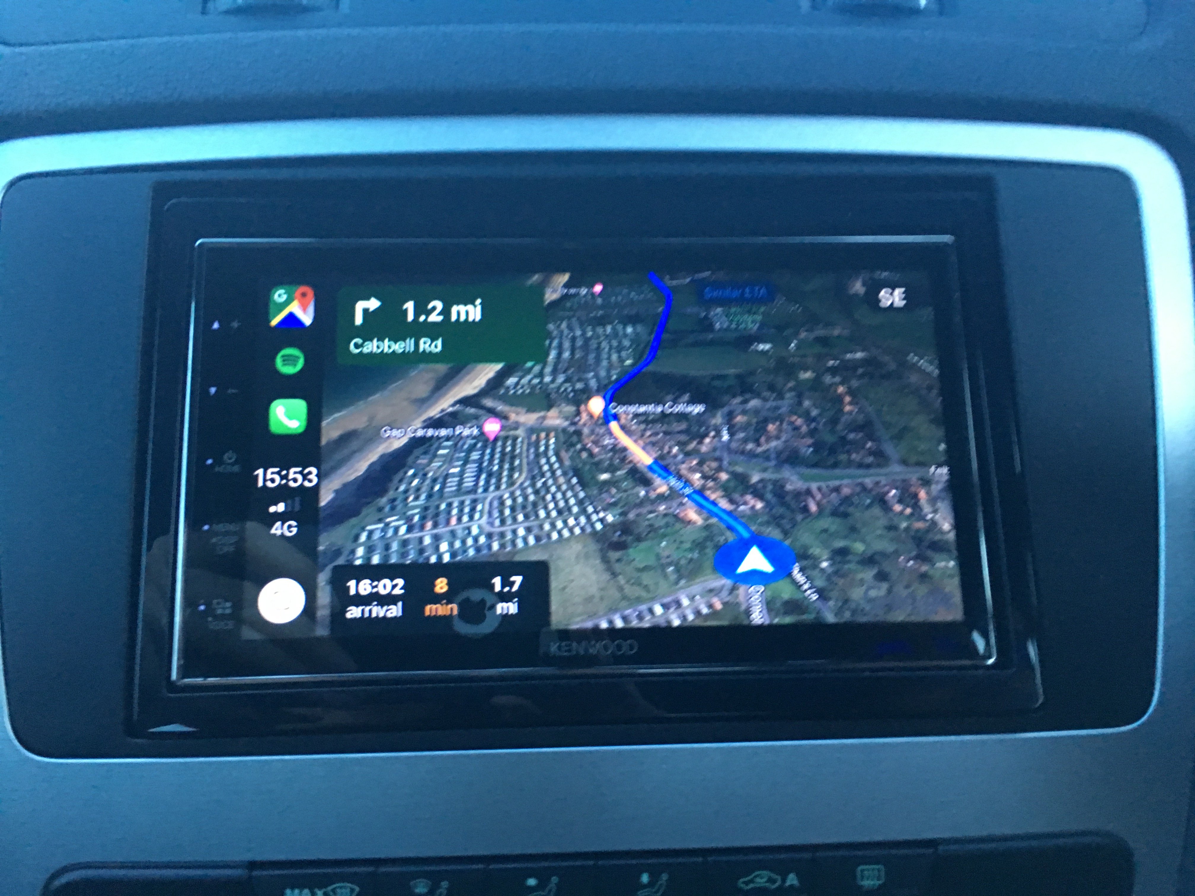

Don’t rule out a completely new head unit. I used to have the same as unit you, but couldn’t put up with no Bluetooth. I got a new double DIN head unit with Bluetooth, apple car play and DAB for around the £400 mark and I haven’t looked back, so much better, phone plugs in and I can call, text (via Siri), listen to Spotify and have navigation via google maps with satellite overlay, looks really good, even my wife was impressed.
I didn’t know you could get a surround to fit the gap in having a double DIN,
so many ideas. Glad I asked here. The lack of Bluetooth is a bit of a pain but I’ve bever had it before it’s not till I borrowed my Dads posh car I realised what I was missing!
