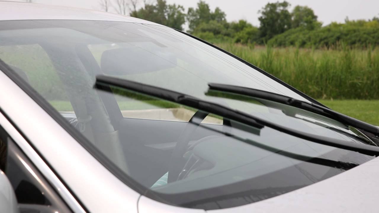

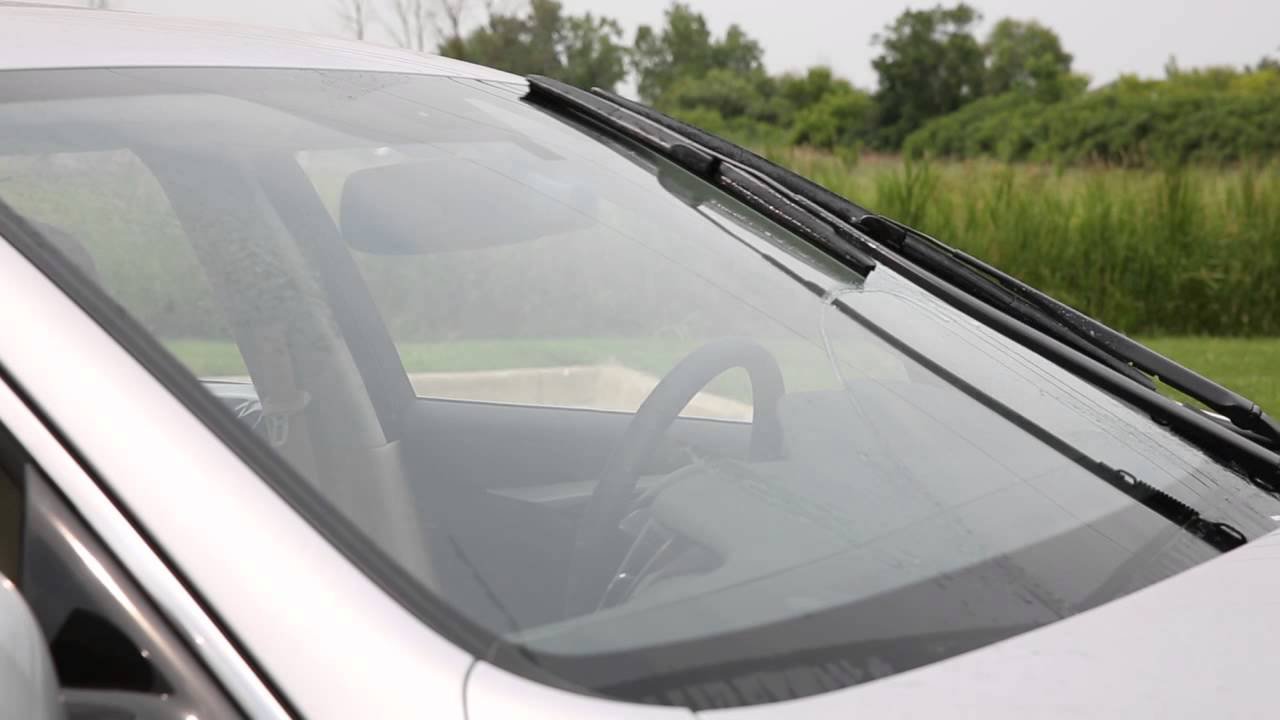

Just to be clear, your use of the word "mid-sweep".
Do you mean halfway up the windscreen, like this...
Or are they indeed in the 'service position'?
Hi
Yes, they are in the "Service" position.
