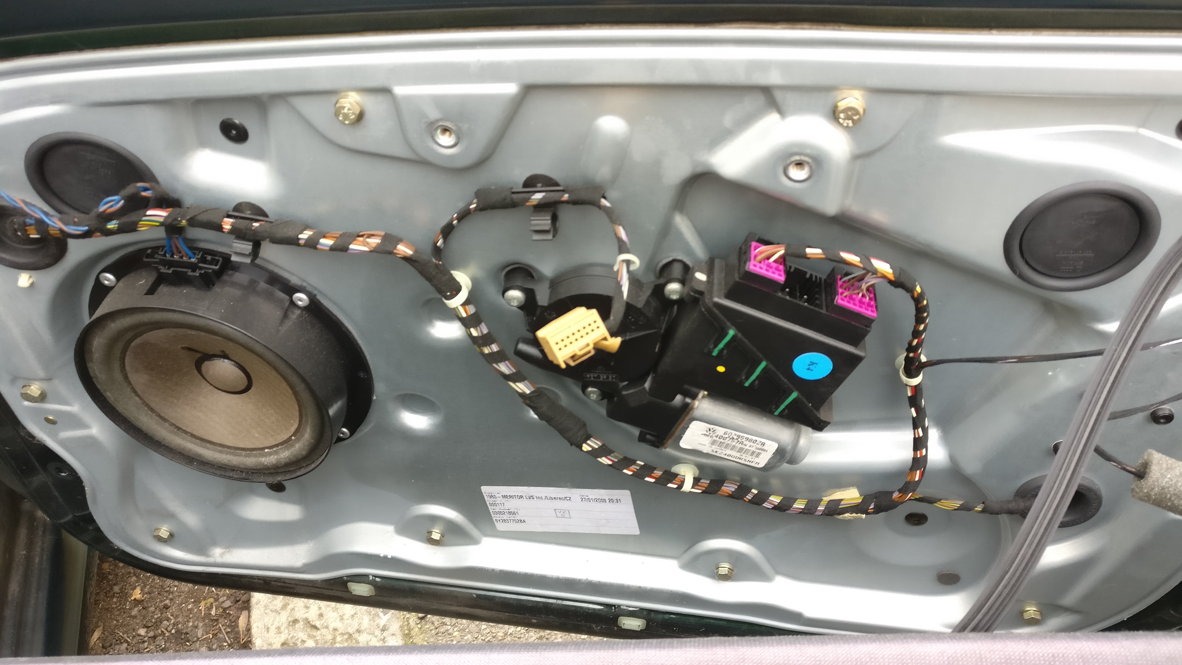

Sorry I'm a little confused. Here's a picture with the door card off. Do I need to remove those bolts and take off that metal panel?
Yes, since it's bolted you should be able to see the wire going to the lock mechanism if you remove all the bolts and take a peek behind it.
Sorry for asking so many questions but is the metal piece supposed to come all the way out? I've unbolted them and pried it off slightly around all the edges.
Also, where would the lock mechanism be? I'm currently having the most luck prying from the bottom right of the panel.
That metal plate is holding the window which is why it's called the window carrier so if the window is wound up then it will barely move, the lock is right where you'd expect it to be, you can actually see it bolted to the door shut below the pop-up button.

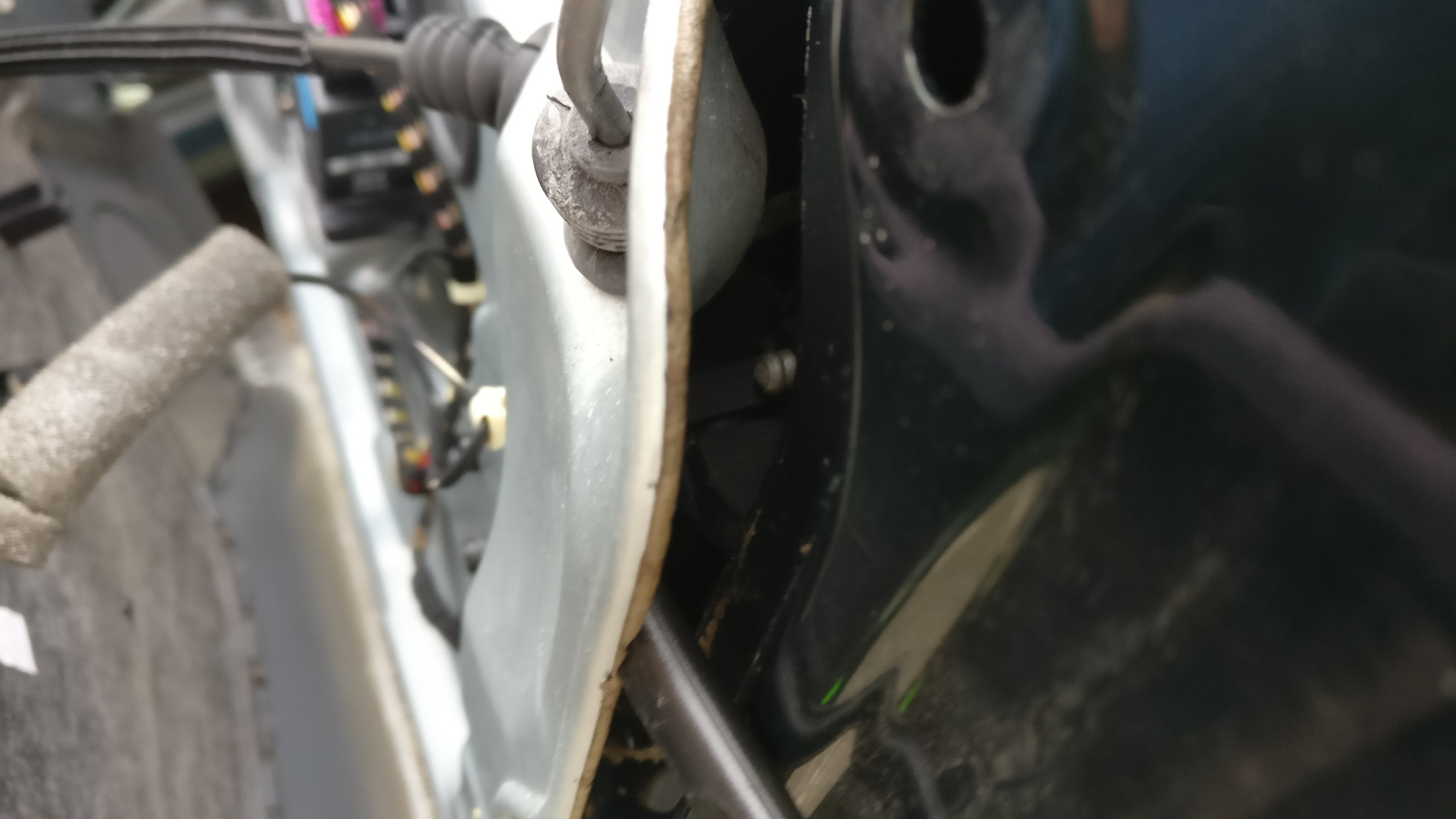

With the window rolled down I can get an inch or two of clearance but I can't see much. Here's a picture of what I see.
Yes, that's not very helpful, I think you should probably abandon mission and put up with it for now, I think replacing the door lock will be almost impossible for you and refitting the plug if it's been disconnected is also extremely difficult because access is so poor.
I'm surprised that the garage who disabled the lock didn't do it the easy way by cutting the loom somewhere obvious and easy to get at.
To me, this seems to be a curious feature for a previous owner to request that a garage disable foe them, on the other hand, if there was a wiring failure to the driver's door lock or another failure in the driver's door lock module, it might make some sense to a seller to make up that story.
