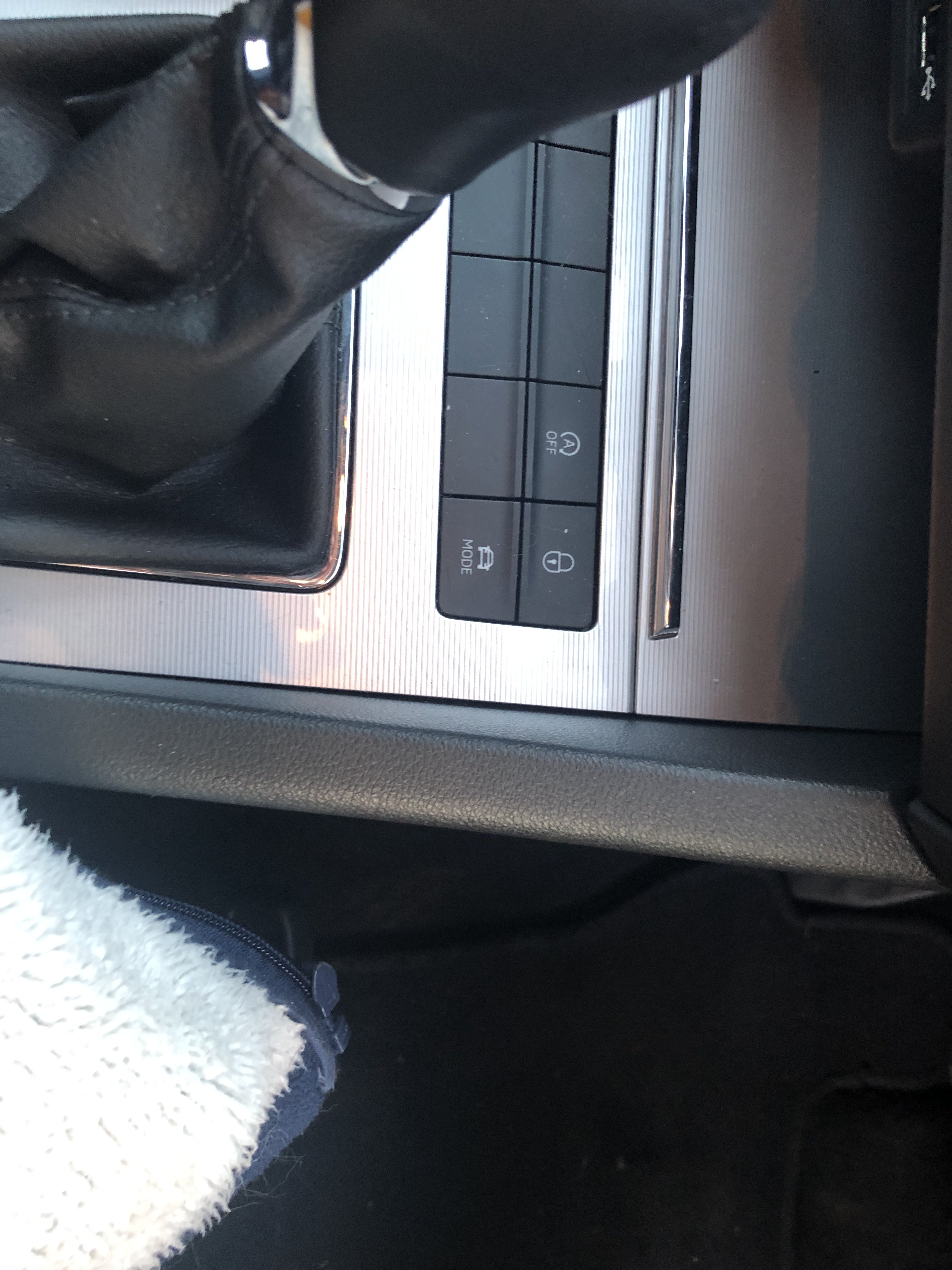

16 minutes ago, Mee said:
I have no idea, it’s a SE L, would it’ve Come with this?
If you have it then it's one of the buttons directly in front of the gear stick (along with the lock/unlock button)
2 hours ago, Gabbo said:
Were your previous cars diesel as well ?
( At least) one of them was a turbo diesel, I honestly can’t remember if others were.
My last car a Mini Cooper convertible with it’s hideously small boot was definitely a diesel and never once had this problem?
could it’ve been to do with the tyres at all? They were mismatched front and back and the tread depth was also mismatched front and back. Reason I ask is they’re all off now and I haven’t yet noticed it doing it
I’ll have a look when I have to pop out later, I know that there’s 3 buttons down there, I’d assumed that the other one was traction control
You should have 4, one traction control, one lock/unlock, one for the auto start, and one for the mode.
Nope, just the three
No esp button on the other side of the gear-lever? Either way, set that mode button to normal or individual with the engine in Sport to get the best out of it.
That mode button is for the normal/eco/sport modes. Try a different one to see if it helps.
For the record, mine has only 3 buttons (no traction control)

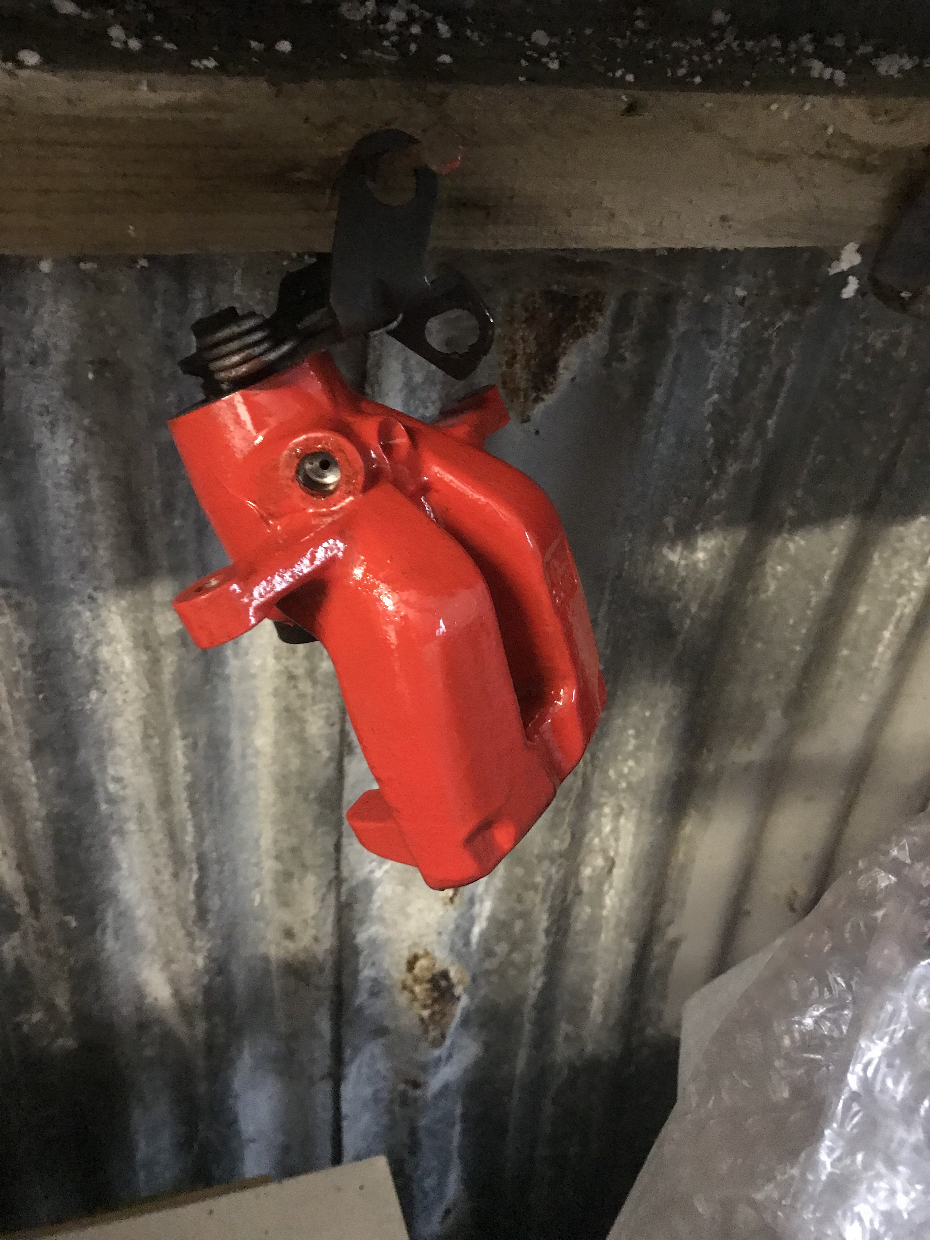

To add, are the brakes (pads and discs) able to be DIYed? Or are they full of sensors as well?
that’s the next thing on my list to do
There should be a wear sensor but that’s only a plug. Nothing serious for a DIYer to do. I’ve been busy getting some Audi S3 310mm rear callipers sorted for my car and I hope to get them on over the weekend. I wanted to film the process but my phone shots weren’t good enough (left it in 4K but 30 fps so it won’t time lapse properly) and my new GoPro isn’t coming until Monday so pics will have to do. I’ll have a nice pair of red 272mm rear callipers going if the 1.6 ones are smaller haha
Thats the button, so press mode till you Sport and see how you get on, I stall mine far less when it's in sport.
