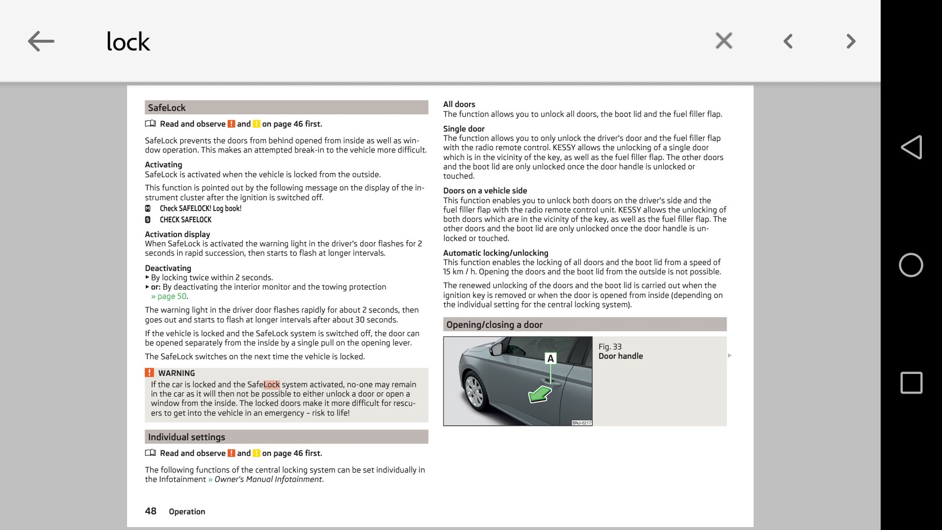

If I recall correctly, this feature is selectable in the infotainment system...
I have read that too, but still think it needs to be activated at dealer first?
Read this under individual settings... It looks like it is standard since it is in the user manual...Screenshot_20190221-114305.thumb.jpg.dece49fe671f19c1f1394a7f03595bc8.jpg

On my old 2007 Roomster I had to do auto lock/unlock and also single key press all door opening using VCDS. But on my 2016 Yeti both the above are on the maxidot infotainment menu.
I had to turn on Staging (celebration) though using VCDS on the Yeti.
This is what i thought, even though its in the infotainment system, it still needs activating via carista / vcds

Oh Ok, my Yeti was already set to auto lock/unlock and single press all doors unlock when I brought it last month. So I haven't tried changing it. But maybe my vehicle was activated there by the last owner if that's the case.
I'm sure on the 2015 Polo, the selective unlocking is changeable via the infotainment system but "anti carjacking" - ie auto lock when moving at above 10KPH, I think is only enabled using the VAS tool or VCDS etc.

As @krigl post above - it looks like it's all in the Infotainment now.
