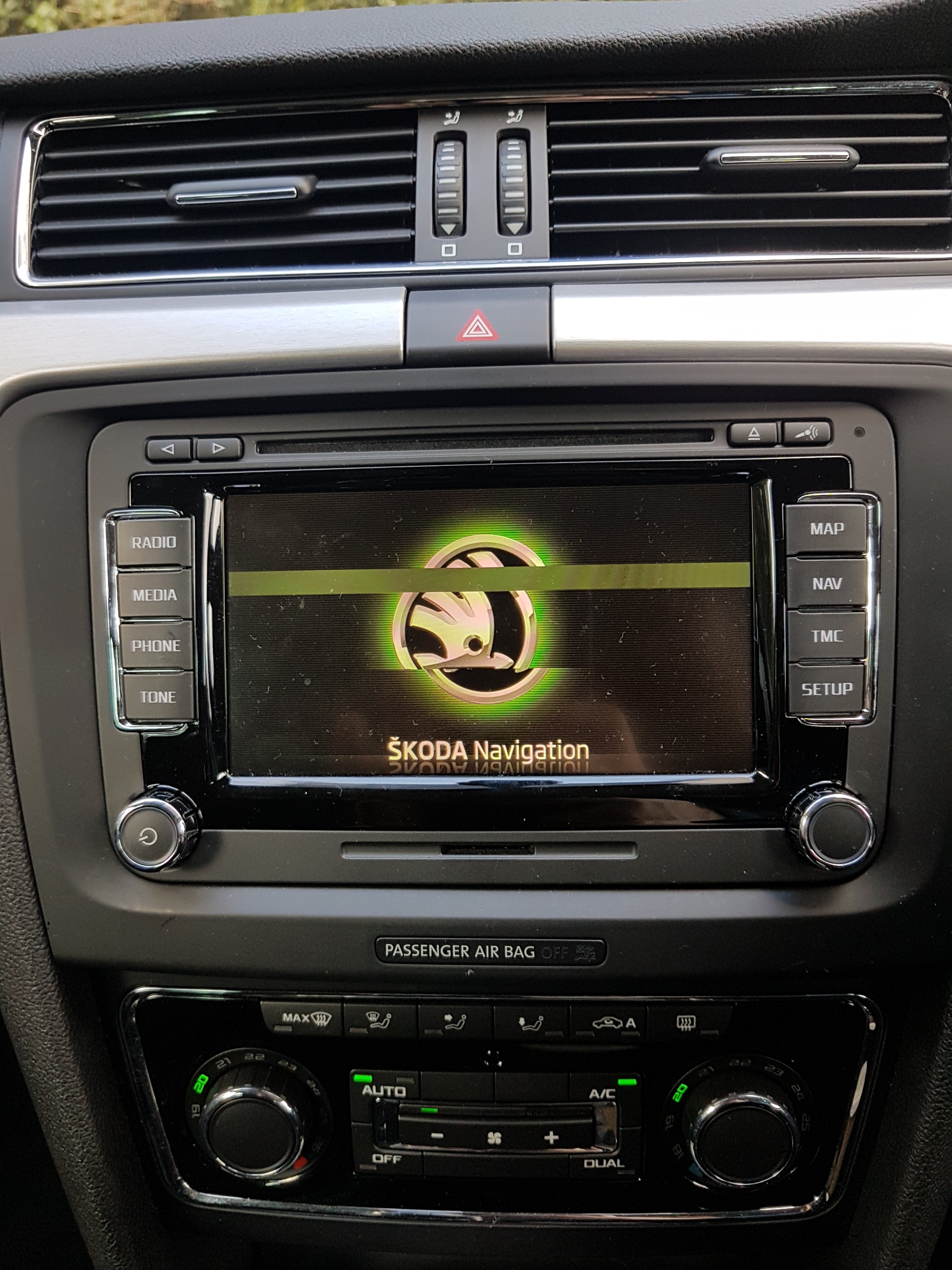

Hi all,
Does anyone know what causes this (see image) to happen on the sat nav/radio unit and how to resolve it?
All seems to work fine apart from the start up screen.
Cheers,
Steve
Just reflash it with the same (or higher) SW version and all will be fine
