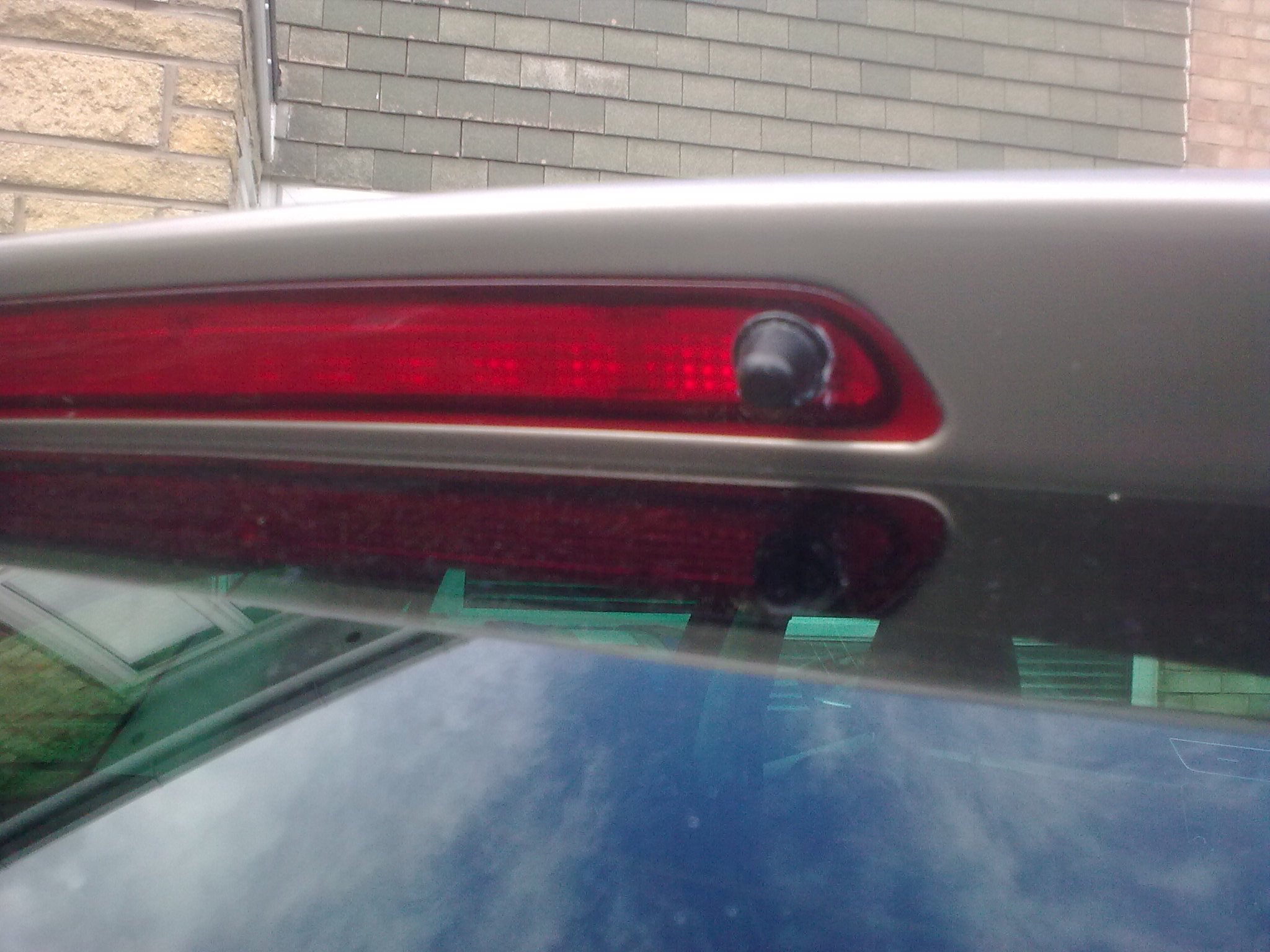

When I bought my Superb, one of the few things which annoyed me was the rear wiper/washer performance. I bought a cheap twin nozzle from Ebay, cut off the tube bit to leave just the head, drilled out the hole to enlarge it enough and stuck that over the existing nozzle (I used some caravan sealant/adhesive which I had handy). It's still not perfect but a vast improvement on the original.

It would have helped if the cheapskates had fitted two nozzles in the first place!
I might try that when my new car arrives. It’s not worth bothering with the current one for (hopefully) just a few weeks.
